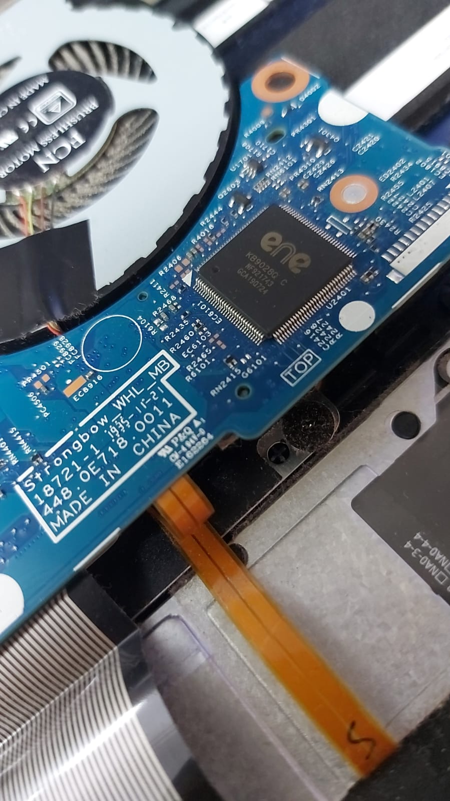

    hello guys, my laptop stuck black screen at power on. this caused by bios version downgrade. laptop works well with 1.14 ver bios. but cpu stucked at 399mhz, then i downgrade it from official 1.06 version with using acer official bios by modifying platform.ini files flags. then computer rebooted and bios flashed on post screen with succeed then re reboot and stuck at black screen.
    i tried to re-program bios chip from *.fd bios file with CH341 programmer but i can not succeed.
    please guide me how to fix that

            i tried these 2 bios but nothing happened. its still stuck at black screen.
            i attached my dumped bios after bricked. btw my working system also have a bios password. i dont know does it important to say? this should be 1.06 version
            i dont have working backup.

              Posted files are extracted from official update with clean ME, PMC etc etc, they must work. Try flashing the ENE chip.

                i tried to flash ene too but nothing changed
                btw its ENE KB9028Q
                anything to do you can guide me?

                  Check for bad soldering, change bios chip, change that crappy cheap programmer...

                    Hello sir, may i know how this EC being flash and is this on bios chip? or on sio?
                    if i have my orig bin file, how can i integrate this EC?

                      in this case the EC bios is on the SIO chip...and it is written with a programmer for SIO chips..vertyanov, svod, etc...search for more details on the net..
