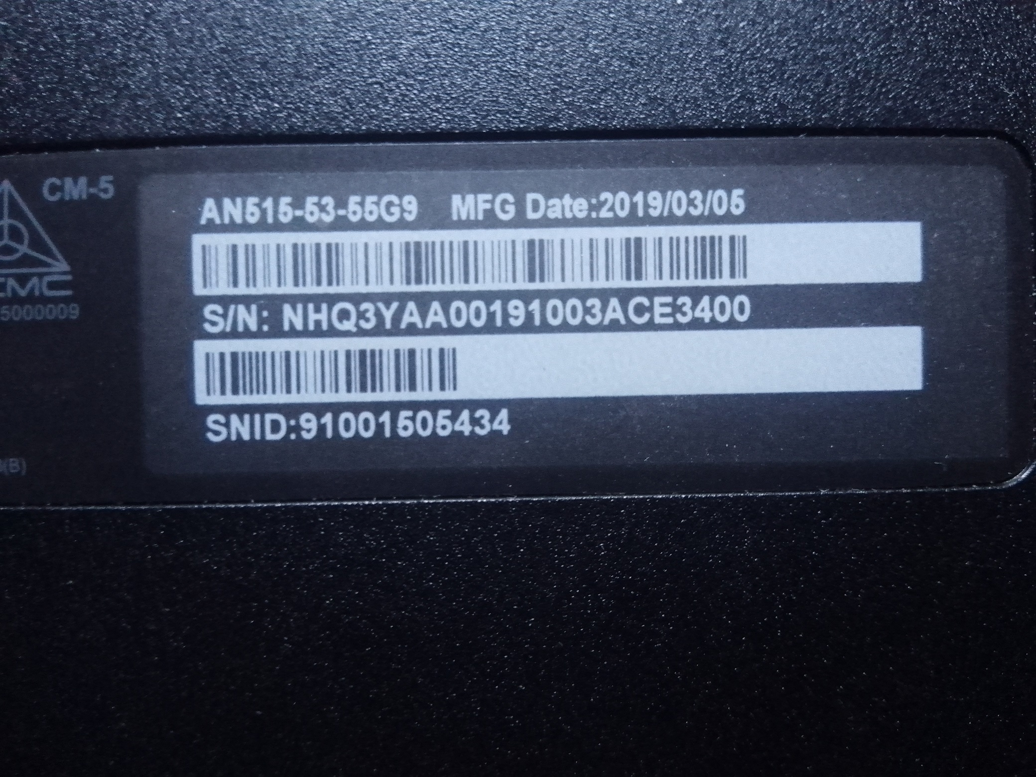

      Acer Nitro An515-53-55g9 Bios DH5VF LA-F952P Rev 1.0N
      Hi, need bios for Acer Nitro An515-53-55g9 Bios DH5VF LA-F952P Rev 1.0 N
      Original bios with no display Attached
      Thanks in advance!

        laptop serial number ?

          Re: Acer Nitro An515-53-55g9 Bios DH5VF LA-F952P Rev 1.0N
          S/N NHQ3YAA00191003ACE3400
          Thank you
          • hardware1
            • Sep 2021
            • 2948
            • N/A
            Thank you
            One of those should works, it's a virgin bios image from Acer with your DMI.
              Thank you very much, I will try and comment.
                • 21984
                It should be the 2nd one, the motherboard is Rev 1.0 DH53F_10
