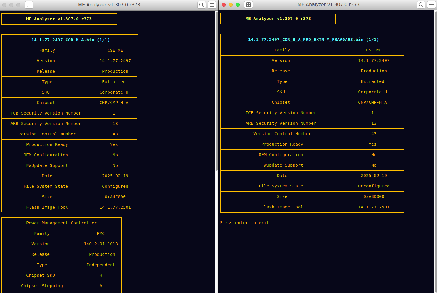

                                  Hello Markus, first of all.........thank you verry much for the fast help.
                                  I like to ask you a question, and I hope you could help me also with that
                                  Before I asked to clean the ME, I did this my self, but the laptop whas looping, so turning of, and on.
                                  I checked both our files, so your outimage with mine outimage in ME analyezer, and the only difference I see that is that we used a different Flash image tool version. I used the one as shown in the original file.
                                  But, with your file the laptop works good, so I like to understand for myself what I need to do different.
                                  I send you the outimage I had, and on the picture you can see on the left site your file of ME analyzer, and on the right site it's from my outimage file, and also I send the file I used to clean the ME region.
                                  Greetings Rob

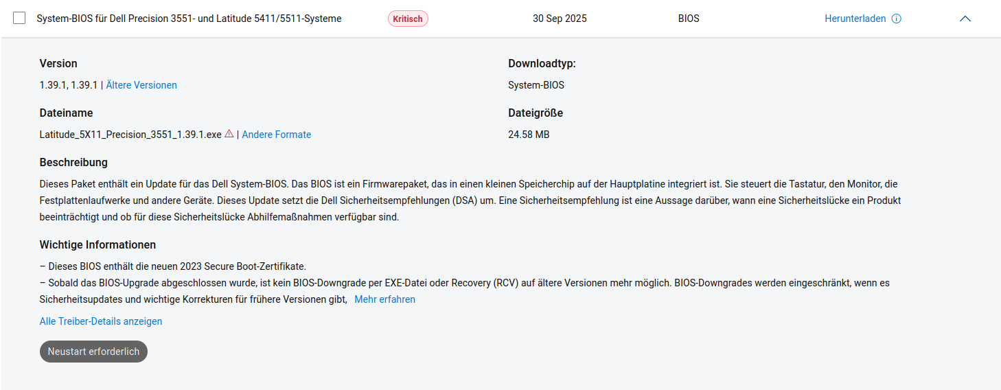

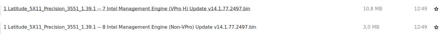

                                    The only difference I see is that we used different ME region versions for the cleanup.
                                    Since I didn't have version 14.1.77.2497 Corporate H myself, I extracted the version I was using from the Dell BIOS.exe.
                                    Using your service tag, it's easy to find and download the exact BIOS version.

                                      That's seems to be the part where it goes wrong when I tried to clear me, because the files are different. I stil need to learn how to extract BIOS.exe files to get different bios files, and Me regions.
                                      Do you know if there is a complete instruction on how to extract BIOS.exe files on Badcaps? I can't find it.
