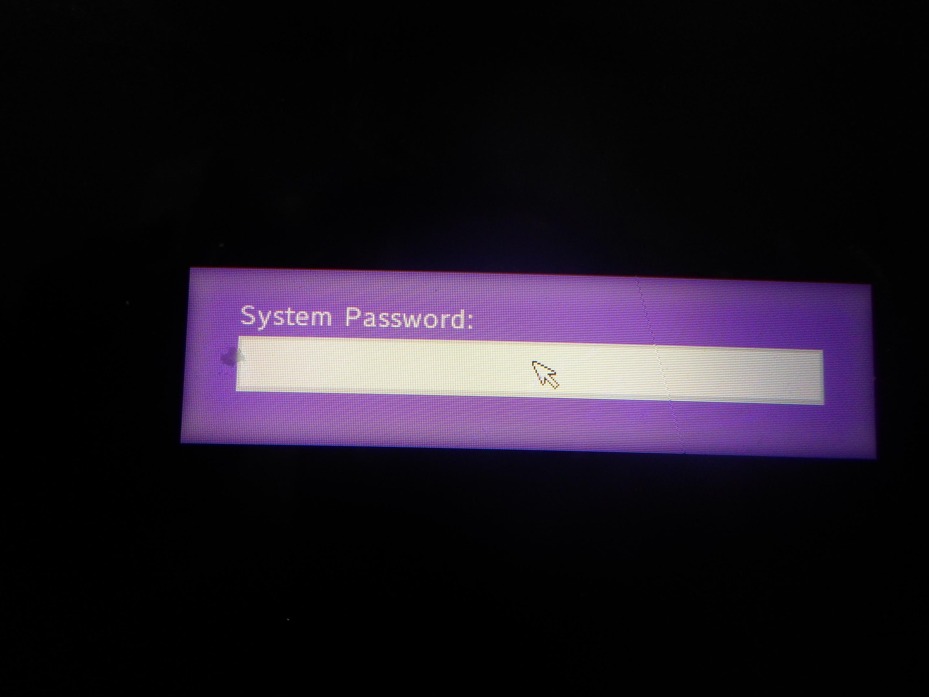

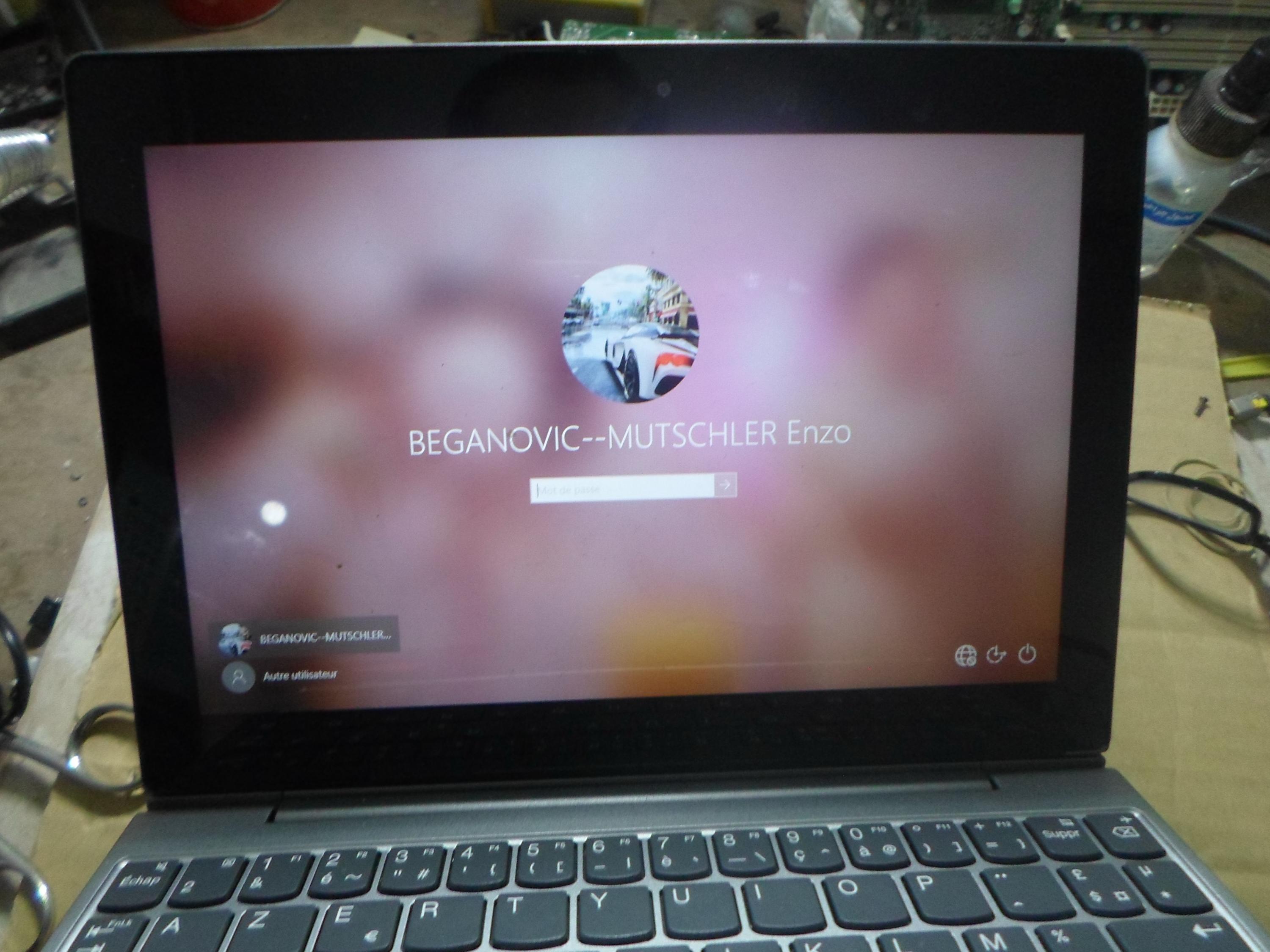

    halo all
    i have a LENOVO Ideapad D330-10IGM coming with password in bios and administrateur .
    i can't flash it and i have no idea to enter to install another windows
    please help

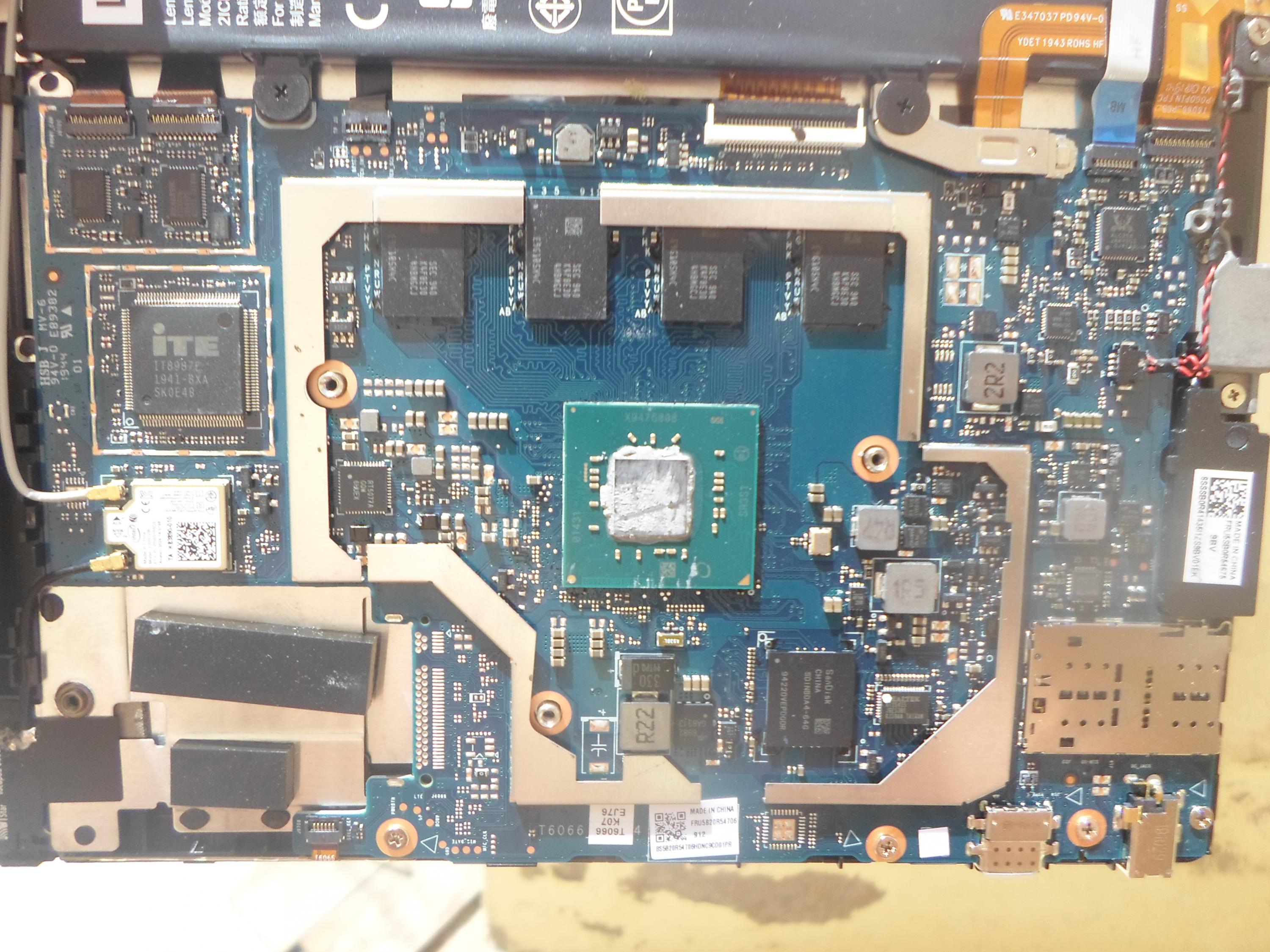

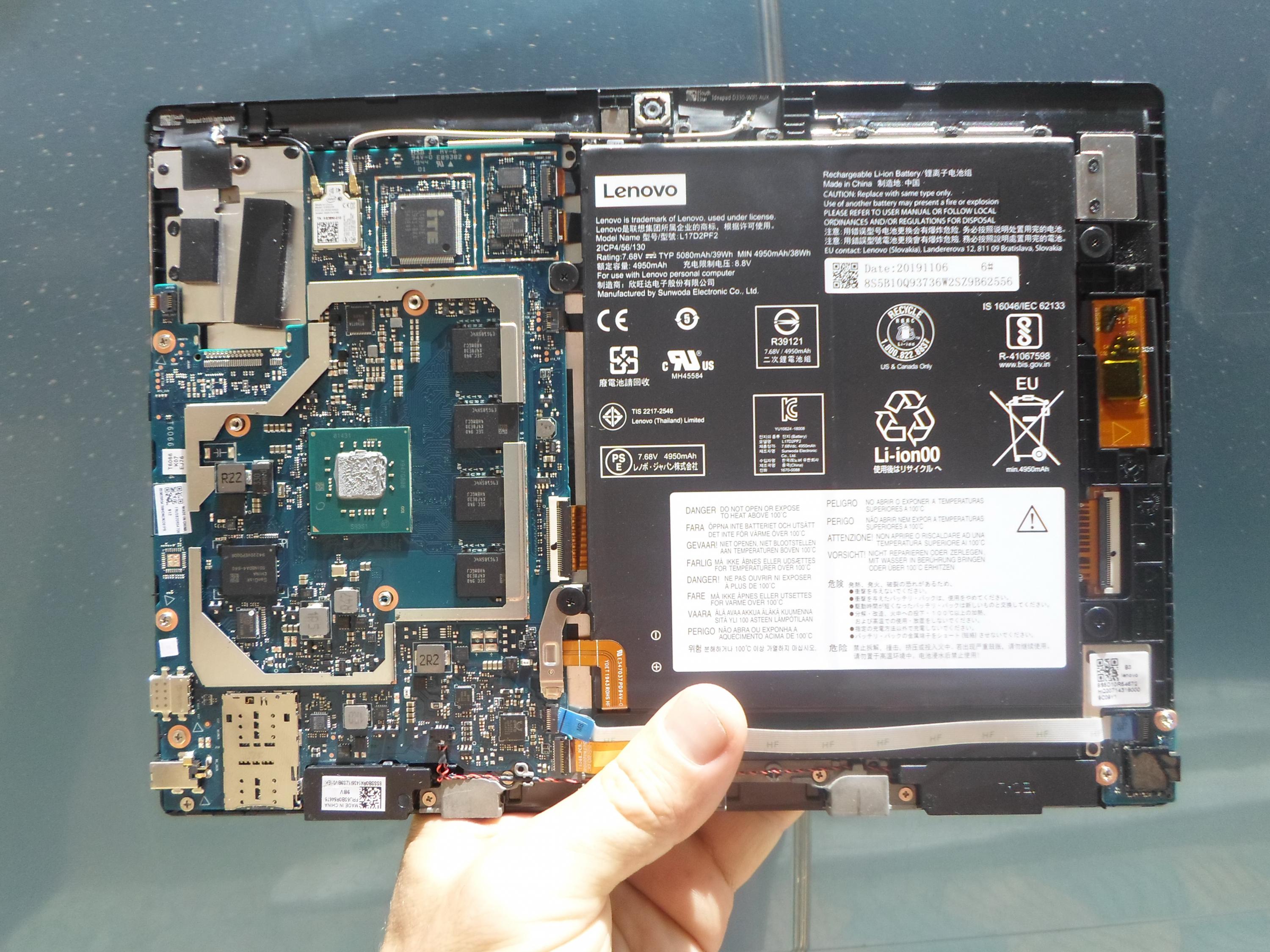

        Re: PASSWORD in LENOVO Ideapad D330-10IGM
        Take a clear picture of both sides of the motherboard and upload it here.
        ​https://www.badcaps.net/donate
        • kadi144
          • Aug 2015
          • 690
          • algerie

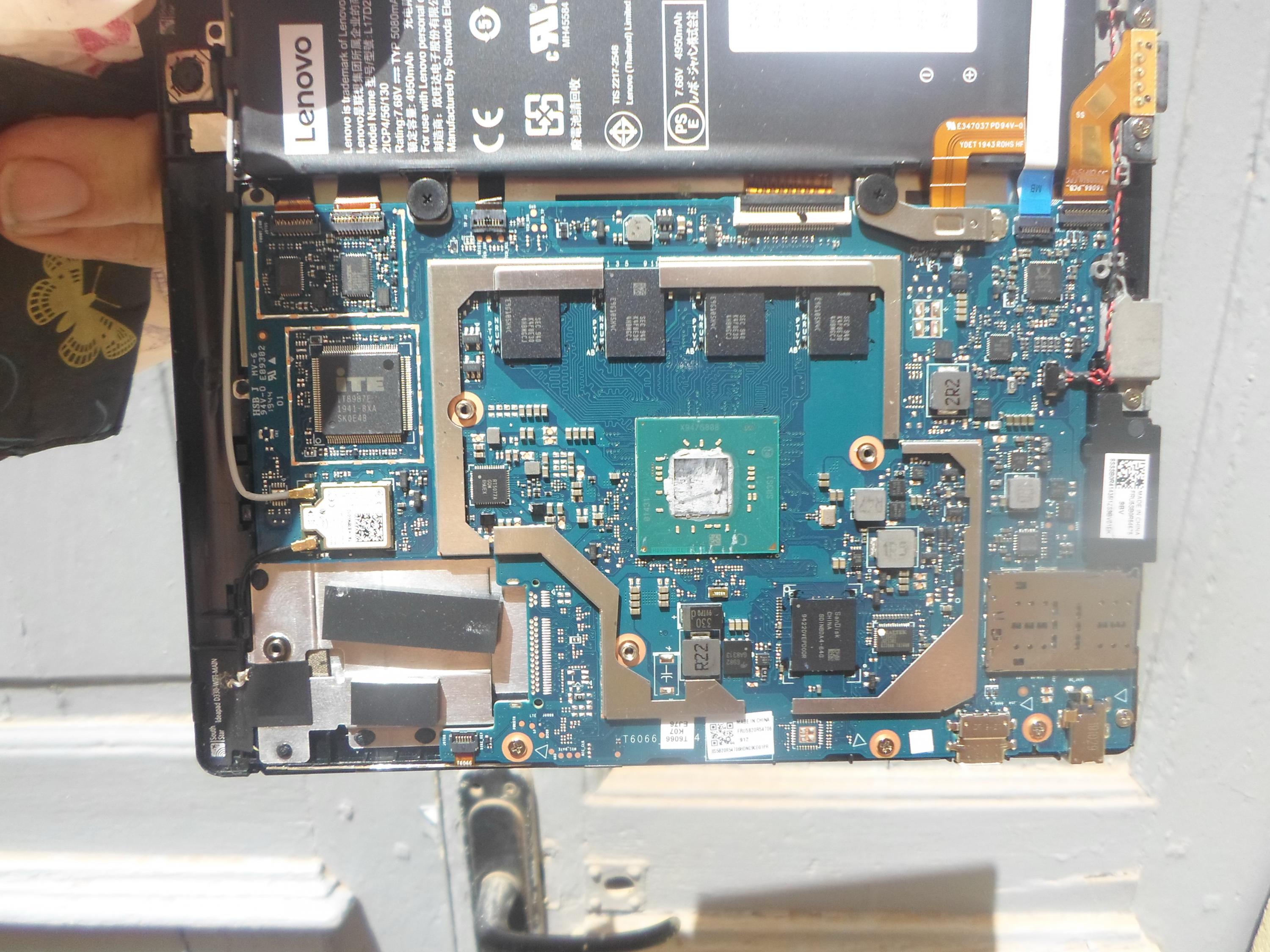

          Here is there are only this face
            • 22275
            There is one large chip on the other side of the board,it might be that.
              here is
              pls where is the ic bios chip؟
              • hoaca388
                Badcaps
                • Jan 2022
                • 12438
                Originally posted by kadi144
                here is
                Show other side of the board.

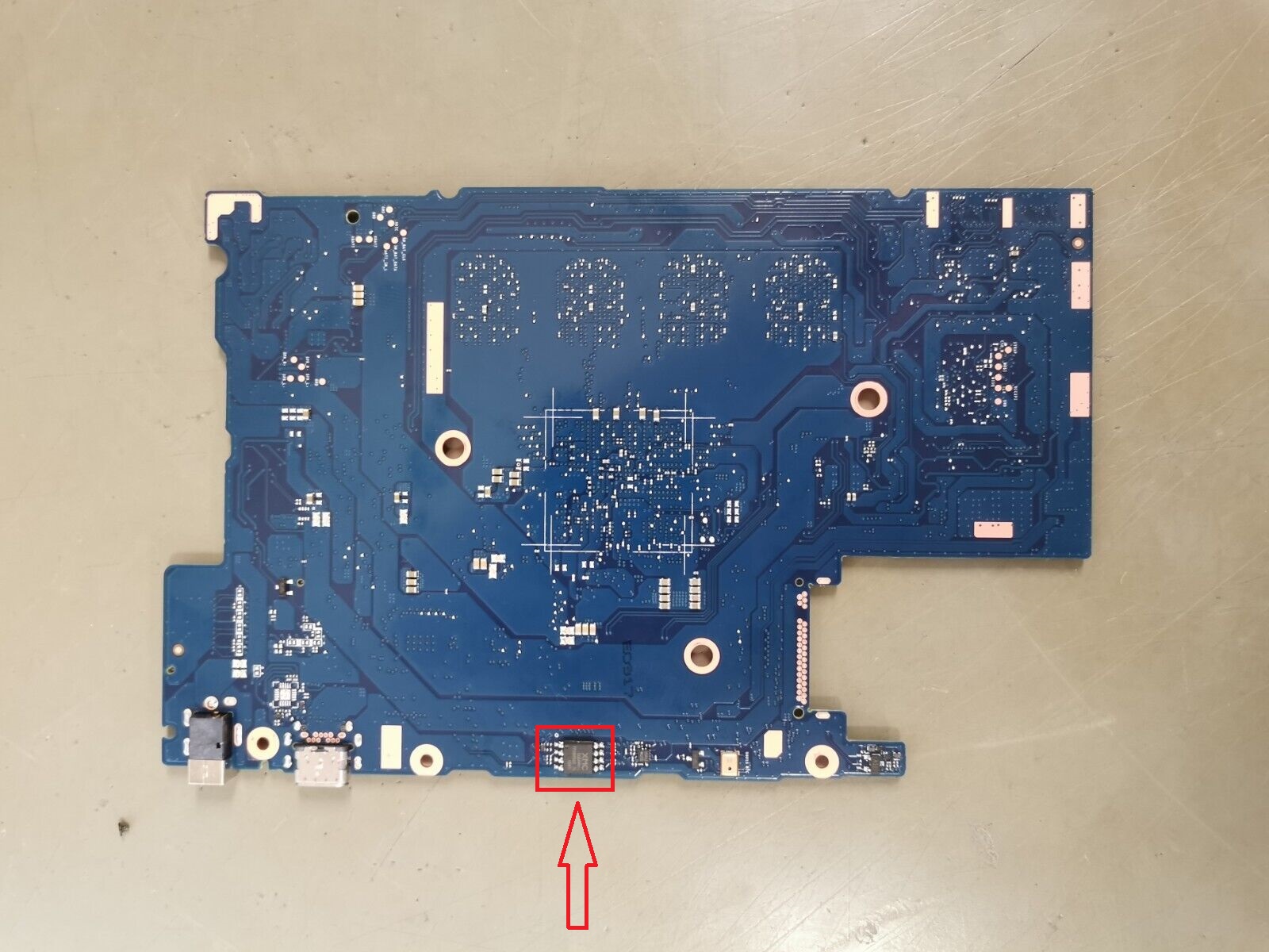

                  • kadi144
                    • Aug 2015
                    • 690
                    • algerie
                    a little english
                    i have found it
                    and i need a working bios please

                      and now ... if you found the chip post the content ..

                        Upload the dump from the chip little english.
                        How many times we have to tell you to do that?
