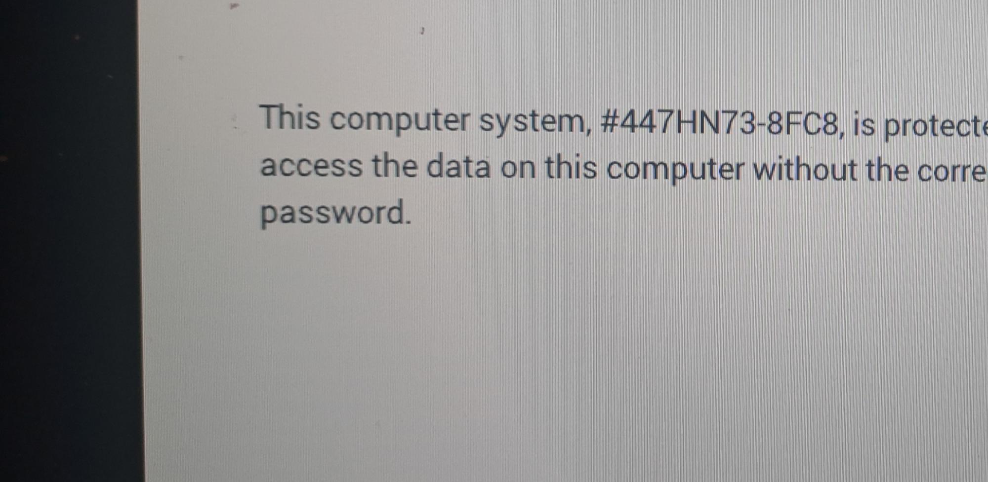

    can someone help me for this dell bios code please : BRXMP73-8FC8
    Last edited by SMDFlea; 06-06-2022, 05:37 AM. Reason: Dell Precision 5550 password
    • 21853
    Re: Dell Precision 5550 password help please
    There is no free generator at the moment for the 8FC8 suffix so post your backup .

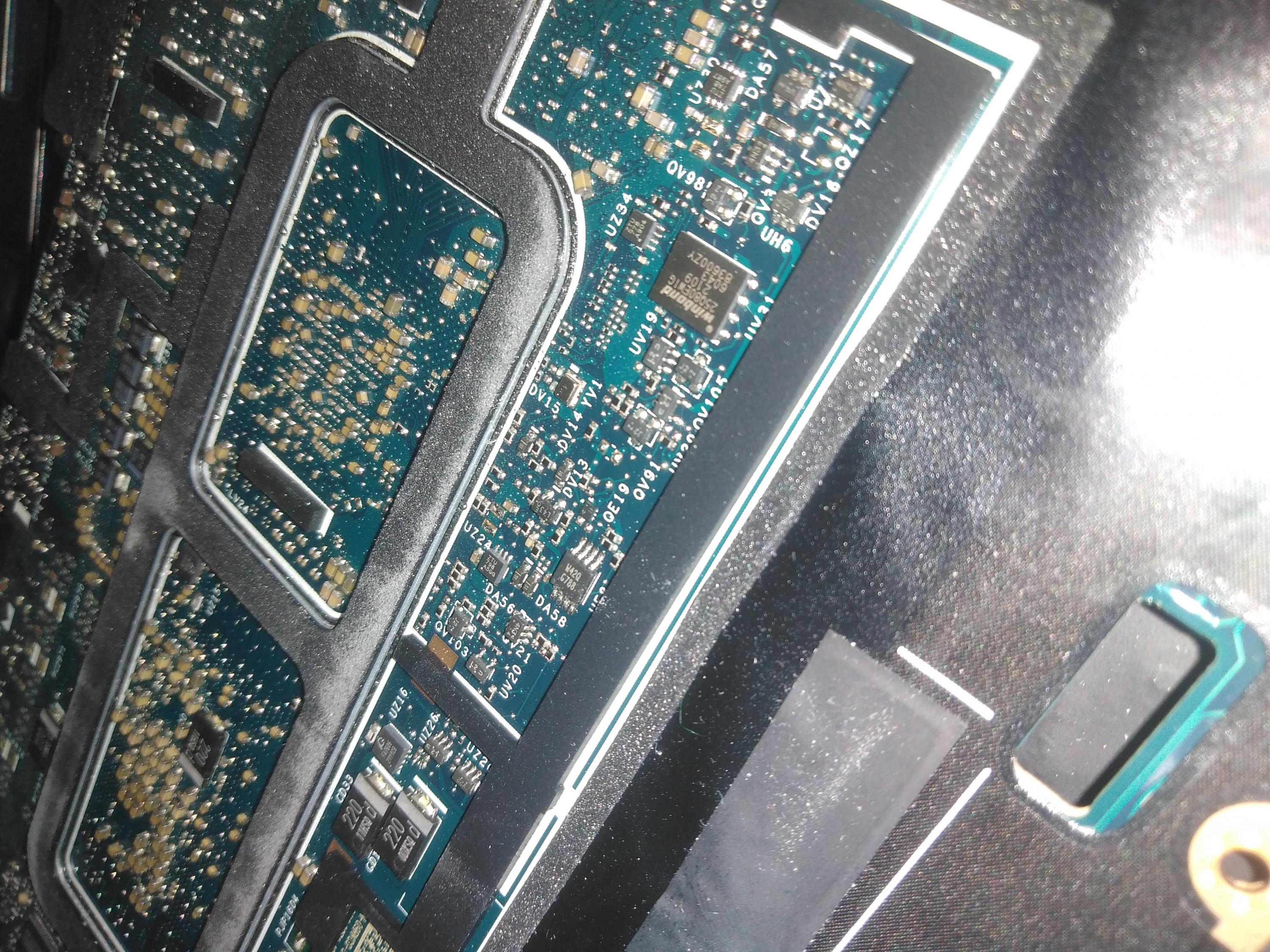

                    is this is the main bios
                    • volinakis
                      • Jan 2021
                      • 2874
                      • N/A
                      the other one

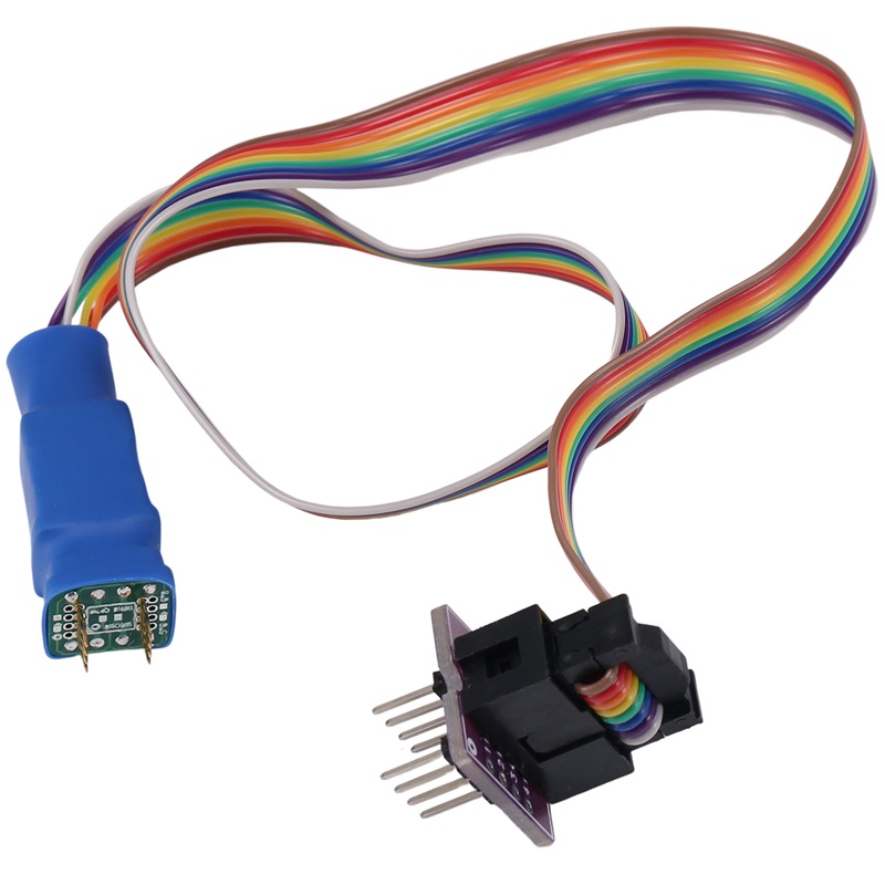

                            please can you show me the good socket for program it
                            • hoaca388
                              Badcaps
                              • Jan 2022
                              • 12322
                              Here
                              ​https://www.badcaps.net/donate

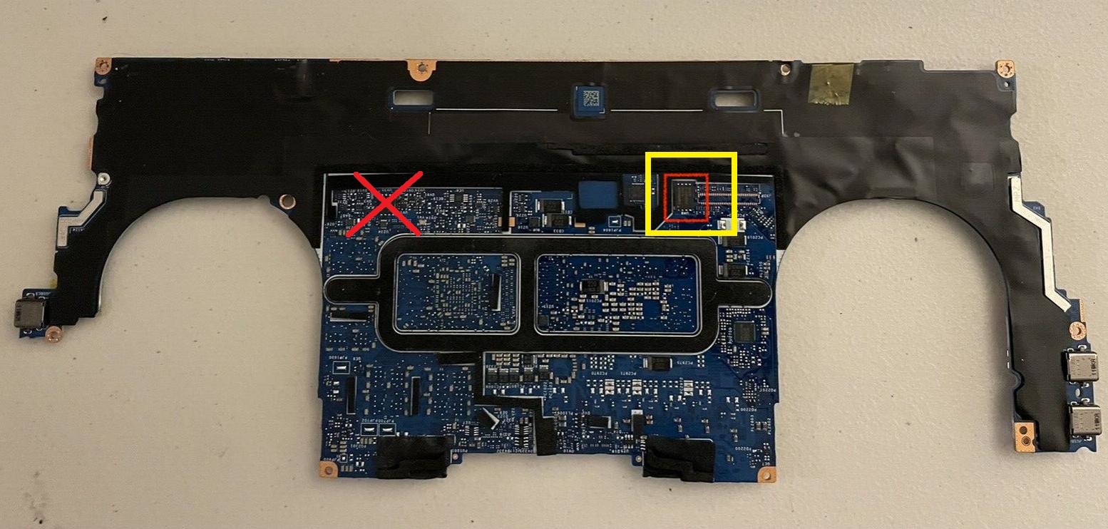

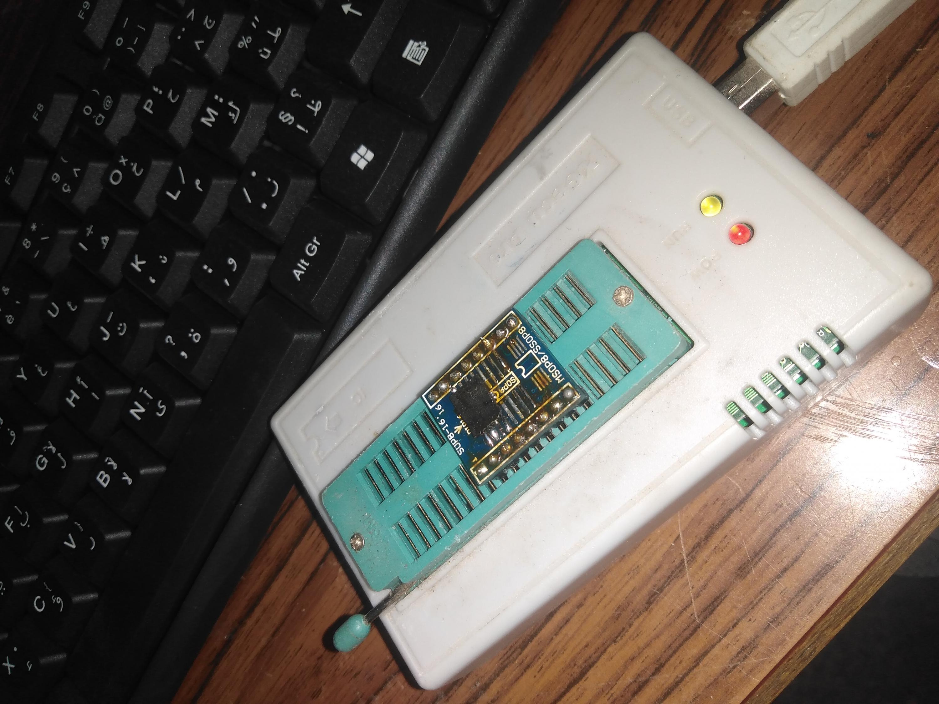

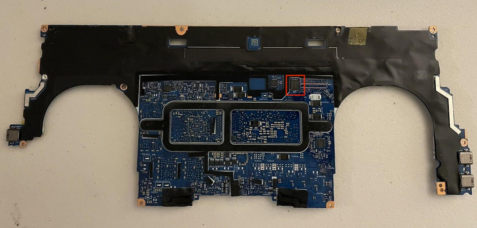

                                i dont have this one
                                i tried this method but no result
                                • volinakis
                                  • Jan 2021
                                  • 2874
                                  • N/A
                                  Are you sure you put the adapter in right place? From what i know pin 1 for TL866 is up left, not in the middle.
