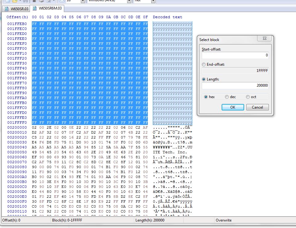

clevo 6-71-w6500-do3 bios needed
05-25-2022, 07:56 AM
they put password on file that was awailable
SMDFlea
Join Date:
Jan 2018
Posts:
16146
Country:
UK
05-25-2022, 07:58 AM
Re: clevo 6-71-w6500-do3 bios needed
Originally posted by
ktmmotocross
View Post
Available at the palkeo repo .
LOG IN WITH
Username: repo
Password: repo
Cut 2MB (length in hex two hundred thousand) from the 6MB bios with a hex editor,paste-insert into a new file,save both files.
