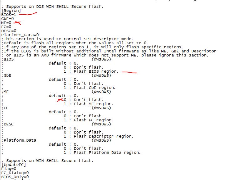

        Question cause it was dumped with 33ww version and i did bios update after messing with ME region. Didnt the fact that i updated the bios via lenovo thingy already cleaned it? It also did EC update. I did rollback to 33WW it did EC again but problem stays the same.
        Will try your creation. Just for the sake of it. Next is replace EC again.

          The updater will only flash the ME firmware or other parts of the bios image if the flags are set to a 1 in the platform.ini file

            oh thx will try it with flags first cause im lazy with sotering

                Well messing in ini didnt help. It still looked like it just skipped some stuff.
                Will use progremmer with your creation
                If that does not help then new EC. After that whats left is checking all lines. Cause this is fooked up ;o
