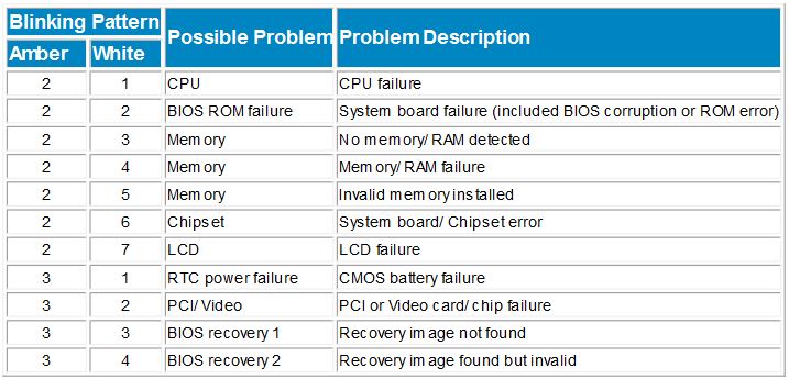

      Do you have any light blink indication
      • motanya
        • Nov 2021
        • 160
        • Kenya
        Re: latitude 7410 bios.
        Yes, 5 white 2 amber
        • qayyum786
          • Aug 2018
          • 1933
          • INDIA
          5 white 2 amber belong to ram memory issue
          • motanya
            • Nov 2021
            • 160
            • Kenya
            The memory of this laptop is soldered to the board, does it mean one of the chips is dead or ram power controller could be the issue.
            • qayyum786
              • Aug 2018
              • 1933
              • INDIA
              yes according to the dell light blinking error code
              • qayyum786
                • Aug 2018
                • 1933
                • INDIA
                dont give up
                you may start a new thread in the Troubleshooting Laptops
                and get regard
                like ram voltage requirement its SDA SCL etc
