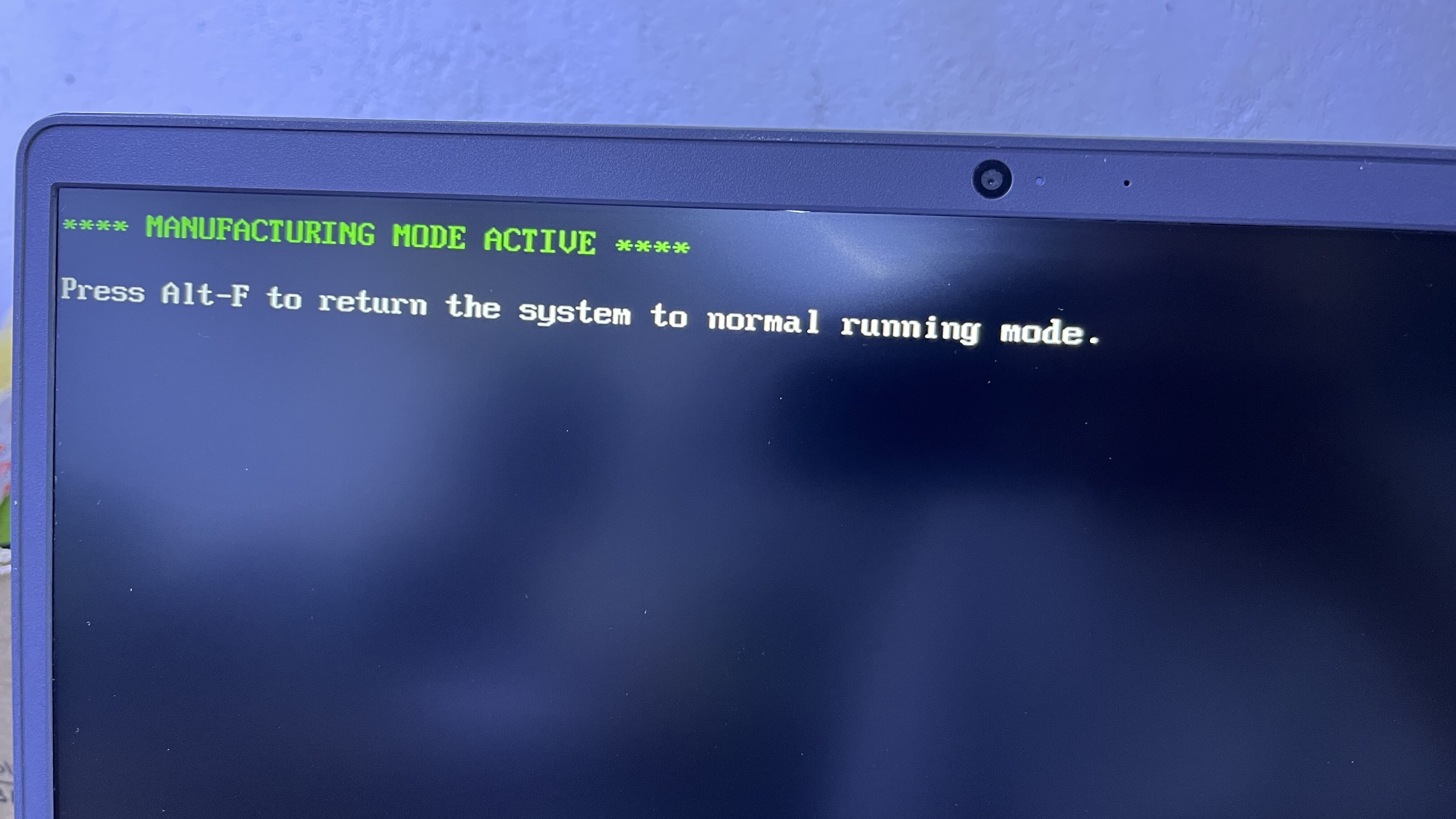

                  Model: Dell Inspiron 3501
                  Registered Model: P90F
                  Motherboard: GDI4A LA-K032P Rev: 1.0 (A00)
                  ST: 3R6XLB3
                  Would anyone be able to help me to find a fresh bios for the Dell Inspiron 3501.
                  The problem is someone else already tried to flash the bios (after a failed bios update through Windows) and it already has a different Service Tag. And I'm getting the MANUFACTURIN MODE error, TPM error, NVME SSD not detecting, and the cpu fan spinning fast issues.
                  post merged...next time look for a thread with the name and model, motherboard model of the laptop, and post there, if you can't find it, then make a new thread..

                        • wdcse
                          • Aug 2019
                          • 4
                          • Sri Lanka
                          #272
                          Originally posted by danito
                          Try
                          Thanks for that.
                          I tried it and it fixed several issues. I was able to inster original service tag. No more TPM error and the SSD is getting dettected.
                          But I cannot exit the Manufacturing mode. All I'm getting are beep tones. I checked the keyboard and Alt, F keys works fine.
                          Is there any sloution?
                          • bbanana
                            Father Land
                            • Oct 2021
                            • 164
                            • Vietnam
                            #273
                            Originally posted by wdcse
                            Thanks for that.
                            your orginal BIOS serviceTAG not like you posted 6Q4Z293
