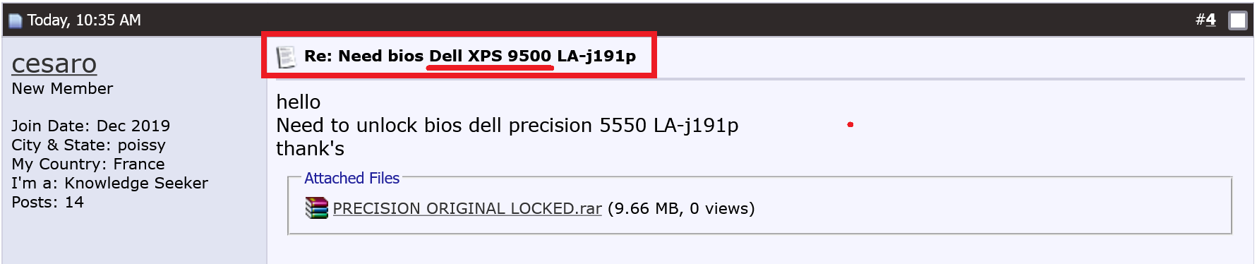

        Re: Need bios Dell XPS 9500 LA-j191p
        hello
        Need to unlock bios dell precision 5550 LA-j191p
        thank's

            Your request was posted in the wrong thread, so I had to move your post here.
