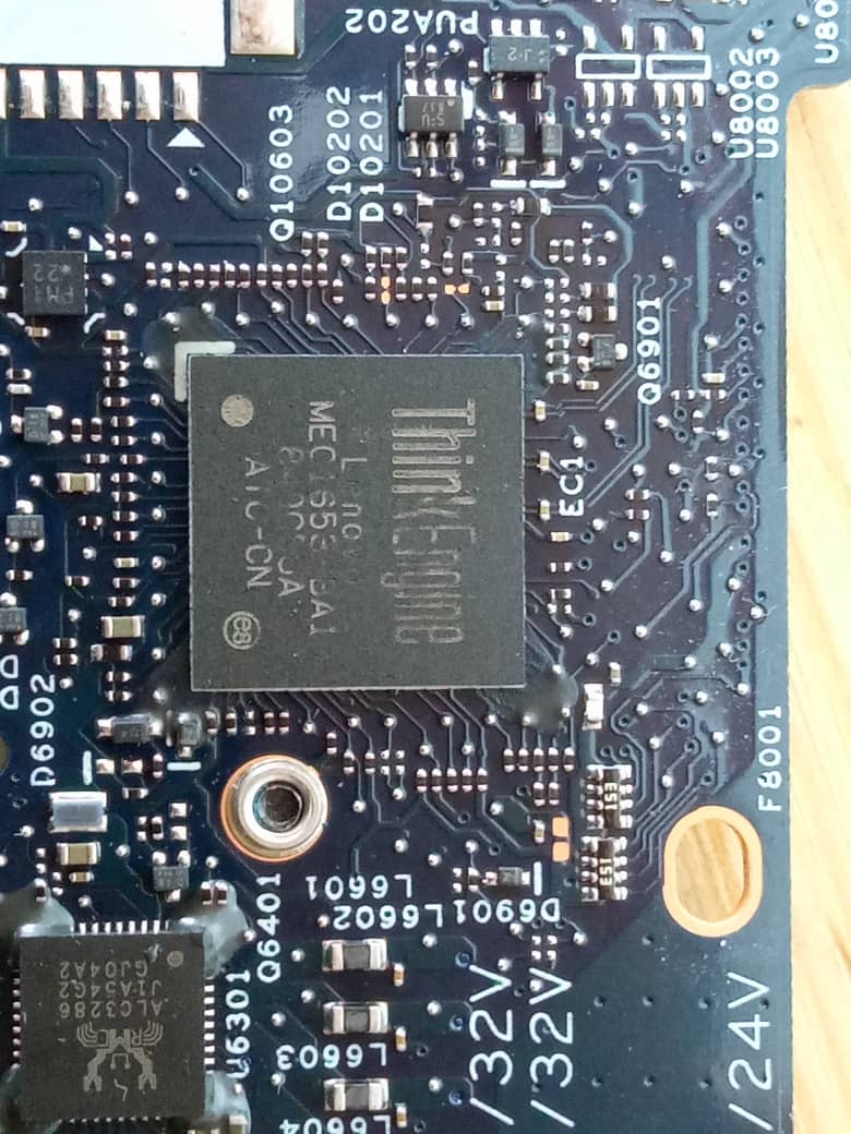

    thinkpad P1 need jtag
    please i need jtag enable
  • RethoricalCheese
    • Mar 2013
    • 1517
    • Estonia
    Re: thinkpad P1 need jtag
    Kind of looks like upper right corner of MEC. There is a resistor next to a capacitor. It needs to be turned 90 degrees and moved to pads just on top of it.
    Not 100% sure tho. Half of the picture is too dark to see anything.
