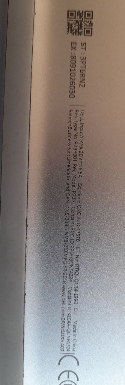

    i want Dell XPS 15 9575 2-in-1 LA-F211P rev 1.0 bios file. i made a backup of the old dump but got corruptd. i tried the one at this page but didnt work. i need help.

    post here your old bios backup & service tag number

        • 20914
        Re: Dell XPS 15 9575 2-in-1 LA-F211P rev 1.0
        Originally posted by jacospama
        Can you type out the service tag,it will save having to turn my head 90 degrees right,or downloading the picture and rotating it.

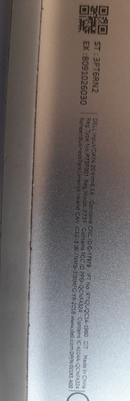

          am sorry but i dont know which one is the services tag, that was why i snaped the picture instead. but this is what i found. (P73F001)
            • 20914
            ST is the Service Tag: 3PT6RN2
            EX is the Express Service Code: 8091026030

              Thank you. thats what is at the back. thank you
