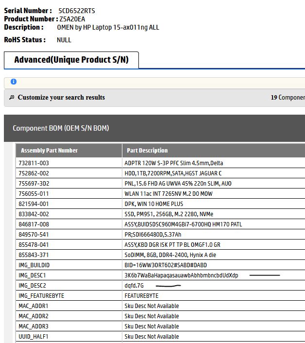

    I need help to extract the original uuid from bios.bin Backup file.
    The original bios was corrupted and i had to flash a new bios from hp offical site, but now im missing uuid and other stuff from the original one.
    Can someone help me please to extract these informations from the backup file and put it in the new one ?

    Post the full laptop model number,motherboard part number,and your original bios backup.

            Re: Hp_Omen 15-ax011ng DAG35AMB8E0 bios bin File UUID missing.
            I think your previous backup is corrupt.
            i edit manually your DMI & windows key, i combined with another working backup
                I can't find any DMI info from your previous backup, only win Key. Is there any error message on post startup ?
                  Try this bios. DMI added from your label foto.
                    You can find the Featurebyte at HP Parsurfer
                      Thanks SMDFlea. I added almoust all data exept macaddress.
                        thank you very much, bios is working fine, just the manufacturing mode was unkocked bu i already fixed it via Hp utility tool.
