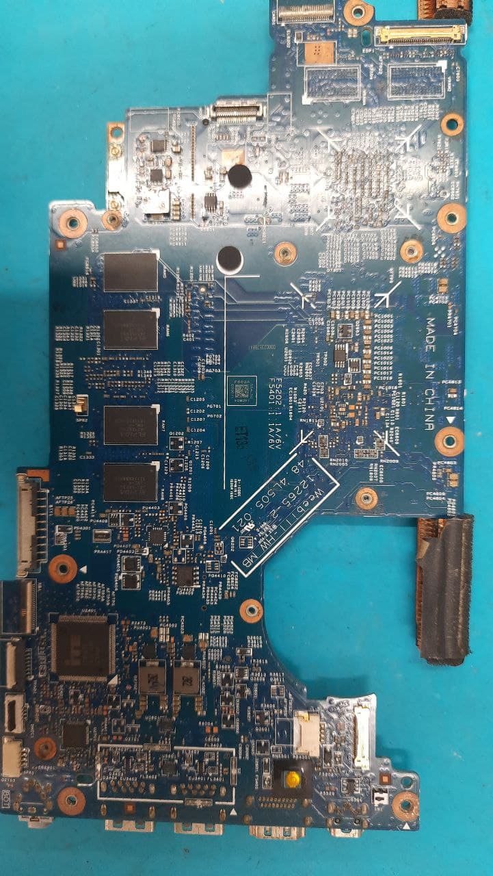

    Acer Aspire S3 MS2385 MB Part No. - Weebill - HW MB 12265-2 Taking only 200mA. On pressing power btn (pwr btn Voltage 3.3v) it takes 300mA and no response. So I am planning to flash the BIOS.
    post the backup copy of the original laptop bios

        bios extracted from the Lenovo site update
        DMI 421000 - 4210FF
        KEYWIN 422000 - 42203F

              Re: Acer Aspire S3 MS2385 BIOS Needed. MB Part No. - Weebill - HW MB 12265-2
              not working

                The bios at post #4 is a virgin one,extracted from the acer update and its ok. Try pressing the small switch in,its normally pressed in by the cover.
                  no response. I am getting LDO voltages 3.3v and 5v correctly. After pressing 3.3v and 5v on coils (look at the MB image, I am referring 2 coils near the ITE IO) comes and goes off.
                    Start a new thread in the laptop forum if you want more help as the bios is ok. https://www.badcaps.net/forum/forumdisplay.php?f=23
