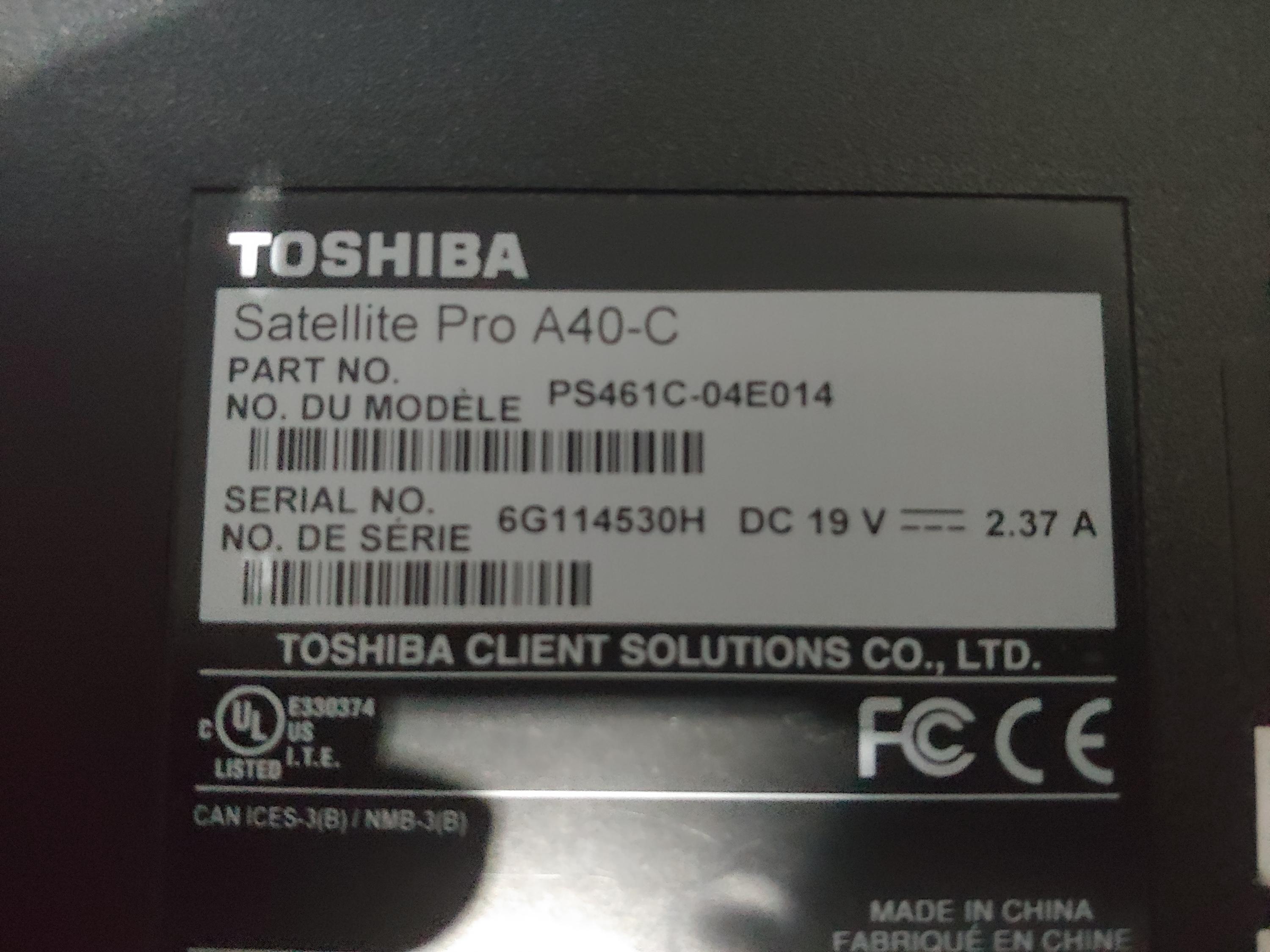

                        Post a picture of the sticker with the model and serial number on it

                          Re: Need Bios bin for Toshiba Satellite pro model PS461C-0E014
                          Thanks hoaca388 and SMDFlea for you help on this one.
                          A picture is attached
                              Originally posted by waakye
                              Hey hoca388,
                              With the file you attached, am experiencing the same no boot no post.
                              Thanks for your help.
                              It is not possible to transfer the DMI information from the old file to the new file because it is completely wrong with the sticker.
                              Product Support | A40-C
                              PART NUMBER: PS461C-04E014
