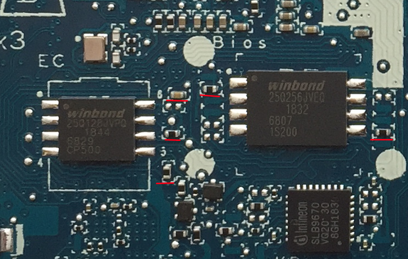

HP Elitebook X360 1030 G3 remove password BIOS.
Try
flash both Wait few minute until boot
At 1st boot press F10 and RESET BIOS to factory defaultsAttached FilesComment
againAttached FilesComment
Check the resistors and caps around the BIOS chips to not been blow away and missing...I marked some of them...
"The charging lite is only flashing and doesn't even boot up..."
I bet is flashing orange/white/off, right?
That's meaning the MAIN bios can't communicate with the EC chip and the reasons can be a lot...bad EC chip content or physically bad chip, bad MAIN bios content, no communication caused by missing components or broken tracks,...
Good Luck!
