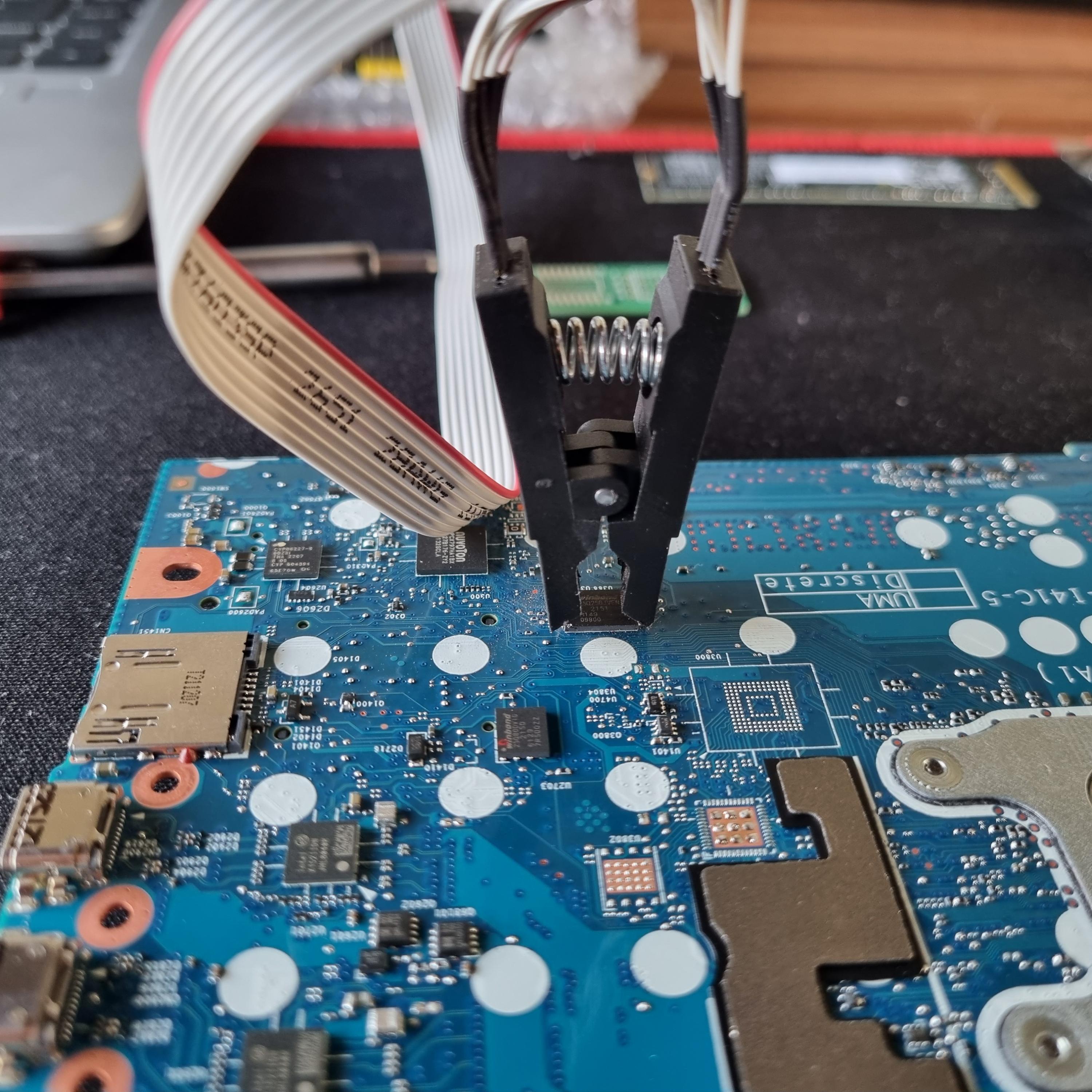

    I have HP Elitebook 850 G8, locked BIOS. Has anyone tried with this tool?

      This tool doesn't work with 32MB file but you can post your bios and EC file here.

            #485
            Re: RCUnlocker
            EC file?
            I will extract both bios chips if I find them
            Probably the one under keyboard is the one I need to flash, right?
            I will do it in few hours.
            edit:
            I found this youtube video: https://www.youtube.com/watch?v=OG_xNKi1QKU
            I think it might be working. Any comment on this?

              • NTBservis

                  #488
                  Re: RCUnlocker
                  Yes, it is.
                  I am not able to upload files.
                  I will send the link to it.
                  Can somebody help me with unlocking?
                  https://files.fm/u/kvbsfna3p

                    #489
                    Re: RCUnlocker
                    I have tried flashing chip on back side with method from the video i linked 3 posts above. But it is still asking for bios admin password. Also when i turn on the laptop it is showing company logo, not HP, but company that used to own that LAPTOP. might that be the problem why flashing did nothing?
                    Any help is welcome.

                        • Mr.Snakeman

                          HP EB 840 G8 BIOS locked. Is the chip needing reprogramming a Winbond 25Q256FV on the underside of the board and is it the only one needing such work?

                            Re: RCUnlocker
                            Post your bin file, I'll do the unlocking for you. If in doubt, post both bins, I'll figure which is which.

                                  • Mr.Snakeman

                                    #497
                                    Re: RCUnlocker
                                    Thanks, now all I have to do is figure out how to make those bin files. I`m an utter newbie to all of this, so please bear with me.
