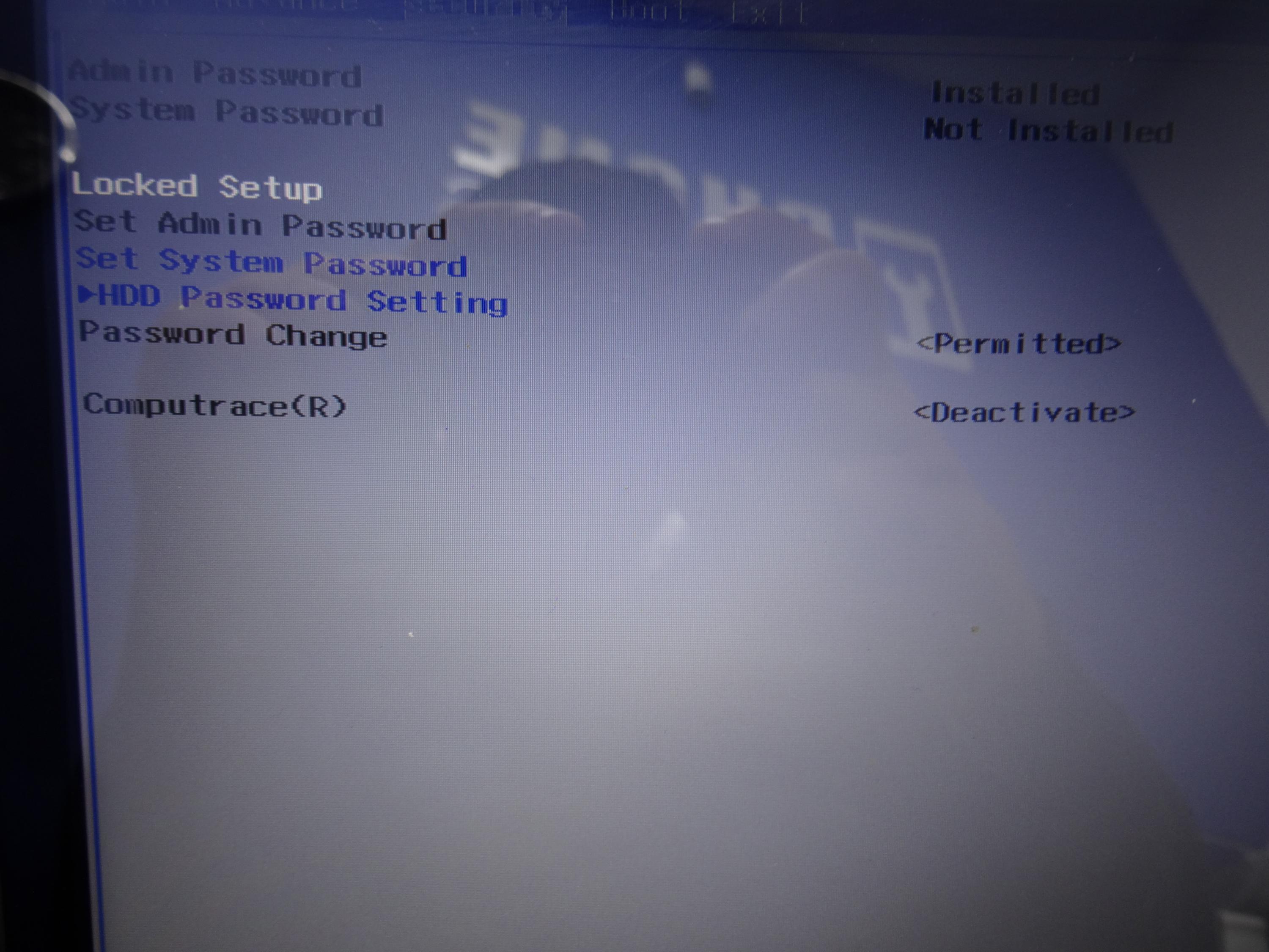

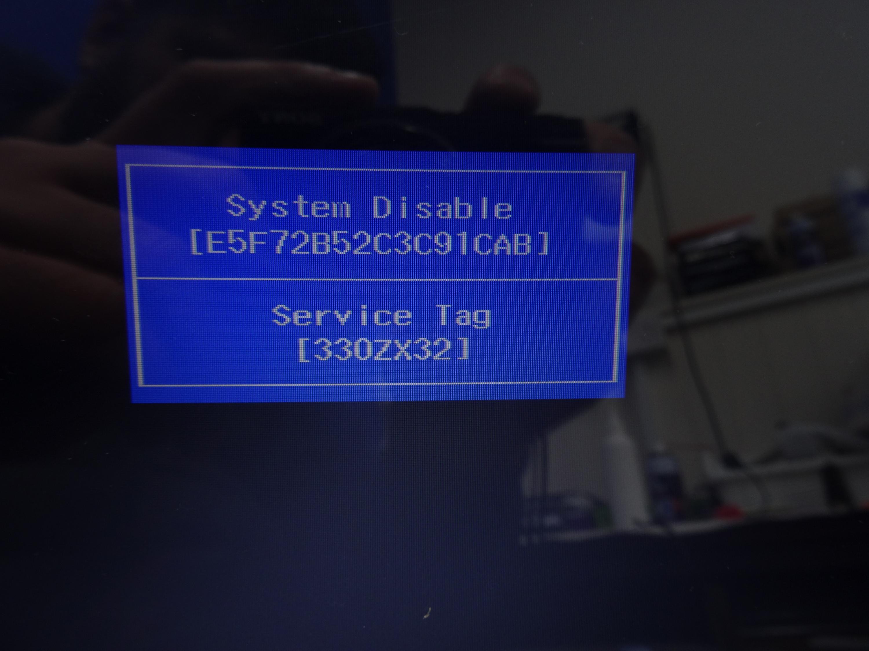

    Hello, i have a dell precision 3540 with a bios lock
    Board number LA-G902P REV 1.0
    Here's both the bios and ec dumps :

      It didn't work, my guess is that the bios password is stored on the EC chip and whenever i put another bios it gets written back by the EC firmware.
      Tried with yours and another one but still the same result.

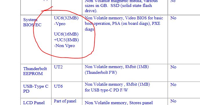

            You posted 16MB and 2MB backups. UC5 should be 8MB with a non-vPro config .
            You have the wrong size bios chip or you`ve backed it up using the wrong setting.
            https://cdn.badcaps-static.com/pdfs/...1624d62102.pdf

              Yes you're right my programmer read it as W25Q16, didn't bother to
              check what's written on the chip, i'll make a new dump and upload it.
              Thanks.

                  I assembled it quickly, I'm a little busy at the moment, test it, if necessary I will edit it later.
                  Program both chips:

                              just program 8mb file W25Q64
                              • moula
                                • Jan 2016
                                • 24
                                • ANNABA
                                Re: Dell precision 3540
                                Thank you man, this one worked !
