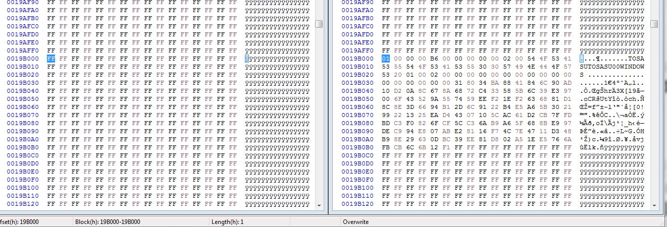

            The 4MB backup is empty, thats why its compressed down to only 2.1KB ,the file is all FF ,open it with a hex editor and see . The chip is empty,or you made a bad backup, have you desoldered or using a clip ?
            HxD - https://mh-nexus.de/en/downloads.php?product=HxD20 .Italian language versions are available

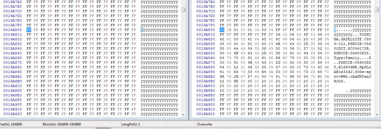

                this
                  • 20914
                  Re: toshiba satellite C855-1L1 pskcce bios bin
                  Originally posted by poweron
                  this
                  Your bios + DMI .

                      The laptop serial number and other info .The bios was extracted from a toshiba update,and the DMI copied from your backup to the new one.
