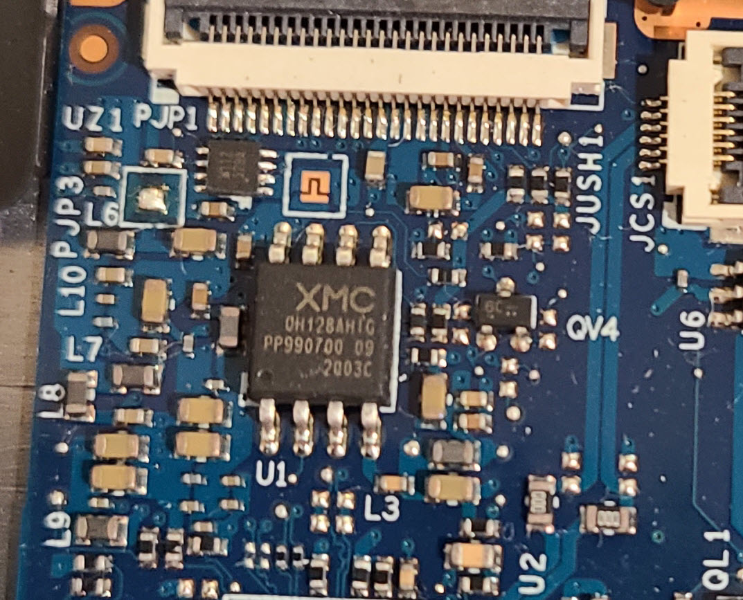

                              Re: Dell Latitude 5400 Bios password
                              chip is xmc qh128ahig. zip has all the dumps.
                                And the board is EDC41 LA-G891P Rev:1.0 (A00)
                                  I don't even need to look at the files because this is not the correct chip. This model has two bios options:
                                  1. Single bios chip - 32Mb
                                  2. Dual bios - 16Mb + 8Mb
                                  That's why I said to read the thread from the beginning!
                                  So you must find the 8Mb chip.

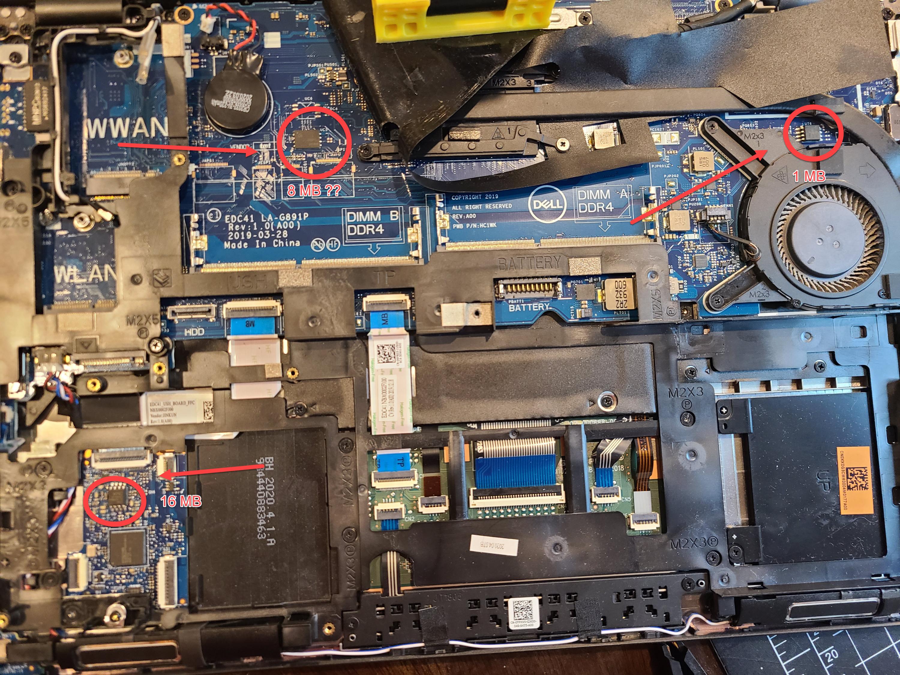

                                    Is this the 8mb chip? My clip won't work with that. Any suggestions?
                                      Give me the markings on all the chips, the image is not good enough to see the markings myself.
                                      Become a Badcaps supporter
                                      Thanks to all supporters.​
                                        attached
                                          attached
                                          First image - ( GigaDevice) 25B256DYIG = 32Mb That's the right chip.
                                          The place for the UC6 is empty:
