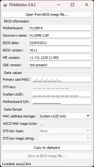

    No the addresses are different
    That was my guess but how to know those?
    The end address is 7FF
    You're right. My inattention but that is not 2KB (2048 bytes) also. Then what is 2032 Bytes? For which bios(es)?
    The win-raid guide is only for ME firmware
    I mean, I couldn't find these adresses, byte sizes neither OP nor in linked topic.
    Frankly, I need such a guide for general knowledge but this topic a bit specific, seemingly.

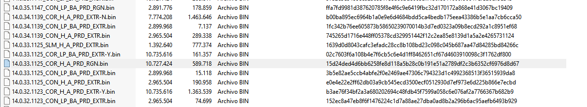

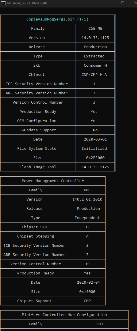

                If my ME analyzer say vers 14.0.33.1125 and i need the RGN version but the unique version that have rgn is the corporate verion whta i need to do? in consumer version H
ID:	3182592 Click image for larger version
                  SMDFlea commented
                  Editing a comment
                  Use the next oldest or newer consumer version H .Using a slightly older/newer one is usually ok
