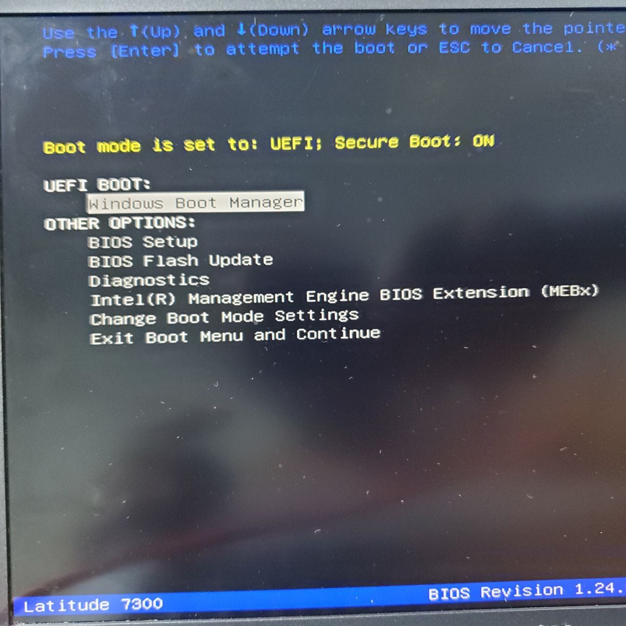

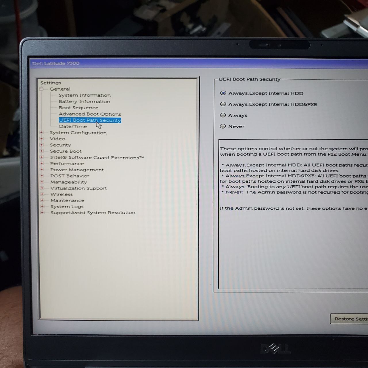

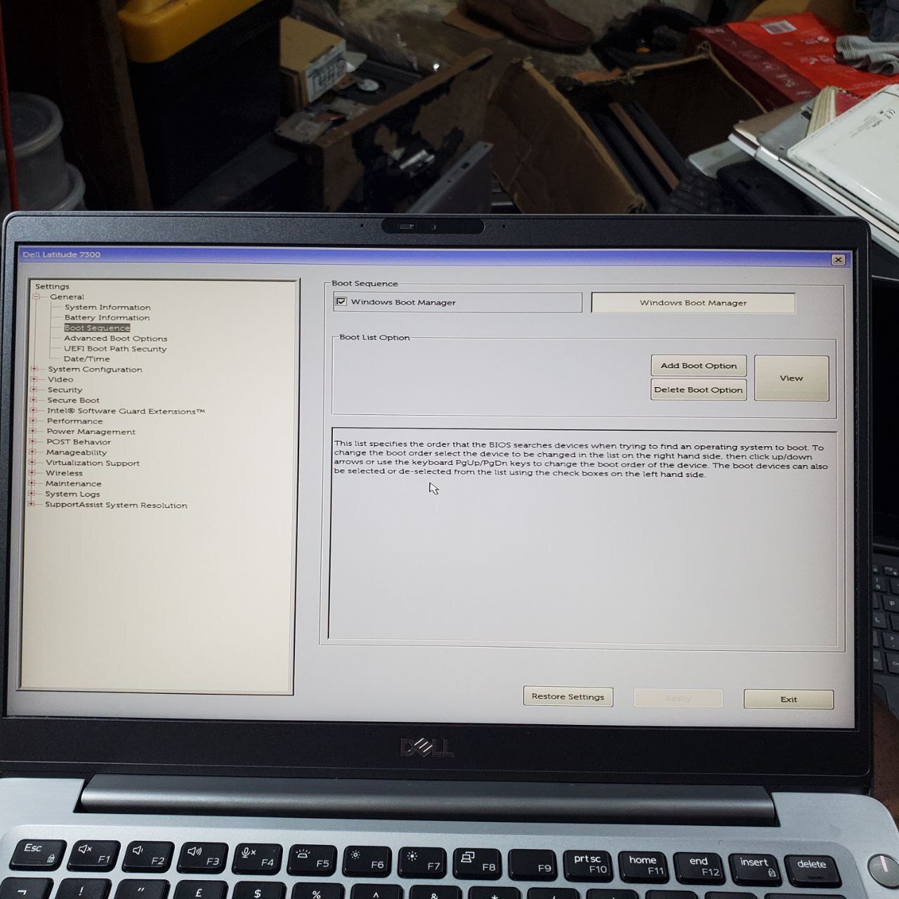

dell latitude 7300 bios
    commented on 's reply
    Service tag ? https://www.badcaps.net/forum/troubl...before-posting
  • MOBIKOS2022
    replied
    help remove bios password dell latitude 7300
    Leave a comment:
  • mberbouch
    replied
    Originally posted by peste
    Re: dell latitude 7300 bios
    the bios from post # 1, with the ME region clean..I hope it will be helpful ..
    Thanks, it works for me too.
    Leave a comment:
  • qayyum786
    replied
    Originally posted by struart
    Thats how it's done.
    ALL OK
    Laptop entered manufacture mode.
    Entered service tag save ALT+F and viola
    Leave a comment:
  • struart
    replied
    Originally posted by qayyum786
    Try again
    Thats how it's done.
    ALL OK
    Laptop entered manufacture mode.
    Entered service tag save ALT+F and viola
    Leave a comment:
  • qayyum786
    replied
    Try again
    Leave a comment:
  • struart
    replied
    Originally posted by qayyum786
    try a new one
    After flashing bios still have password and theres no sign of any change in it. Service Tag is untouched etc
    Leave a comment:
  • qayyum786
    replied
    Originally posted by struart
    Hello
    I need unlock and CleanME this dump.
    Laptop sometimes freeze on DELL logo and stay there.
    After force shutdown and start again its booting ok.
    Service tag 3CNM3Z2
    Motherboard EDC30 LA-G861P REV 1.0 A00
    2019-02-23
    try a new one
    Last edited by Vesko356; 02-03-2024, 03:02 PM. Reason: Quote added
    Leave a comment:
  • struart
    replied
    Hello
    I need unlock and CleanME this dump.
    Laptop sometimes freeze on DELL logo and stay there.
    After force shutdown and start again its booting ok.
    Service tag 3CNM3Z2
    Motherboard EDC30 LA-G861P REV 1.0 A00
    2019-02-23
    Leave a comment:
  • apostsamking
    replied
    Originally posted by qayyum786
    TRY A NEW ONE
    thanks so much, it powers on but no display
    Leave a comment:
  • qayyum786
    replied
    TRY A NEW ONE
    Leave a comment:
  • apostsamking
    replied
    see attachment
    Leave a comment:
  • apostsamking
    commented on 's reply
    thanks very much but am still having this problem. i can disable secure boot, any changes i make in bios goes back to defaults, i cant book from Pen drive, Pen drive is not visible when you press f12
  • apostsamking
    commented on 's reply
    thanks very much but am still having this problem. i can disable secure boot, any changes i make in bios goes back to defaults, i cant book from Pen drive, Pen drive is not visible when you press f12
  • hoaca388
    replied
    Originally posted by apostsamking
    I HAD TWO OF THE SAME LAPTOP LATITUDE 7300, WITH PASSWORD LOCK, I TRIED UNLOCKING THE SECOND WITH THE UNLOCKED FILE YOU SENT ME, IT UNLOCKS IT ALRIGHT, BUT HDD NOT RECOCOGNIZE, SO IT ALWAYS NO BOOTABLE DEVICE FOUND. ANY CHANGES YOU MAKE IN BIOS AFETER RESTART GOES BACK TO DEFUALT. IT TAKES CLOSE TO 30SECONDS BEFORE IT TURNS ON. CAN YOU HELP ME. THE SERVICE TAG OF THE SECOND ONE IS G1871X2, LOCK BIOS FILE ATTACHED.
    Latitude 7300
    Service Tag: G1871X2
    Leave a comment:
  • apostsamking
    replied
    Originally posted by apostsamking
    I HAD TWO OF THE SAME LAPTOP LATITUDE 7300, WITH PASSWORD LOCK, I TRIED UNLOCKING THE SECOND WITH THE UNLOCKED FILE YOU SENT ME, IT UNLOCKS IT ALRIGHT, BUT HDD NOT RECOCOGNIZE, SO IT ALWAYS NO BOOTABLE DEVICE FOUND. ANY CHANGES YOU MAKE IN BIOS AFETER RESTART GOES BACK TO DEFUALT. IT TAKES CLOSE TO 30SECONDS BEFORE IT TURNS ON. CAN YOU HELP ME. THE SERVICE TAG OF THE SECOND ONE IS G1871X2, LOCK BIOS FILE ATTACHED.
    ok Sir thanks
    Leave a comment:
  • Vesko356
    commented on 's reply
    Do NOT post in all caps
    https://www.badcaps.net/forum/troubl...before-posting
    You must post the second machine Service tag.
  • Markus1741
    replied
    Originally posted by apostsamking
    I HAD TWO OF THE SAME LAPTOP LATITUDE 7300, WITH PASSWORD LOCK, I TRIED UNLOCKING THE SECOND WITH THE UNLOCKED FILE YOU SENT ME, IT UNLOCKS IT ALRIGHT, BUT HDD NOT RECOCOGNIZE, SO IT ALWAYS NO BOOTABLE DEVICE FOUND. ANY CHANGES YOU MAKE IN BIOS AFETER RESTART GOES BACK TO DEFUALT. IT TAKES CLOSE TO 30SECONDS BEFORE IT TURNS ON. CAN YOU HELP ME. THE SERVICE TAG OF THE SECOND ONE IS G1871X2, LOCK BIOS FILE ATTACHED.
    Try this file ....
    Leave a comment:
  • minhdigital
    replied
    Originally posted by apostsamking
    I HAD TWO OF THE SAME LAPTOP LATITUDE 7300, WITH PASSWORD LOCK, I TRIED UNLOCKING THE SECOND WITH THE UNLOCKED FILE YOU SENT ME, IT UNLOCKS IT ALRIGHT, BUT HDD NOT RECOCOGNIZE, SO IT ALWAYS NO BOOTABLE DEVICE FOUND. ANY CHANGES YOU MAKE IN BIOS AFETER RESTART GOES BACK TO DEFUALT. IT TAKES CLOSE TO 30SECONDS BEFORE IT TURNS ON. CAN YOU HELP ME. THE SERVICE TAG OF THE SECOND ONE IS G1871X2, LOCK BIOS FILE ATTACHED.
    Send to you
    Leave a comment:
  • apostsamking
    replied
    Originally posted by minhdigital
    Send to you !!
    I HAD TWO OF THE SAME LAPTOP LATITUDE 7300, WITH PASSWORD LOCK, I TRIED UNLOCKING THE SECOND WITH THE UNLOCKED FILE YOU SENT ME, IT UNLOCKS IT ALRIGHT, BUT HDD NOT RECOCOGNIZE, SO IT ALWAYS NO BOOTABLE DEVICE FOUND. ANY CHANGES YOU MAKE IN BIOS AFETER RESTART GOES BACK TO DEFUALT. IT TAKES CLOSE TO 30SECONDS BEFORE IT TURNS ON. CAN YOU HELP ME. THE SERVICE TAG OF THE SECOND ONE IS G1871X2, LOCK BIOS FILE ATTACHED.
    Leave a comment:
  • gizaha
    Dell Latitude 5580 possible bios corruption
    by gizaha
    Dell latitude 5580, motherboard cdp 80 la-e151p
    3 amber 3 white blinks. Dell website sais it's problem "bios recovery" and suggested solution "recovery image not found"
    (from here https://www.dell.com/support/manuals...e7a&lang=en-us)
    I try plugging charger while pressing ctrl+esc, machine turns on, nothing and after 20 seconds it gives 3 amber 3 white blinks again.
    Since ssd is replaced and had clean install windows, i've...
    02-13-2024, 07:18 AM
    DELL Latitude 7300 Notebook 7000 Specification for Upgrade or Repair
    This specification for the DELL Latitude 7300 Notebook can be useful for upgrading or repairing a laptop that is not working. As a community we are working through our specifications to add valuable data like the 7300 boardview and 7300 schematic. Our users have donated over 1 million documents which are being added to the site. This page will be updated soon with additional information. Alternatively you can request additional help from our users directly on the relevant badcaps forum. Please note that we offer no warranties that any specification, datasheet, or download for DELL Latitude 7300...
    09-06-2024, 02:34 PM
    DELL Latitude 7300 Notebook 7000 Specification for Upgrade or Repair
    This specification for the DELL Latitude 7300 Notebook can be useful for upgrading or repairing a laptop that is not working. As a community we are working through our specifications to add valuable data like the 7300 boardview and 7300 schematic. Our users have donated over 1 million documents which are being added to the site. This page will be updated soon with additional information. Alternatively you can request additional help from our users directly on the relevant badcaps forum. Please note that we offer no warranties that any specification, datasheet, or download for DELL Latitude 7300...
    09-06-2024, 12:36 PM
    DELL Latitude 7300 Notebook 7000 Specification for Upgrade or Repair
    This specification for the DELL Latitude 7300 Notebook can be useful for upgrading or repairing a laptop that is not working. As a community we are working through our specifications to add valuable data like the 7300 boardview and 7300 schematic. Our users have donated over 1 million documents which are being added to the site. This page will be updated soon with additional information. Alternatively you can request additional help from our users directly on the relevant badcaps forum. Please note that we offer no warranties that any specification, datasheet, or download for DELL Latitude 7300...
    09-06-2024, 12:36 PM
    DELL Latitude 7300 Notebook 7000 Specification for Upgrade or Repair
    This specification for the DELL Latitude 7300 Notebook can be useful for upgrading or repairing a laptop that is not working. As a community we are working through our specifications to add valuable data like the 7300 boardview and 7300 schematic. Our users have donated over 1 million documents which are being added to the site. This page will be updated soon with additional information. Alternatively you can request additional help from our users directly on the relevant badcaps forum. Please note that we offer no warranties that any specification, datasheet, or download for DELL Latitude 7300...
    09-06-2024, 12:36 PM
