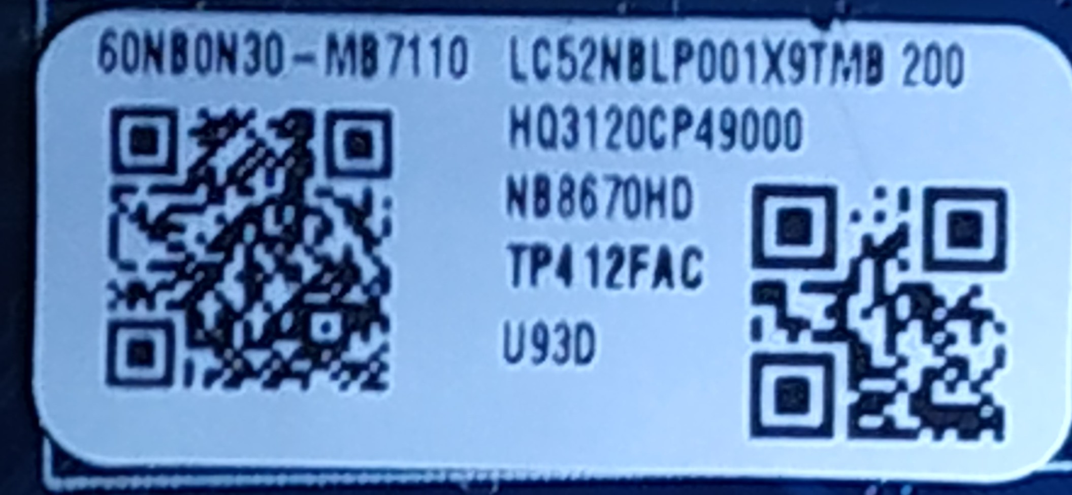

    please help me need ASUS tp412fa bios
    don't have original file my programmer cant see flash
    need file please board number tp412fa mini board rev 2.1
    thanks

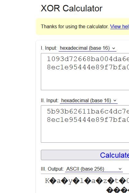

        Need Help remove this bios password, i've try remove 1 password that i think it admin, but only user password.
        Thanks before
          • 21254
          Re: Asus TP412FA

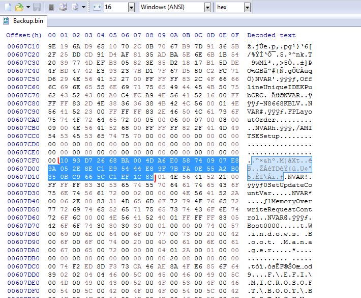

          Its an AMI bios, the AMITSE method will work on this. https://gist.github.com/en4rab/55088...f3039e3c8ab6fd
          Its been mentioned on the forum many times how to decrypt.Open the bios with a hex editor,search for AMITSE ,keep searching again until you find an AMITSE area with some code.Copy the hex and make it the same length as the decyption hex ,XOR both codes to ASCII
          Copy the first line of hex into notepad/wordpad ,remove the spaces.
          This is the second code to decrypt the first
          5B93B62611BA6C4DC7E022747D07D89A332E8EC1E95444E89F7BFA0E55A2B0350BC9665CC1EF1C83
          Enter both hex codes at http://xor.pw ,output to ASCII
