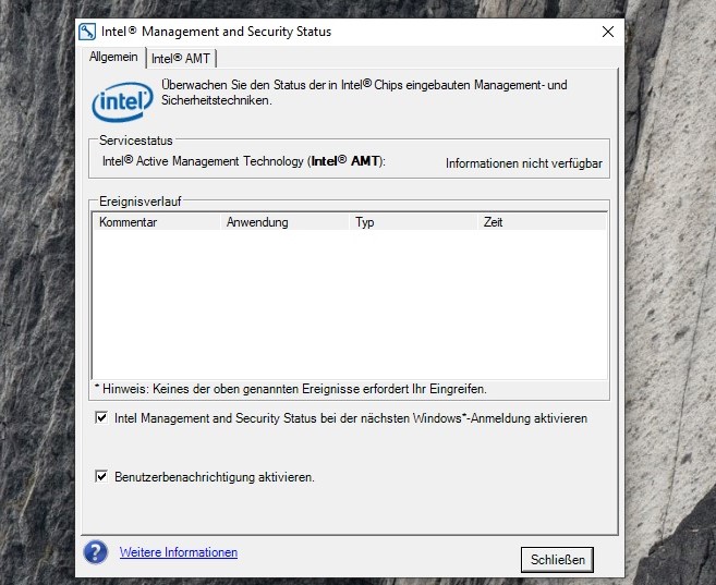

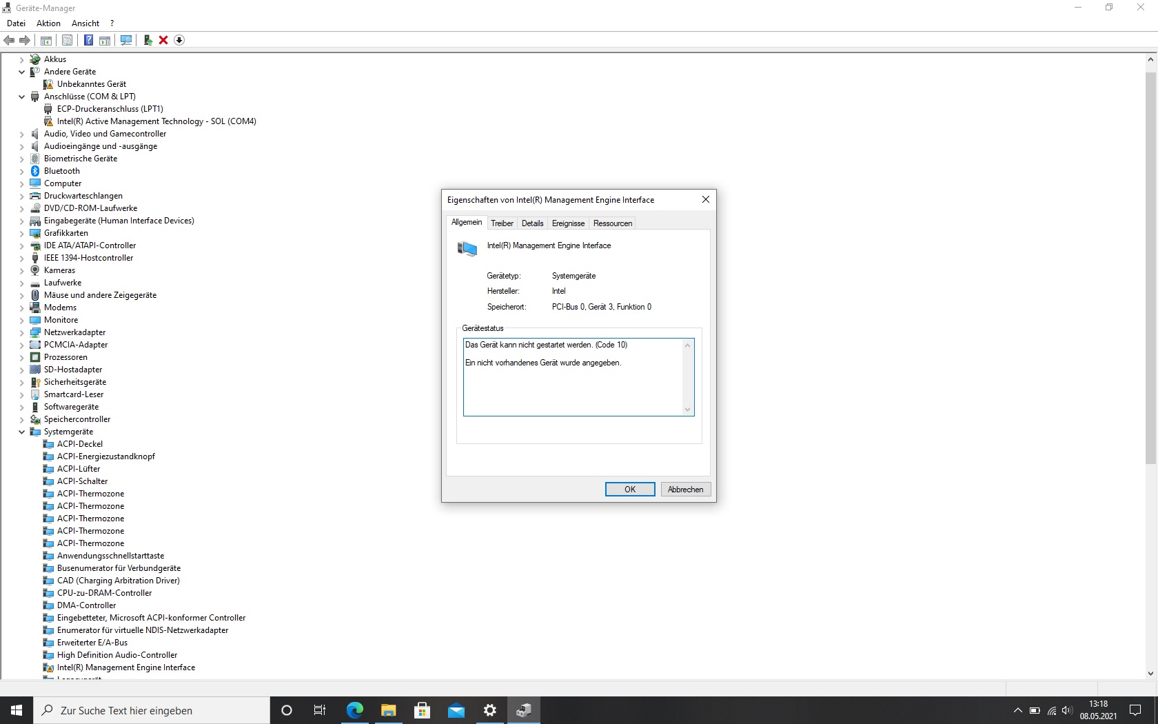

    Hello together,
    I have a problem with the management engine on an hp 8530w Notebook.
    Device cannot be started and I also cannot communicate with it.
    When I got the unit the bio was with a password, the program of mazzif didn't succeed so I flashed it with the one found here.
    Since then there is the problem with the management engine.
    HWInfo tells me that version of ME is 0, but should be 4 I guess?!
    Can anybody help me restore it?
    • 22077
    Re: hp 8530w Notebook Problem with Intel Management Engine
    post your original bios backup
    • Conste
      • Oct 2018
      • 235
      Unfortunately, there is none - I can just give you the one I have flashed.
        • 22077
        what did you do with the bios you tried with mazzif software
        • Conste
          • Oct 2018
          • 235
          I think I deleted it from the stick...
          Bios wasn't locked by a simple password, but with a username and a passowrd I guess
          Then I opened the laptop and took the CH341A and flashed the bios with the one I uploaded here.
          Also tried a F13 whitelisted bios and the original hp F20 one, but no success.
          Maybe ME is just somehow disabled? Or is it defective? I don't know much about the whole AMT/ME thing
            • 22077
            Try and install the AMT driver first
            AMT Driver https://ftp.hp.com/pub/softpaq/sp450...00/sp45131.exe
            If that doesn`t work flash the attached bios,then run the ME FW Update https://ftp.hp.com/pub/softpaq/sp580...00/sp58154.exe
            If the error is still there uninstall the AMT drivers,reboot and install them again.
            • Conste
              • Oct 2018
              • 235
              Great it worked fine after flashing the BIOS you provided and the FW update + driver reinstall.
              Thanks a lot!
