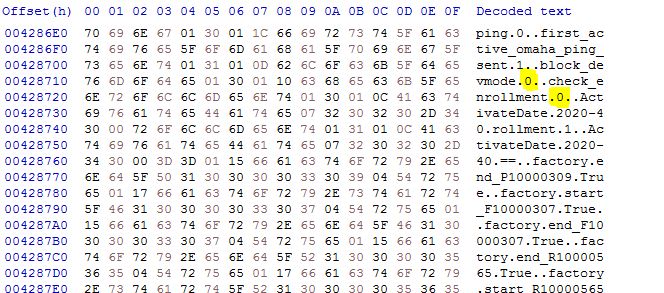

                Bios 1 & 2 = Lenovo 500e chromebook 2ng Gen Model 81MC Board ID : DB5866_V1.3
                Bios 3 = Lenovo 500e chromebook Model 81ES Board ID : BM5736_V1.4 For MP2.1

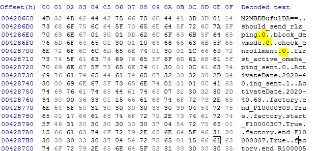

                  Here are the files. Flash them. Try accessing devmode (you will fail but you would need to do it.) After restart you should be able to log in using a random google account. From there, do a powerwash. Now it's unenrolled and devmode unlocked.

                    I'll do the first one, you do the rest and learn. Hint: compare with hexeditor.

                      The Cheese was faster than me, well, hope you can learn something.

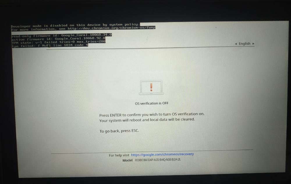

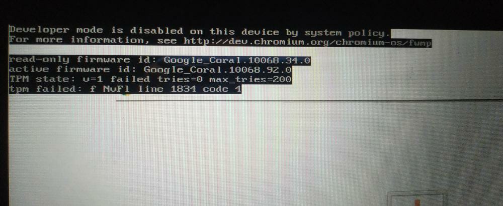

                            I press the ESC key and circle key on top of the keyboard, takes me to dev mode then it gives error of no operating system found. It also gives out the exact model and the chrome webpage, so I just open chrome, and go there, download the extension, open the extension and download the operating system on an 8gb USB drive. Use that drive on the chromebook and wait for it to finish. Last time I did four, so I used only one drive, all same model.
                            I can see the webpage and model of your chromebook on the third picture, just go there.

                              As I said, you need to go to dev mode. It will not let you, but you need to go there anyway. Then you would need to let it go back to normal mode. There, it should let you sign in with any account, instead of school/company account. Log in, do a powerwash.

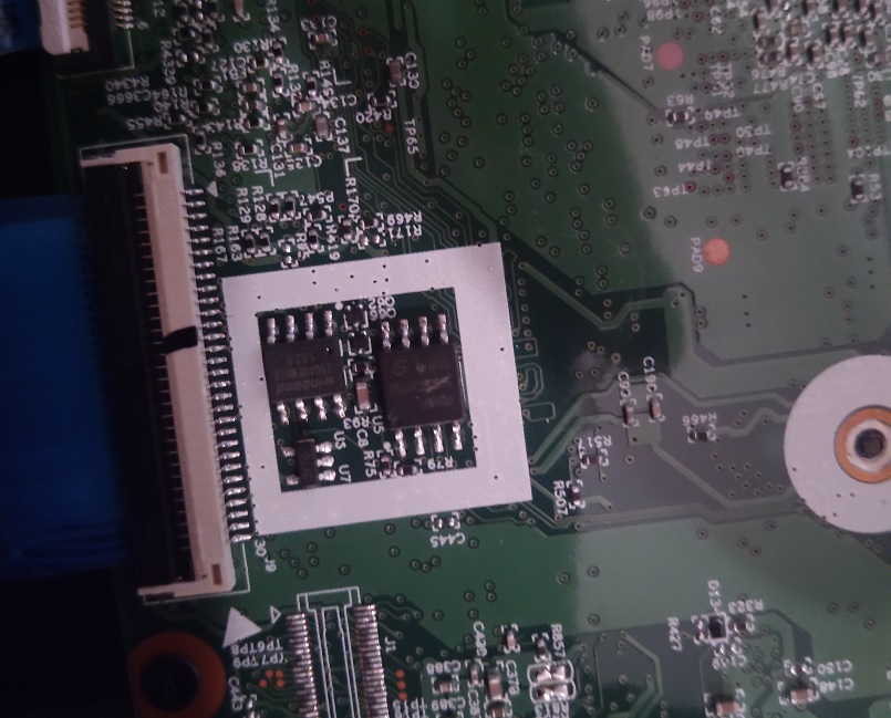

                                where is the bios chip located on this board does anyone have a picture?

                                  in a white square
