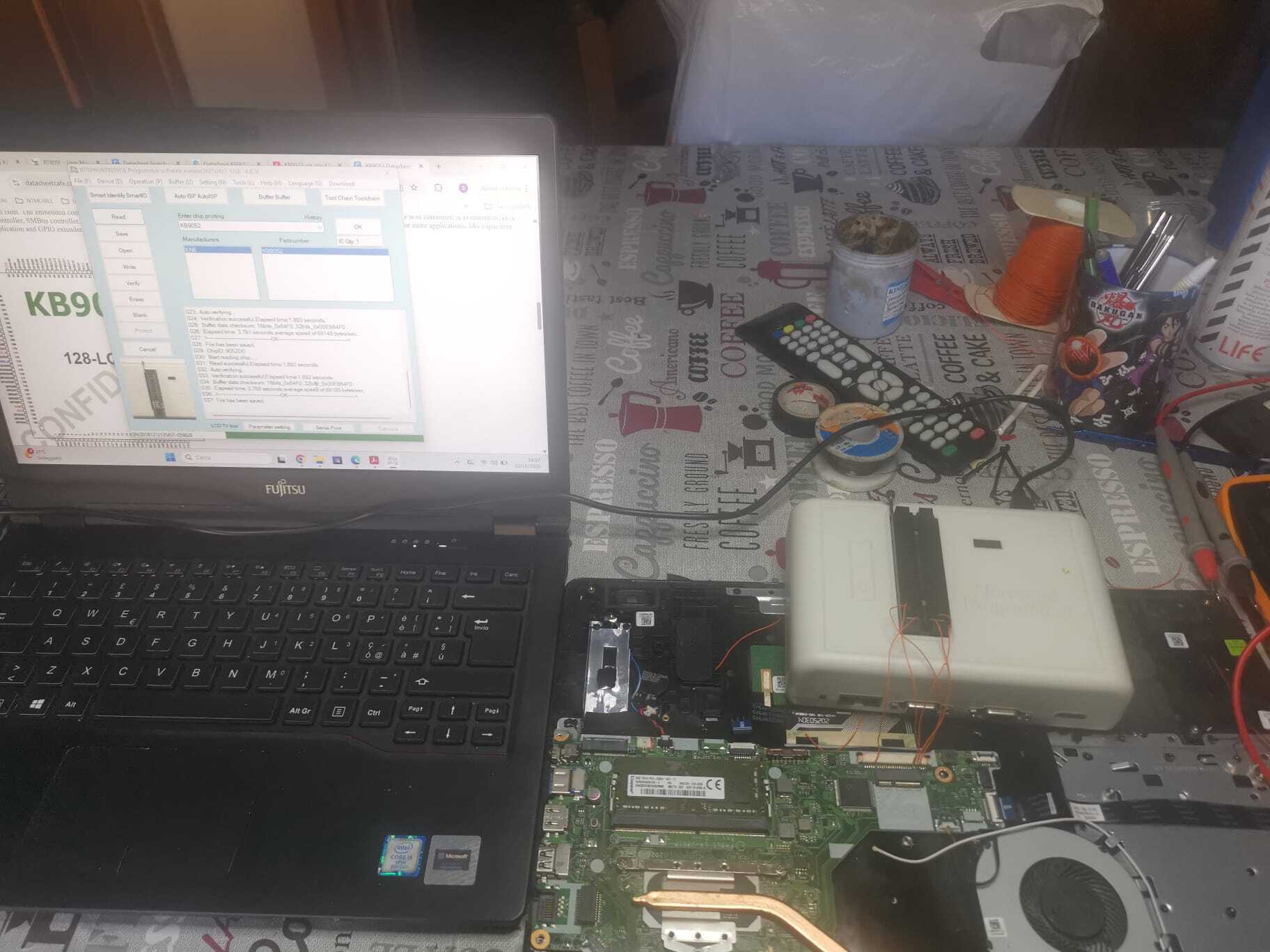

I replaced the KBC, and the new one allowed itself to be programmed, and the laptop booted up. Unfortunately, it only worked until the first restart. After that, it booted up with no display. When I tried to reprogram it using the EC dump from the forum, I have a problem. The memory doesn't pass verification, and the readout shows that the entire content is "ZZ." I can only erase the entire memory, and in this case, it passes verification. The whole dump becomes "FF," but the blank KBC doesn't program itself in this situation.
Is there anything specific I need to do when reprogramming this KBC?

I have an Acer A315-56 notebook, s/n: NXHS5ET0040471F2993400, with motherboard FH5LI LA-J801P. After disconnecting the battery to replace the keyboard, it no longer boots. The blue LED turns on for a few seconds and then immediately turns off. I used the CH341A programmer to flash the BIOS, but without success. Does anyone have a working BIOS? Can someone tell me how to flash the EC.bin as well? Thank you.Comment
Thread merged. Post your original bios backup.I have an Acer A315-56 notebook, s/n: NXHS5ET0040471F2993400, with motherboard FH5LI LA-J801P. After disconnecting the battery to replace the keyboard, it no longer boots. The blue LED turns on for a few seconds and then immediately turns off. I used the CH341A programmer to flash the BIOS, but without success. Does anyone have a working BIOS? Can someone tell me how to flash the EC.bin as well? Thank you.Comment
"None of the BIOS files from the previous posts work on my PC. I found the original backup, or rather the one that was read from the original chip. I'm attaching it, thank you."Attached Filesif you find these attachements useful please consider making a small donation to the site
The file is badly corrupted. Are you using a CH341A programmer and a clip ? .Did you erase the chip before programming the othersComment
"Yes, at first I used a clip, but later I desoldered the chip. For programming the chip, I used the CH341A. After saving the file (or rather, what was left of it), I erased and reprogrammed it with files found on the forum. Today, I made a backup of the KB9052 chip and reprogrammed it using the RT809H, but the issue remains: the blue LED turns on for a few seconds and then turns off. I'm attaching the original KB9052 file."Attached Filesif you find these attachements useful please consider making a small donation to the site
