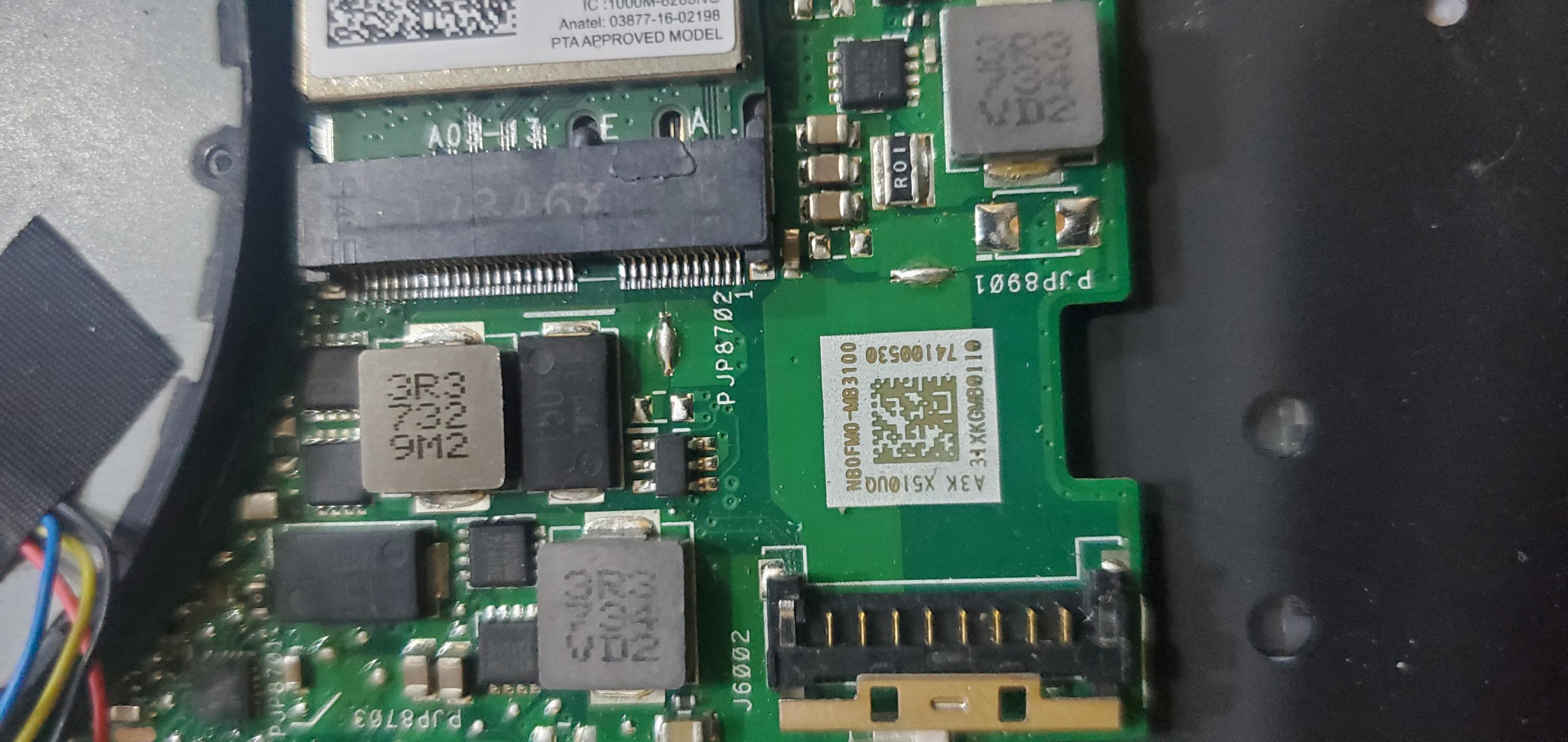

        Post a good clear picture of any white/green stickers on the motherboard. Usually near the RAM .

          Re: Please repair my Asus S510UN dump
          There is this sticker on the motherboard.

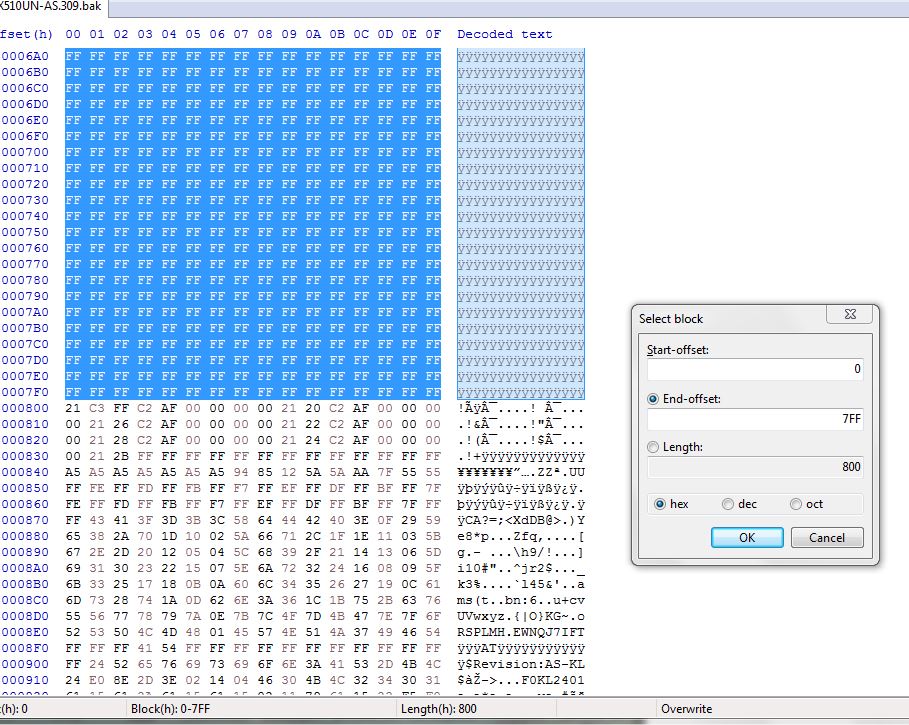

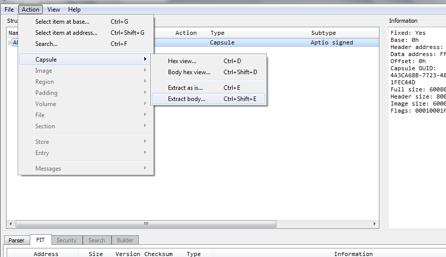

            4. replace in bios we try to fix.bin a part from web update we extracted before this UEFI_image.rom
            Burada ne demek istedin?
            BIOS_region.rgn and UEFI_image.rom
            How do I assemble the pieces?
              Try this one, your DMI included .
              • bilen
                • Aug 2014
                • 637
                • istanbul
                thank you working
                  • 22097
                  The part number on the stickers tells you which version the bios is.On the support site it gives 3 options UNO,UNR,UN so you choose the UN as per the sticker X510UN . All asus bios updates have a 2KB header to remove,its very easy to remove it with UEFITool or a hex editor.Then you`re left with the 6MB bios update.I find it easier to use a hex editor to copy the update over the original bios. The original has DMI info as well that needs copying or you lose the win key and serial .

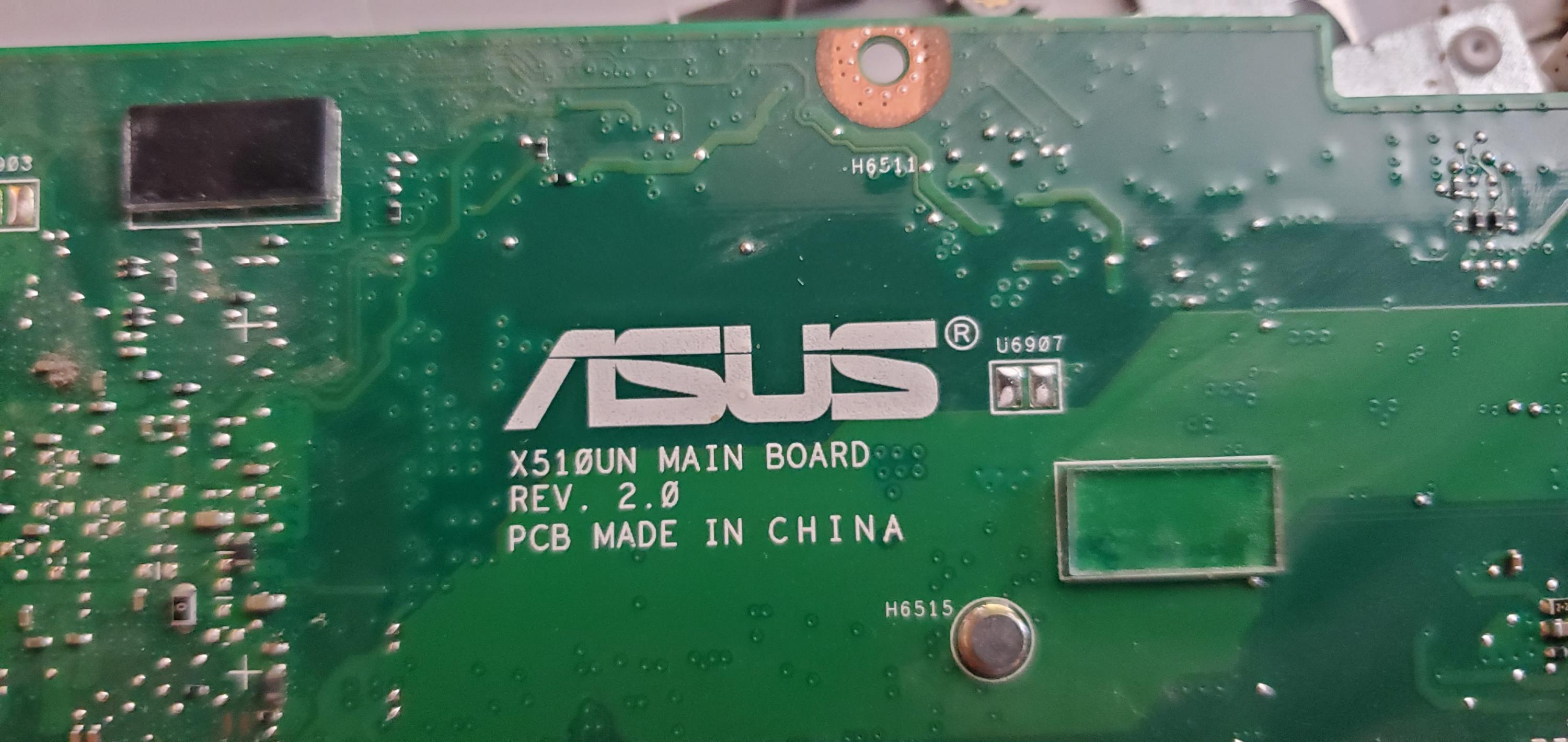

                    Asus s510un bios bin file request
                    X510un main board rev:2.0 bios bin

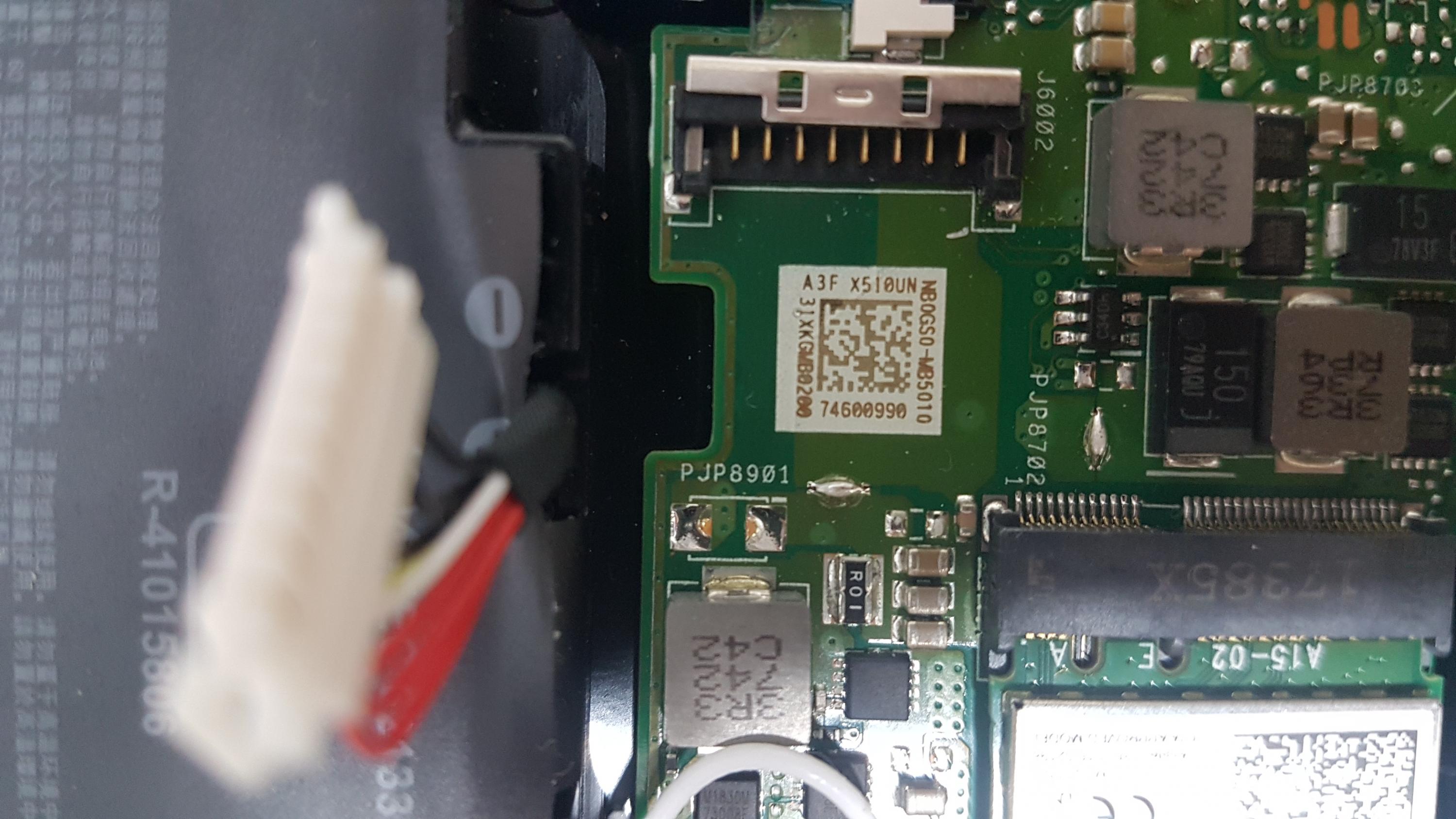

                        Post pictures of all barcode and QR code stickers on the motherboard

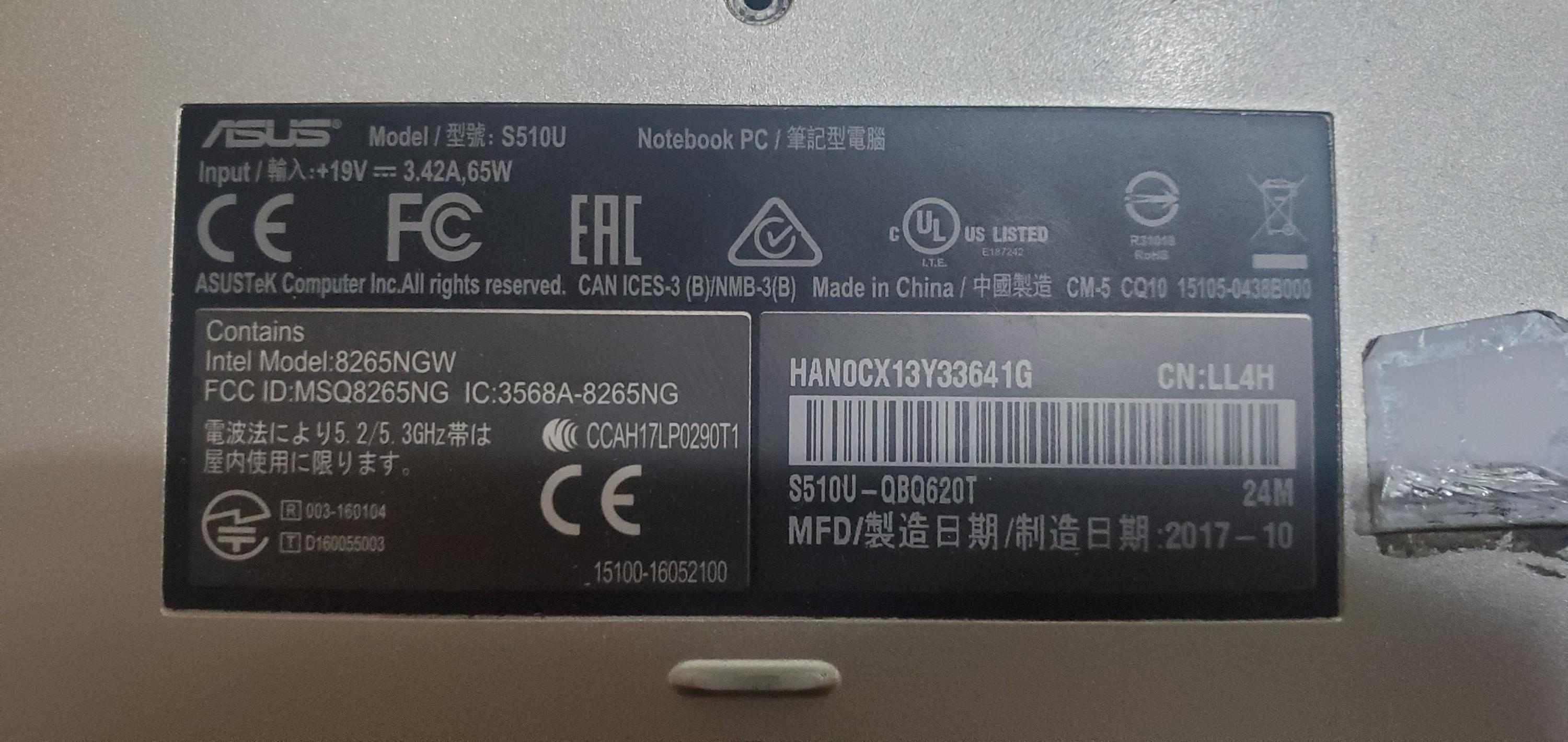

                          hello
                          This all photo .

                            Stickers on the motherboard. Barcode or QR codes. And post your backup please

                              Re: Asus X510UNR
                              This bro.
                                • 22097
                                Re: Asus X510UNR
                                Originally posted by Baboooo
                                This bro.
                                Yes thats the one,now post your bios backup .

                                    • 22097
                                    Re: Asus X510UNR
                                    Backup bios original .
                                    Try this one,i hope it works.
                                    • Baboooo
                                      • Aug 2019
                                      • 16
                                      • Yemen
                                      Re: Asus X510UNR
                                      Thanks for trying, but still the same problem no NVM .
                                        • 22097
                                        Re: Asus X510UNR
                                        https://zentalk.asus.com/en/discussi...s-nvme-m-2-ssd
                                        S510UN's SSD spec is M.2 SATA, it does not support NVMe m.2 SSD.
