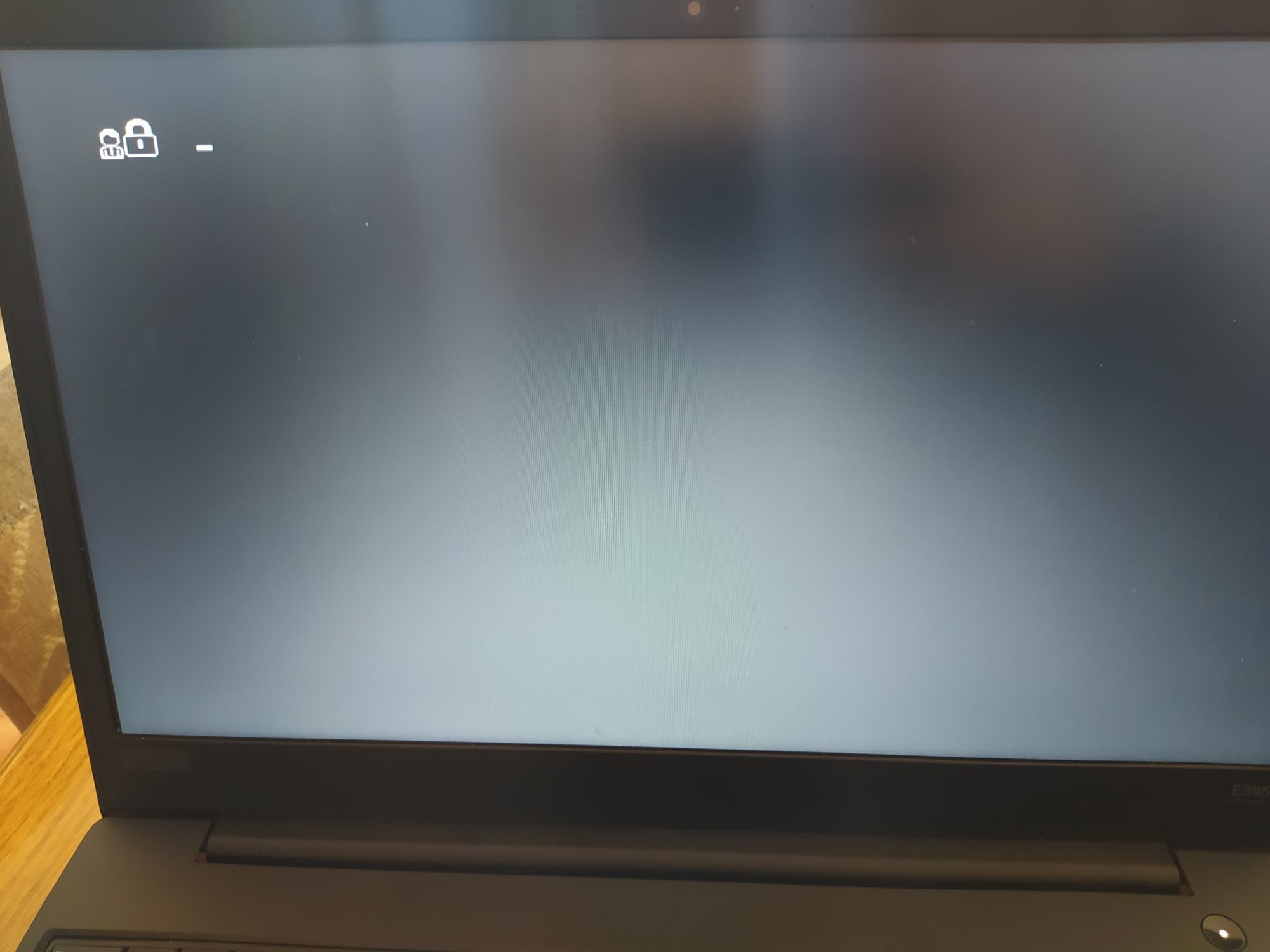

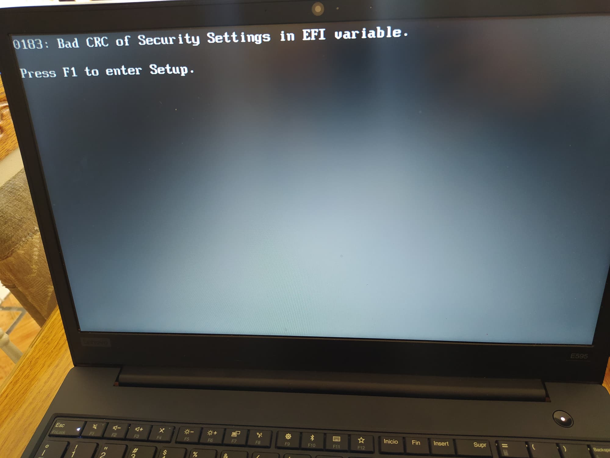

            Bro i used that bios but when it starts it says Error 0183: Bad CRC of Security Settings in EFI Variable then i press f1 and it appears the supervisor prompt. :c hope u can help me

              Re: ThinkPad Edge E595 FE495/FE595 NM-C061 REV 1.0
              these are some pictures what it appears on my laptop i just program my bios with @peste bin but it ask me for password.
                  Originally posted by Amper Men
                  hello peste this is my original backup hope u can help me, removing the password i would appreciate it alot
                  you have in item # 4 the excerpt from the update on the Lenovo site ... it definitely doesn't have a password ... you should have another chip on the motherboard where the password is stored ... I don't know what chip to this model..maybe MEC ..
