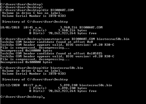

    Please, I need the bios for Toshiba Tecra C50-C celeron version
    I attach the .exe file downloaded from the official page but I don't know how to extract from it or if someone could explain me how to do it.
    I decompressed it with winrar and 7zip but it doesn't have a fd / bin file, only too many files.
    Please help.

        Re: Please bios Toshiba Tecra C50-c
        No luck
        I did all the steps and I get the bin file but the size is very lower, almost 6 MB. The original bios has 16 MB
        I attached the process. Did I do something wrong?
        thank you

              • 21436
              Originally posted by ruletero
              No luck
              thank you
              No,its just that the extracted file is only a bios update,not the full one.
