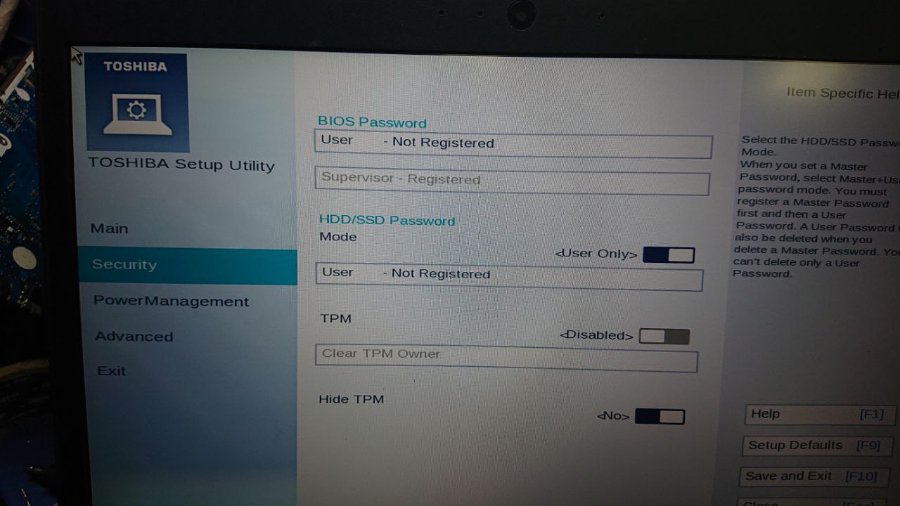

                        thoshiba PROTAGE Z30-B P/N : PT251U-061010F1
                        bios password

                            Re: toshiba protege Z30-b bios
                            only supervisor - registerted locked

                              • 22167
                              Originally posted by its service
                              can u plz unlock this bios password
                              No.
                              3.10. Toshiba
                              3.10.1. Consumer
                              A lot of Toshiba consumer laptops have a jumper on the motherboard that needs to be shorted before boot to clear the password.
                              3.10.2. Business
                              Most Toshiba business laptops do not have a jumper, and the password is stored inside a protected region of the EC. See affected models: https://www.badcaps.net/forum/showpo...2&postcount=19
                              Either you need a donor EC without password, or you need to unlock through challenge-response.
                              Response generator is not available publicly, however, some generous people may be able to generate a response for you. Ask in this thread: https://www.badcaps.net/forum/showthread.php?t=79489
                              Laptop must not be rebooted, the challenge will change.
                                sir can please check the image sir ill attached image plz check
