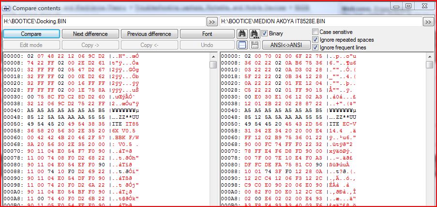

    Need ec-bios for this laptop.
    Mounts kbc ITE IT8528E (ic U10). It has pulses at pin 1,2,5 and 6 all the time, and never change when power button is pressed.
    U17 (pch-bios) have no voltage and no pulses.
    Here is the original backup:

      This is the content of pch-bios:
        • 21679
        Re: EC-BIOS for MEDION AKOYA P2211T
        I found two bios updates,the versions are 1.06 (IS) and 1.06 (A) .Both bios regions are different but both the extracted EC`s are exactly the same as your backup. The pulsing voltage is likely to be the 3V voltage regulator or IT8528E thats faulty

          Thanks for your hard work, I have downloaded a bios update from Medion website, but can't open it with 7zip. (did not try to run the exe)
          If extracted EC`s are both the same as mine, then I will replace kbc with a new one and will cross my fingers.
          Sorry for not explain clearly. The mentioned pulses are measured in ec-bios chip, and are normal pulses.

            Hi, I have extracted ec-bios from "biop221x_106_is.exe" and its content is different to the original one.
            I have tested the ec-bios extracted, but have the same pattern of pulses on bios chip.
            Did you extracted the same bios?
            this is the one I've extracted:
              I did extract the same bios.I meant the EC in the 3MB extracted bios update is the same,i never looked at Docking.bin ,i missed it somehow
              Anyway,try this bios with the 3MB bios update merged + clean TXE ,and the new EC
                Hi, thanks for your help. Im afraid that all the problem come from kbc or its near sourronding circuit.
                The content of Docking.bin and IT8528E_NEW.BIN is the same.
                I've tested Docking.bin without success.
                I will try the P2211T BYT_TAB TXE_CLEAN dump for pch-bios, but the pch bios seems to work only when kbc talk with pch and I think this talk is not present. (pch-bios has no 1.8 volts in pin 8)
                I am investigating and comparing other laptops circuis with the same kbc. (IT8528E)
                I will post the positive results. (it is very difficult without schematic)
                Thanks.
                  • 21679
                  IT8528E_NEW is just Docking.bin padded out to 256KB . 1.8V might not appear until after pressing the power button,you need to find out how and where its generated from. Are there any part numbers on the motherboard to check for a schematic ?
