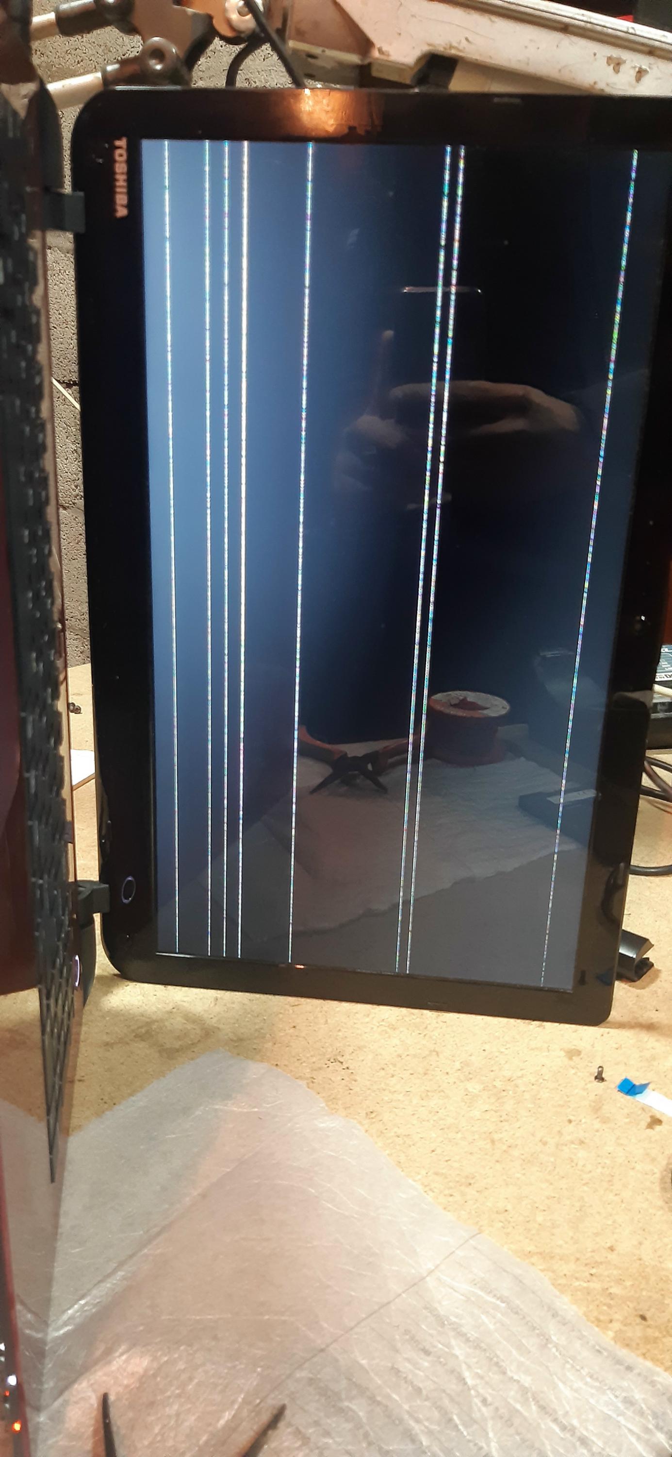

    Hello my friends.
    I was playing a little bit with bios on this laptop,but before everything i have created a backup from bios that was working.
    But after trying to flash some bios bin files, none of which worked,i tried to flash original and then laptop was not powering up.
    I think I damaged the bios on this laptop, while reading the bios flash.
    Motheboard in this laptop is : dablidmb8e0 rev:e
    I tried few bios bin files from this site with this motheboard and nothing was working.
    Except one i found on remont-aud net,it turns on but with some horizontal lines.I'll attach one picture.
    I know it's damaged because when it loads in "Intel Easy clean me" it says "Invalid input file original bios backup.BIN"
    Thank you,and sorry for long post !

    Re: Fijutsu Siemens l50-b-2cr
    Your toshiba part number is PSKTCE,the bios from remont is PSKTNE
    Try this bios at post #5
    https://www.badcaps.net/forum/showthread.php?t=57402
      I alredy tried this bios file,laptop turns on but black screen.
      Yes,i know it is PSKTCE.But when I've already tried every bios PSKTCE i can found,then I tried everything, the only condition was to have the same board model.

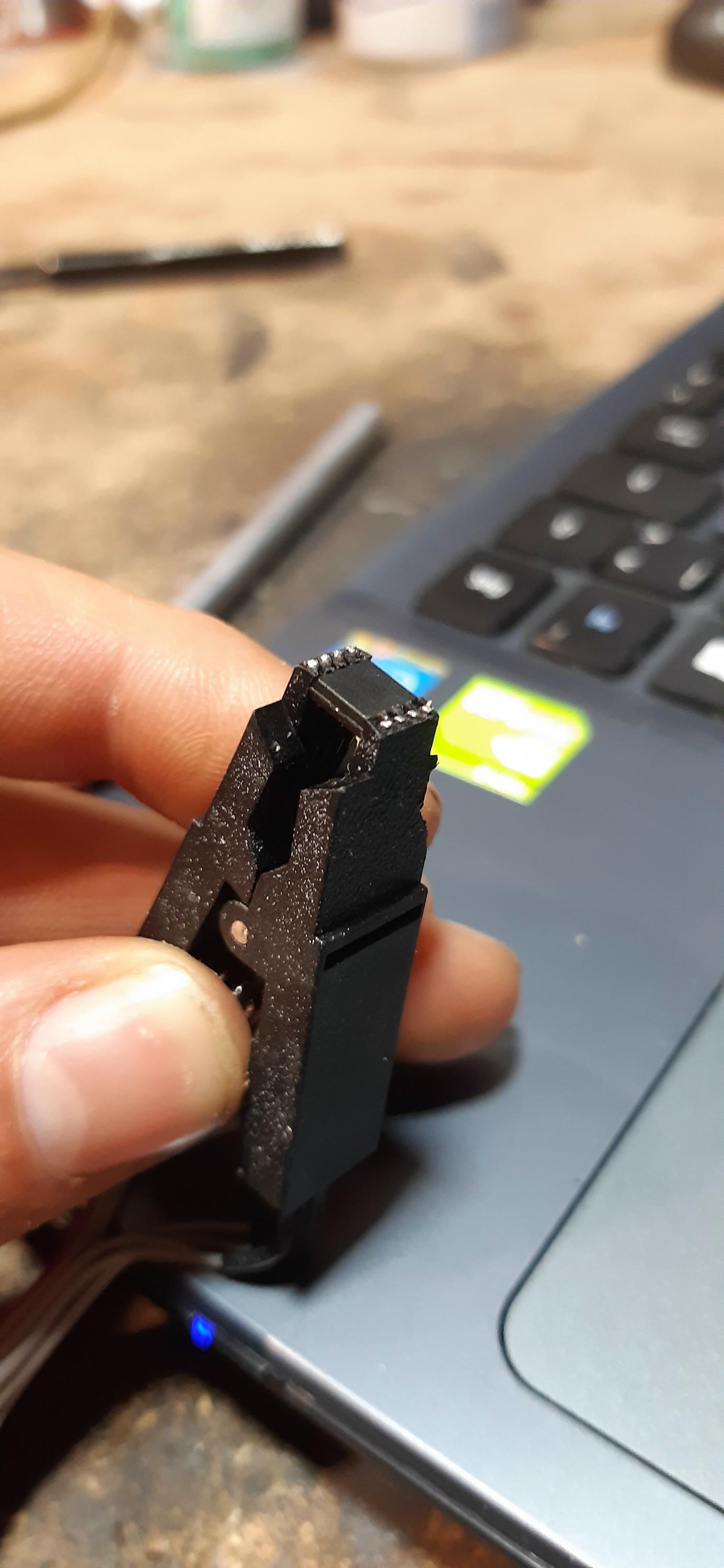

          • 20648
          Your original bios is too corrupt,did you backup using a clip or desolder it.If you`re using a CH341A try some alternative software,and buy a new bios chip,one thats in the supported list.

          • Jovica123
            • Oct 2017
            • 75
            • N/A
            Re: Toshiba l50-b-2cr
            I made a mistake,i desolder it and then used a clip,i will post a picture how i did it.I have rt809h programmator,and this is not my first laptop on which I programmed the bios.I sucessfuly unlocked lenovo t440 and yoga 3.
            On lenovo laptop you must have original bios bin file,but on these laptop hp,dell,toshiba it can work when you download from internet.
            I don't understand why on this laptop is black screen.
            I found winbond W25Q64BV,and I write your file in it "PSKTCE ME_CLEAN".
            Laptop turns on but black screen.
            It is not at all clear to me why this is happening.
            Please answer to me,thank you !
            • Jovica123
              • Oct 2017
              • 75
              • N/A
              I managed to fix it.
              The problem was in flash.
              I write bios bin file from this link on winbond W25Q64: https://www.badcaps.net/forum/showth...dmb8e0+rev%3Ae
              Post #6
              Thank you my friend for your help !
