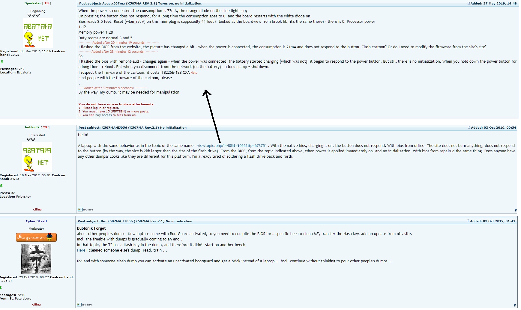

              Not working for me. It got better (battery started charging, all voltages are present, but cpu is just getting warm and no display, it reacts to power button too). Attaching backup dump.

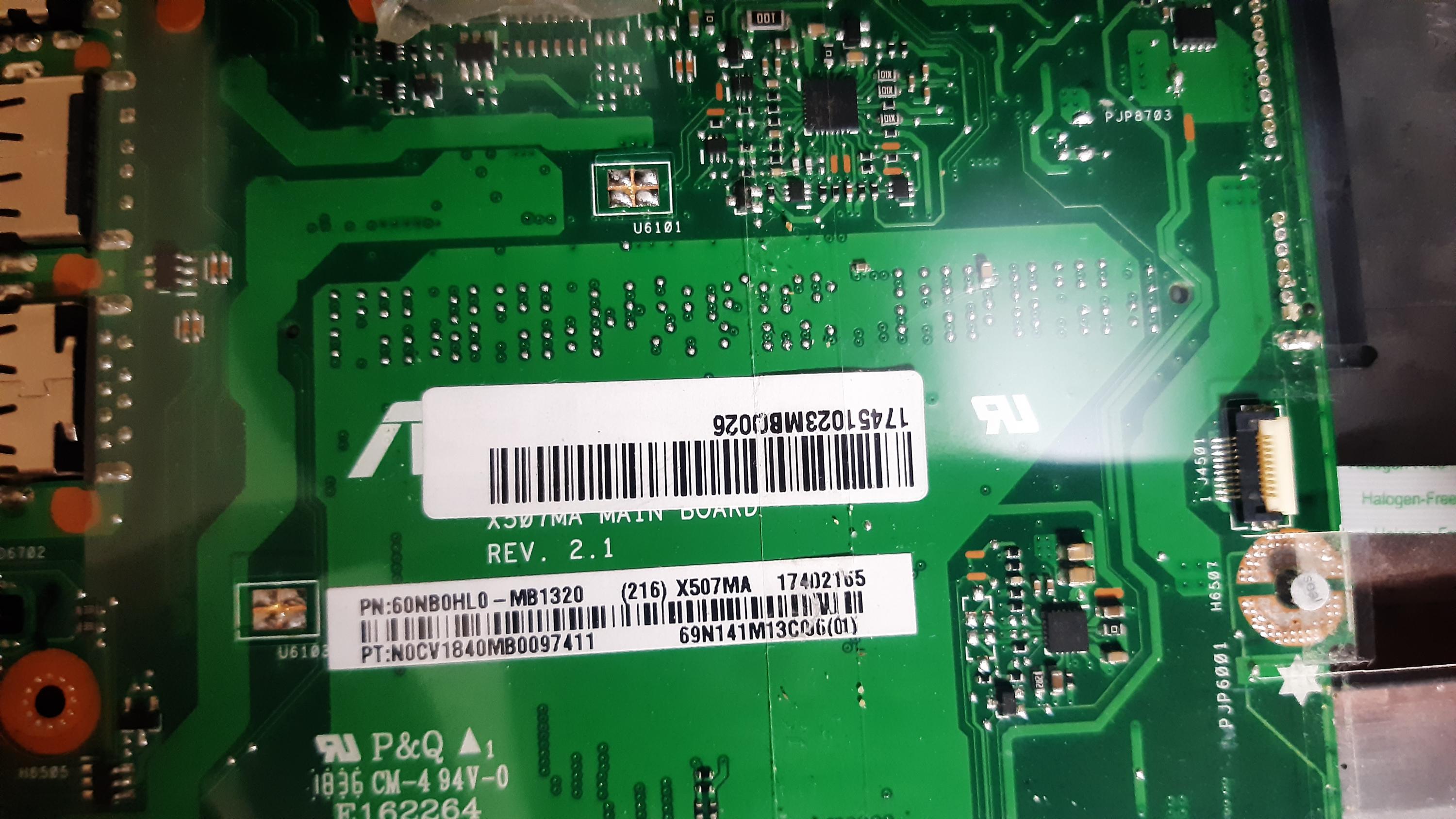

                Post a picture of the long white barcode sticker. It will have a model number on it. Like the ones in this thread https://www.badcaps.net/forum/showthread.php?t=96604

                    for this laptop the bios from post # 2 should work, the bios you posted is longer ... maybe you typed the bios with errors ... try writing the bios chip again ..

                      Tried again today, no luck.
                      I found some intersting posts from other forum (in attached image). First post got the problem solved with some other bios which i can't try, because I can't access the link (not a member of that forum).
                      But symptoms are identical.
                      Also tried to swap RAM, as sometimes similar issues can happen with bad RAM.

                                • honglongyb
                                  • Jul 2015
                                  • 12
                                  • viet nam
                                  can you rebuild this my original file ,led power is appeared but not power on ..thank alot
                                • hoaca388
                                  Badcaps
                                  • Jan 2022
                                  • 12392
                                  Serial number ?
                                  • honglongyb
                                    • Jul 2015
                                    • 12
                                    • viet nam
                                    Originally posted by hoaca388
                                    Serial number ?
                                    machine name x507ma-br211t
                                    board x507ma rev 2.1
                                    sn JAN0CV11L001438
                                    THANKS
