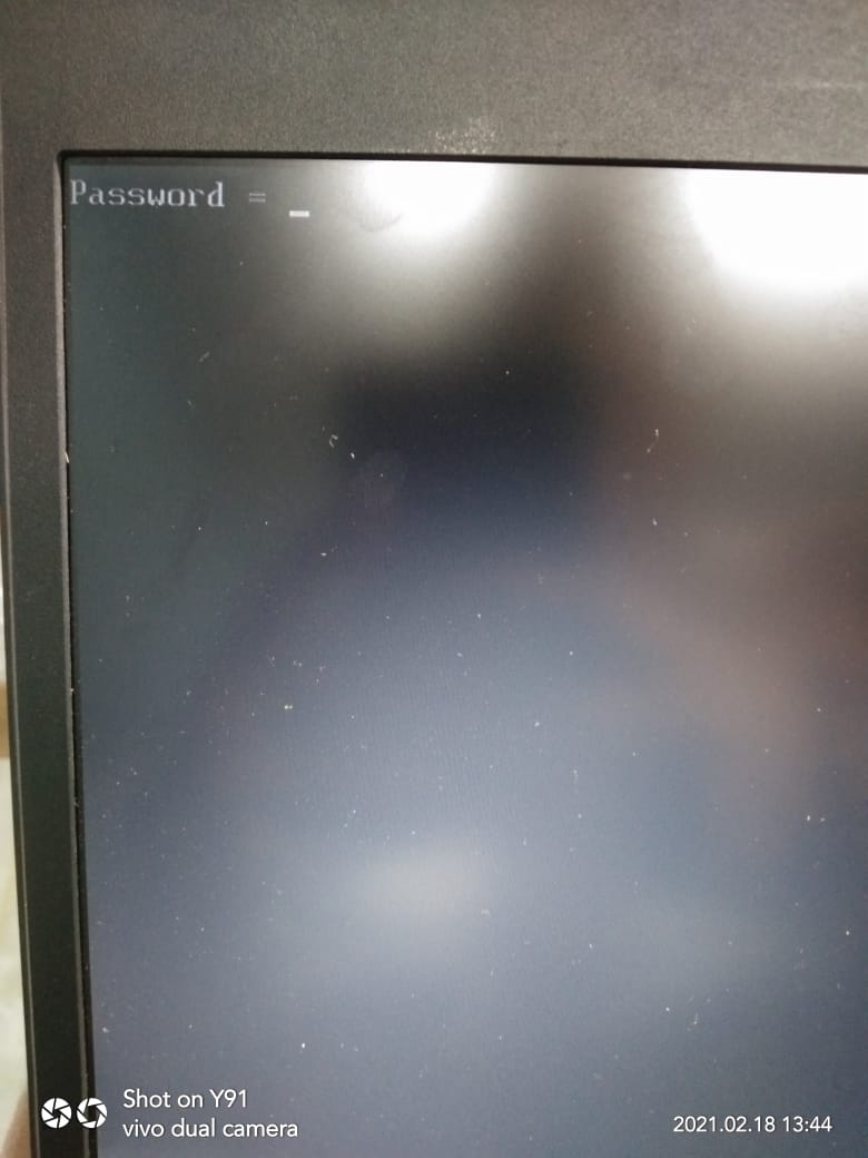

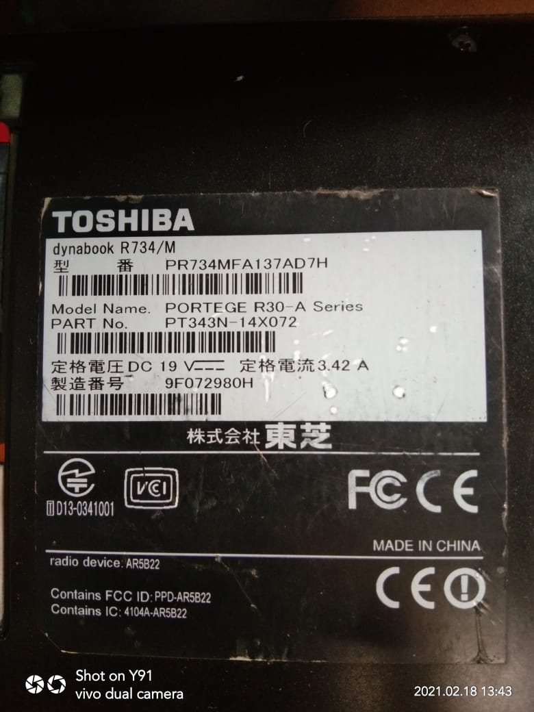

                Re: Toshiba Portege z30 password
                anyone can help me with my Dynabook R734/M
                Model name: Portege R30-a series password?
                Serial: 9F072980H
                attach pics for model
                  @jhuztine2881
                  At the password prompt, press these 4 keyboard keys in sequence:
                  CTRL-TAB-CTRL-ENTER
                  You will get a Challenge Code and the computer Serial Number, asking for a Response Code.
                  The Challenge Code changes on every reboot, so if you are going to request a Response Code, make sure you keep computer powered on while you wait.
