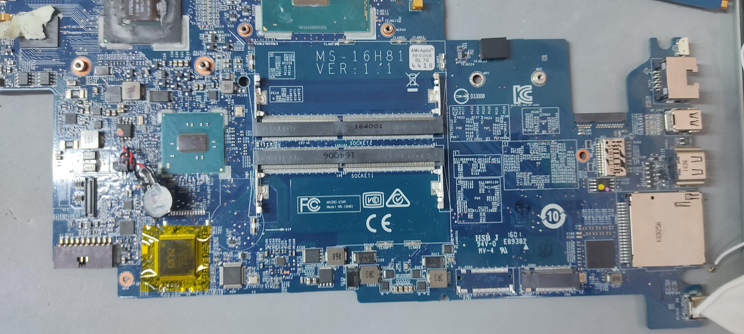

    I need help with my msi. First he don't turn on so i change a dead mosfet (SM7302ESKP QFN-8) and worked!!!
    The pc turn on, its all ok, but now black screen...
    Can somebody get me the bin files?
    Motherboard: MS-16H81 Ver: 1.1
    Processor: V638A409SR2FQ
    Graphic: NVIDIA n16p-gx-a2

                    MSI MS-16H81 Bios
                    The SR2C4 intel chipset of Msi MS-16H81 has changed. With current bios it stays at 0.17ma, no display. If someone can clear the bios, I would be grateful. Or if anyone shares a clean bios, the room will do our job.

                        Model No; MS-16H8
                        Msi PX60 6QE
                        Mainboard ; MS-1681 Rev:1.1

                            I tried the bios shared on their site. I need to clean my bios or find a clean bios because south chipset has changed. So I shared the original bios.

                                I tried the bios you posted but the result is the same. It stays at 0.17 ma, no image.

                                  The new SR2C4 turned out to be faulty. When I changed it again and wrote clean bios, the image came.
