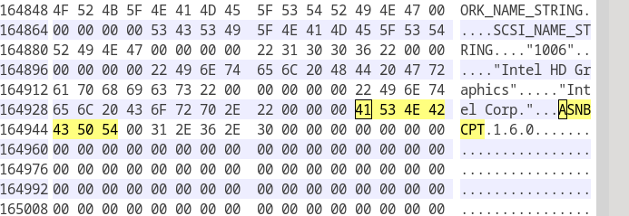

        Hello. Can anybody help me fix my bios for a Dell Precision 7740, LA-H281P, service tag BKLWL13. It turns on to a black screen. Thank you

              I am unable to write to the chip even though I can read and erase it. The software hangs up as soon as I try to program using both Neo and AS Programmer and on two different computers. Do you have any idea what could be happening?
              The chip is GD25B256DYIGR, and I have the black Ch341 board with the 3.3 V Mod.
              Thank you

                Nvm got it to write. The Bios file worked... Thank you very much!

                  My Nvidia Quadro RTX 4000 GPU isn't being detected in the bios or Windows. Could it have something to do with that bios file? I don't see any bios settings to enable it.

                    #29
                    Hello, if I were you I would try to update the last known BIOS from Dell, it should be version 1.31.0.
                    I seem to remember that your BIOS was very old with 1.6.0. By the way, Dell doesn't officially have this at all.
                    There is 1.3.2 and 1.8.2 but no 1.6.0
                    That might solve your problems.
                    It's difficult to evaluate from a distance.​

                      #30
                      I did update it to 1.31.0 last night, along with all the other updates from Windows updates and the Dell support site for this device. I just can't install the Nvidia driver. That's weird about the old bios. I can't explain that.
