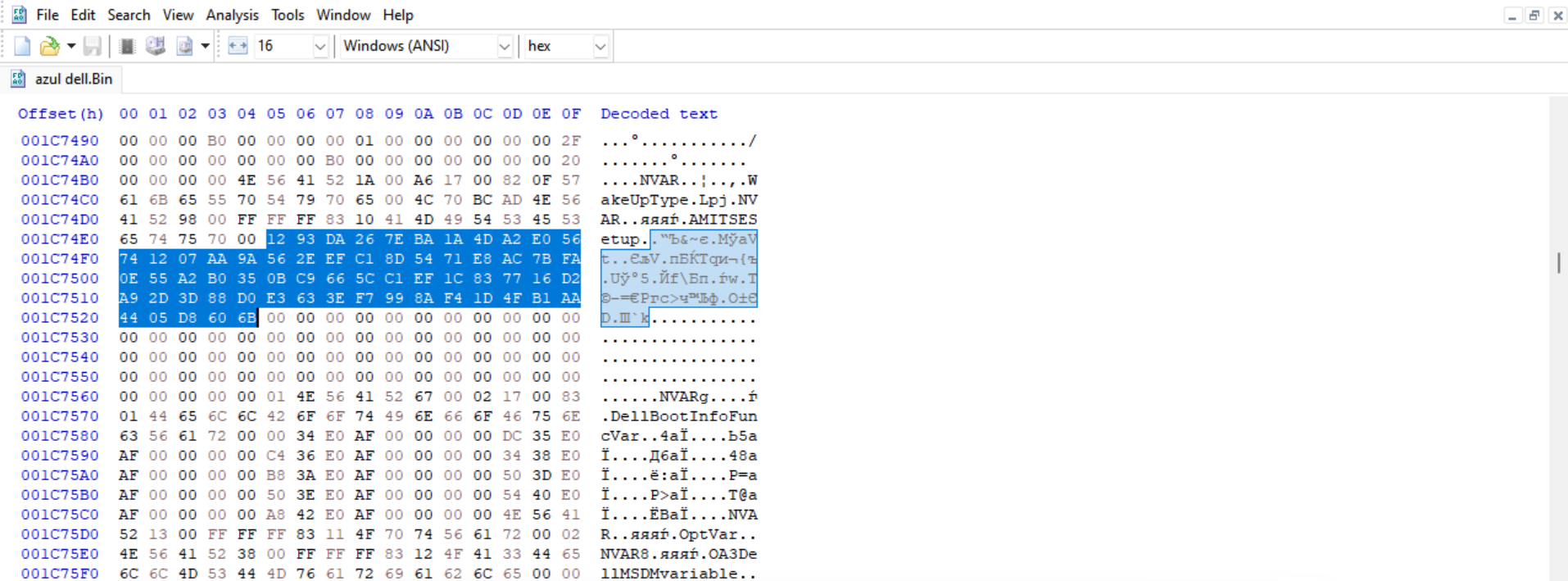

      Need bios Inspiron 5555 (AAL12 LA-C142P)
      Hello everyone !
      Does anyone have the bin for this laptop? I already tried more than 10 that are in other posts and none works for me, the screen stays black! my bios has administrator password service tag!

        Re: Need bios Inspiron 5555 (AAL12 LA-C142P)
        Originally posted by wizarddvs1
        Hello everyone !
        the processor is amd e2
        Wow - more than 10, you did a lot of work, didn't you? But you should have asked for help here before that, you would have saved yourself those headaches.
        The password is Ilovetoread53
          check previous post and check all the bin but none worked! if it was a headache, maybe i'll pay someone on ebay to unlock it
            I didn't understand exactly what you were trying to say ... anyway.
            Did you tried the password or what?
              yes, it didn't work
                yes, it didn't work
                This is surprising because the password was obtained from the dump you provided. Are you sure you are entering it correctly? The first letter is uppercase and the others are lowercase. What is the keyboard layout? Try with external US layout keyboard.
                  I'm sorry I was wrong, it worked perfectly! Thank you very much !
                  May I know how did you know? did you use any hxd editor
