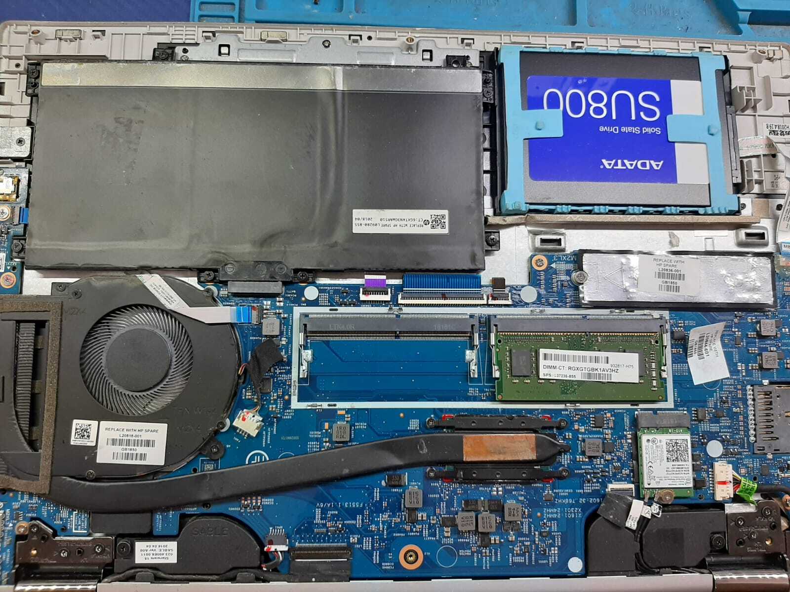

            please my model number 15-cr022n1g, no post. hoping someone can help me fix this. thank you
              try and let me know.

                Re: Hp paviollon x360 15-CR0087CL BOARD: LEIA_15 KBL UMA 17881-1B
                okay sure brother, it is working so now I will have to write the other data on the bios...it is in unlock mode now....Thank you so much
                  is this file is your original? because you said its model number (15-cr022n1g), but in your file is the model number (HP Pavilion x360 Convertible 14m-cd0xxx)
                    yes I am sorry, i guess the bottom case is changed

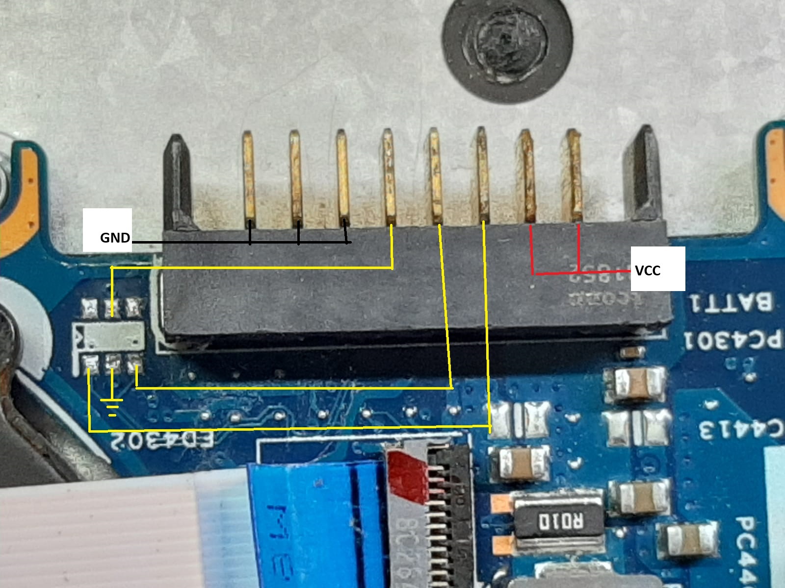

                          Hello friends, I have this same laptop which would not turn on, I detected that the 3v and 5v source circuits were damaged and a 6 pin circuit in short, which I suppose are diodes, I'm not sure since there is no diagram, I removed this circuit and the sources and there is no longer a short, the new 3v and 5v sources were installed and the laptop now works, the problem is that I don't know what this 6-pin circuit is, I think it has to do with the battery, since the operating system does not detect the battery, I measured the IC pins and they go to these pins of the battery connector, does anyone know what type of circuit it is? I lost the original circuit and I no longer have it to see the license plate, thank you
