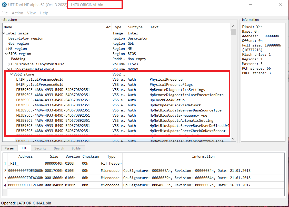

Hello, it looks like your original BIOS is damaged, I can't create a patched file from it.
Attempt to read the BIOS file at least 3 times and compare them so that they are identical.
"IMPORTANT: Before applying the patch make sure you verify that your original image is not corrupted by dumping 1 or 2 additional images from your bios chip and comparing them.
The original dump is THE ONLY WAY to recover your machine if something goes wrong!"

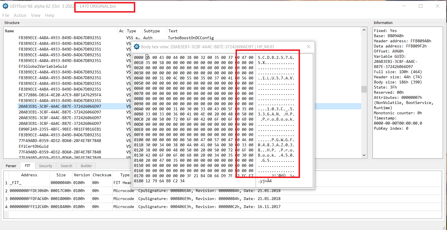

The file he posted is from an HP ProBook 450 G5

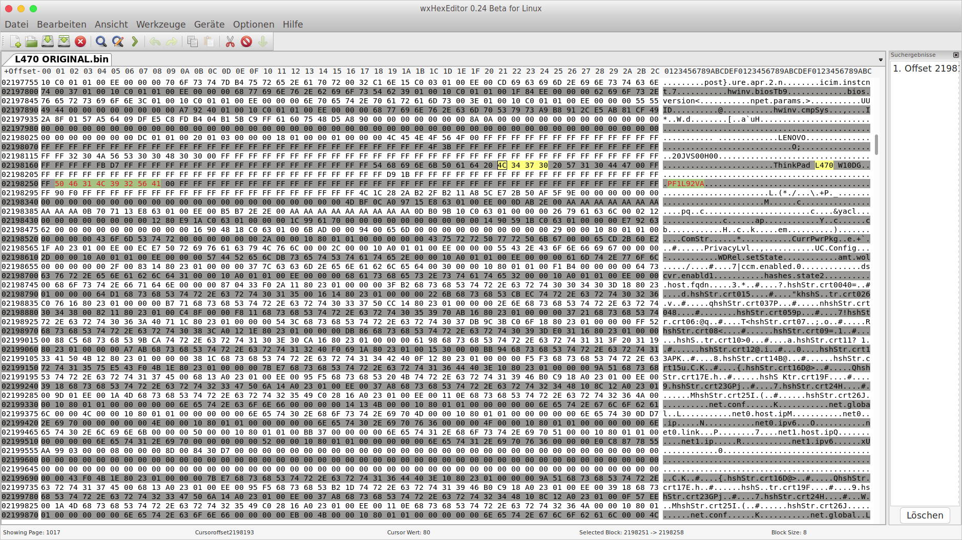

Your information is not wrong, don't know what he did before but that file has a part in the bios region that belongs to HP, the rest is from Lenovo.

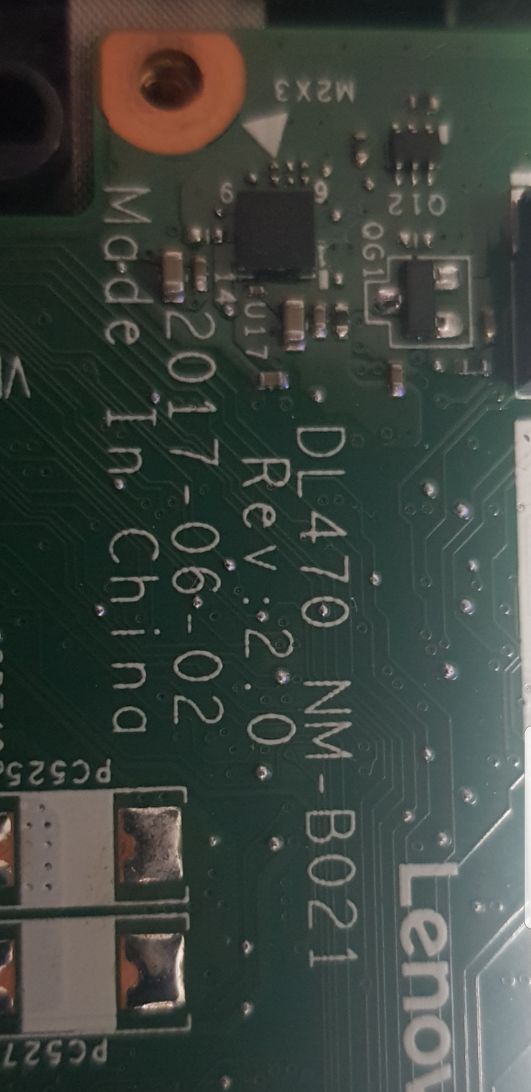

the model number of motherboard is
DL470 NM-B021
the main problem of the laptop is that its freeze or hang whenever its on POST it does not boot to operating system
DL470 NM-B021
