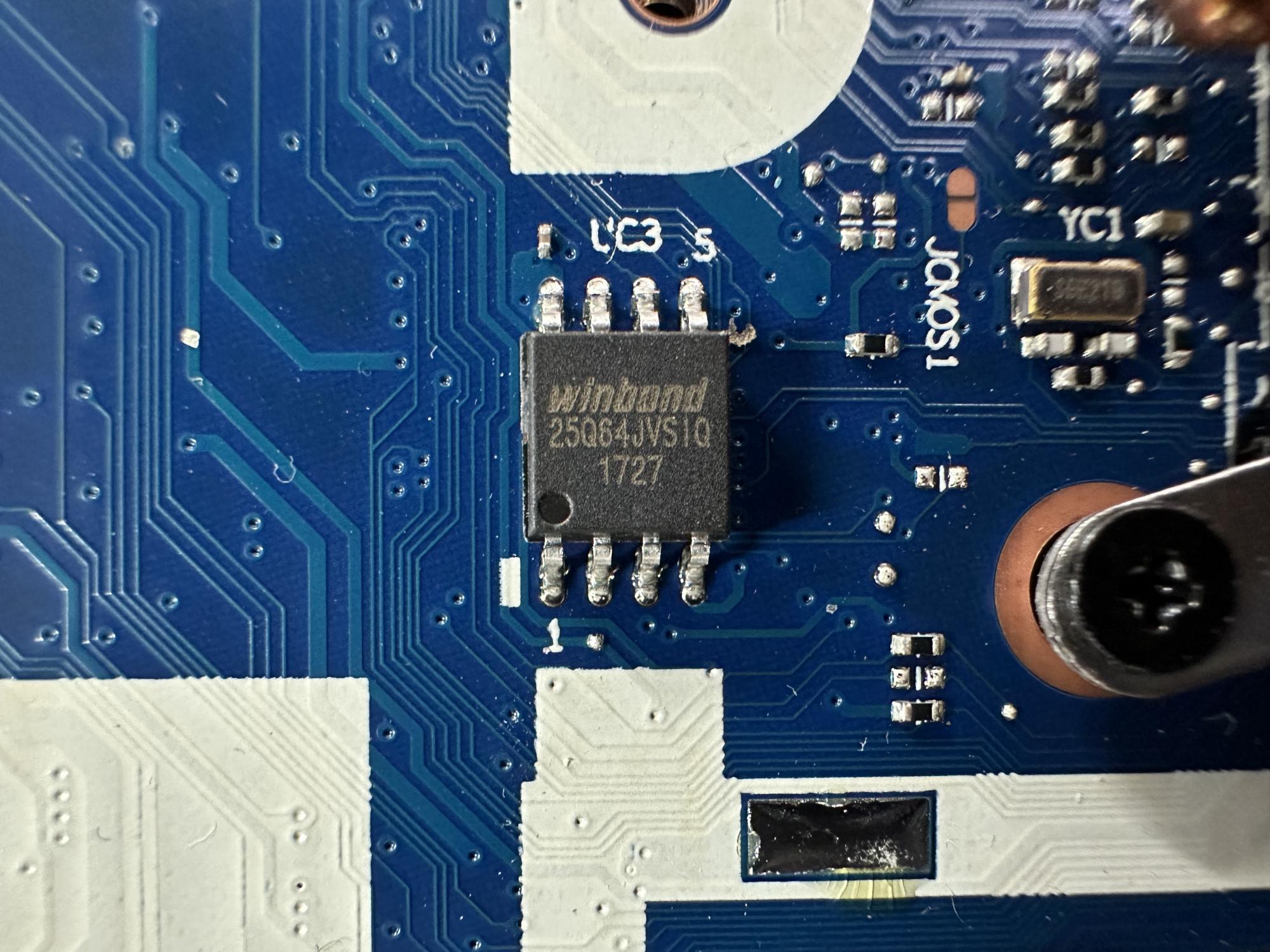

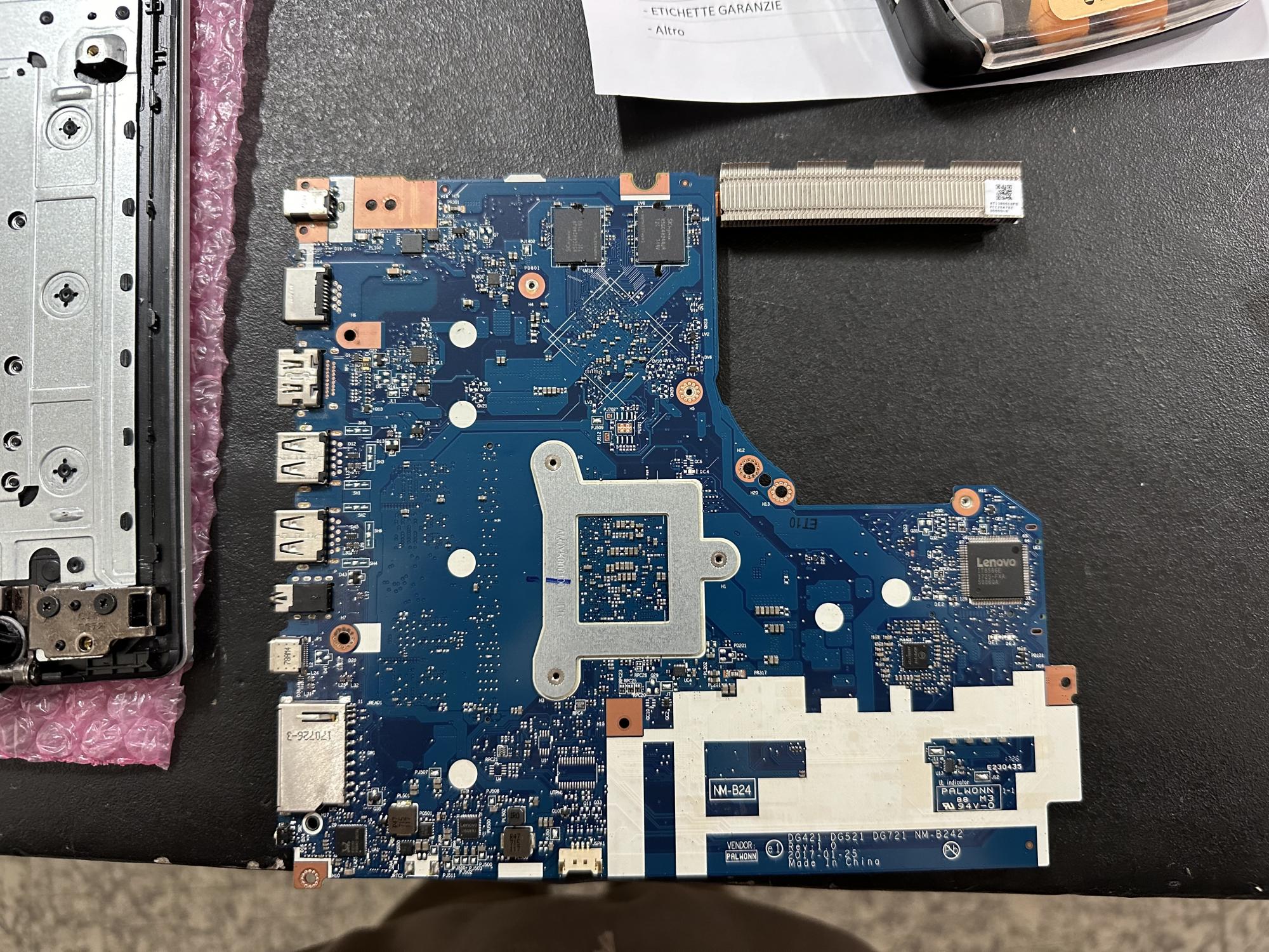

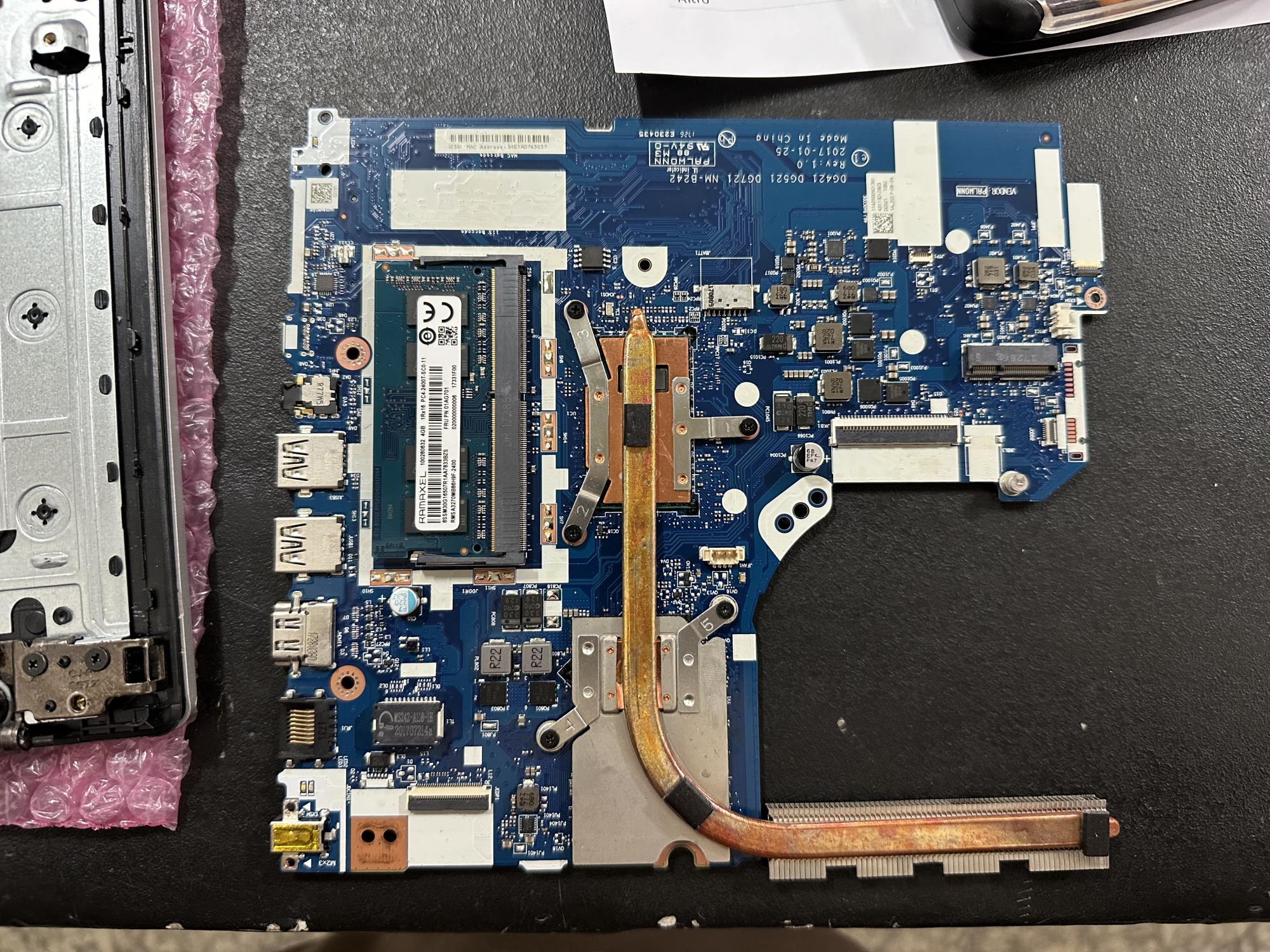

            Hi! I think i have a Lenovo 320-17IKB. There is a sticker but ther is no information about product or serial number on it..
            The laptop powers on for 3 seconds where the screen seems to go on, cpu fan is going and power led is on but for no reason it powers off.
            After disconnect all of the components that may be halting the power on, i think is a bios related problem.
            Is the first time that i try to programm a bios, i just bought a CH341A usb programmer BUT i think i MAY be wrong about the bios chip.
            Can someone tell me what the chip is? I think is the WinBond 25Q34JVSIQ but i'm wrong?
            The modo is a DG421 DG521 DG721 NM-B242 Rev.:1.0 2017-01-25 with vendor:PALWONN.
            Thank you so much!
            (i posted on old thread but i don't know how to delete it, i'm sorryy)

              You look for any chip with the number 64 on the back. Ex: q25w64..
                On the back there is nothing. On the top there is the chip that I mentioned before. I attach some photos. Thank you so much for the help!
                The third photo is the chip that I think is the BIOS.

                  Sorry, here there are the photos.

                    There it is

                      At first I was certain that it was right but then I saw it was near the GPU and i thought that i find the wrong chip 😭
                      Tomorrow that comes the programmer, what are the steps that I need to follow?
                      Read, save the readed config, and then? Is my first time doing it, I readed a guide online but if the bios file is broken how do I repair it? 🥺
