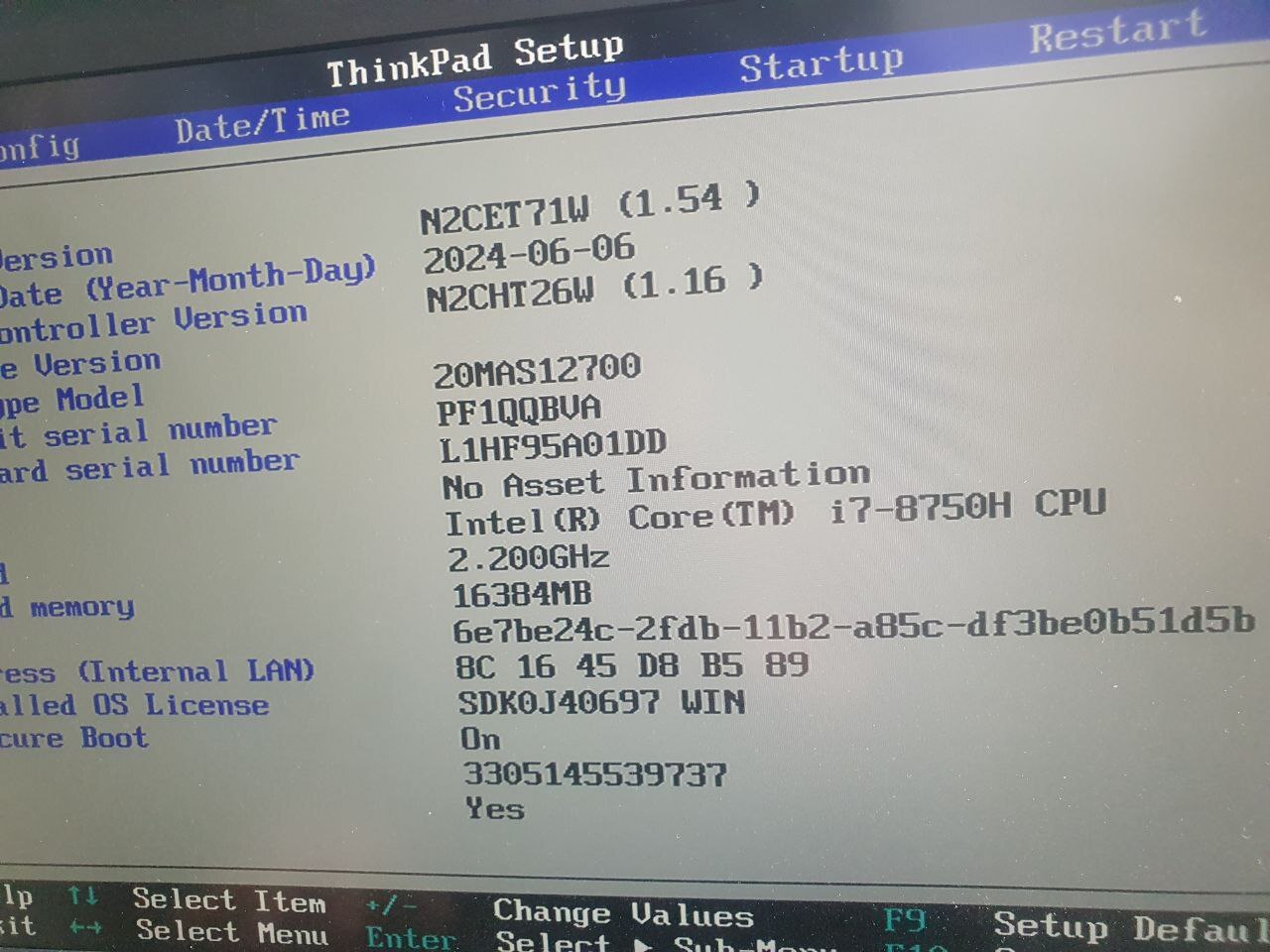

need remove password lenovo p52
  • Boergelund
    • Sep 2024
    • 3
    #41
    I've got the same Problem with my P52. When I flash the autopatched file i get this melody and the screen stays black. Maybe someone could help with my file?
    I attached both the original and the patched file. After reflashing the original dump the system starts with a locked bios.
    S/N: PF-1MPWM5
    TYPE: 20MA-S35Y00
    thanks in advance​
    • peste
      • Dec 2016
      • 12521
      • ROMANIA
      #42
      Originally posted by Boergelund
      I've got the same Problem with my P52. When I flash the autopatched file i get this melody and the screen stays black. Maybe someone could help with my file?
      I attached both the original and the patched file. After reflashing the original dump the system starts with a locked bios.
      S/N: PF-1MPWM5
      TYPE: 20MA-S35Y00
      thanks in advance​
      try..
      • dejankeke
        • Jun 2016
        • 17
        • serbia
        #43
        Originally posted by dejankeke
        hello everyone, I have a lenovo p52 with a bios password, I tried with the autopecher but after starting with patched bios, I heard the melody and there is no picture on the screen.
        in attachment i put original and patched bios, please help.
        Lenovo P52 cpu i7-8750H
        type 20M9-001GMX
        SN PF-1F15RS
        Has anyone solved the password problem in bios with lenovo P52. Autopacher does not work, a melody is heard when the laptop is started with a patched bios and now picture on screen.
        in post 36 I posted both bios files.
        • Boergelund
          • Sep 2024
          • 3
          #44
          Originally posted by peste
          try..
          Thank you Peste for your effort and the quick reaction but unfortunately the new bios with autpatcher isn't working.
          I read somewhere in the forum that the Macronix chip could be the problem.
          • osman68i
            • May 2015
            • 338
            • The Netherlands
            #45
            P52 is mec1653 check post 36
            • mielta
              • Apr 2015
              • 368
              #46
              Hi
              Can everyone Patch the orginal File from Lenovo P52
                • 20581
                #47
                Originally posted by mielta
                Hi
                Can everyone Patch the orginal File from Lenovo P52
                Post moved to P52 thread topic. Post the laptop serial number
                • mielta
                  • Apr 2015
                  • 368
                  #48
                  Originally posted by SMDFlea
                  Post moved to P52 thread topic. Post the laptop serial number
                  Serial number is PF1JTKAC
                  • LBTT1121
                    • Nov 2024
                    • 467
                    • Việt Nam
                    #49
                    Thinkpad P52 Type 20MA-S21700
                    S/N: PF-1QQBVA 19/06
                    The latest BIOS update on the Lenovo homepage is not displayed. Can you help me fix the bios, thank all​
                    • minhdigital
                      • Nov 2022
                      • 737
                      • Vietnam
                      #50
                      Originally posted by LBTT1121
                      Thinkpad P52 Type 20MA-S21700
                      S/N: PF-1QQBVA 19/06
                      The latest BIOS update on the Lenovo homepage is not displayed. Can you help me fix the bios, thank all​
                      Try
                      • hoaca388
                        Badcaps
                        • Jan 2022
                        • 11530
                        • Viet Nam
                        #51
                        Originally posted by LBTT1121
                        Thinkpad P52 Type 20MA-S21700
                        S/N: PF-1QQBVA 19/06
                        The latest BIOS update on the Lenovo homepage is not displayed. Can you help me fix the bios, thank all
                        P52 Laptop (ThinkPad) - Type 20MA
                        • LBTT1121
                          • Nov 2024
                          • 467
                          • Việt Nam
                          #52
                          minhdigital hoaca388 bios not displayed . many thank. BIOS UPDATE ver 1.54 download Dell Website ....
                          • LBTT1121
                            • Nov 2024
                            • 467
                            • Việt Nam
                            #53
                            I download bios REV1.0 but it takes 45 seconds to start up and the device works normally. I updated bios ver 1.54 to download from Lenovo website, the laptop does not display the image. It's confusing....
                            I hope you can help me fix the attached clearme file and try it out, thank you
                            • shiyab
                              • Sep 2023
                              • 1267
                              • india
                              #54
                              Originally posted by LBTT1121
                              I download bios REV1.0 but it takes 45 seconds to start up and the device works normally. I updated bios ver 1.54 to download from Lenovo website, the laptop does not display the image. It's confusing....
                              I hope you can help me fix the attached clearme file and try it out, thank you
                              hi try
                              • LBTT1121
                                • Nov 2024
                                • 467
                                • Việt Nam
                                #55
                                Originally posted by shiyab
                                hi try
                                Your bios works fine, but bios version 1.17, when updated to 1.54, the computer does not display it.
                                I have bios version 1.54 running fully functional but booting is 45 seconds slow.
Name:	photo_2024-12-31_10-56-19.jpg
Views:	242
Size:	161.2 KB
ID:	3538428 Can you help me clearme one more time?
                                • osman68i
                                  • May 2015
                                  • 338
                                  • The Netherlands
                                  #56
                                  Originally posted by LBTT1121
                                  Your bios works fine, but bios version 1.17, when updated to 1.54, the computer does not display it.
                                  I have bios version 1.54 running fully functional but booting is 45 seconds slow.
Name:	photo_2024-12-31_10-56-19.jpg
Views:	242
Size:	161.2 KB
ID:	3538428 Can you help me clearme one more time?
                                  me clean
                                  try
                                  • LBTT1121
                                    • Nov 2024
                                    • 467
                                    • Việt Nam
                                    #57
                                    Originally posted by osman68i
                                    me clean
                                    try
                                    Keyboard does not light up
                                    screen is not displayed, 😢😢😢
                                    • minhdigital
                                      • Nov 2022
                                      • 737
                                      • Vietnam
                                      #58
                                      Originally posted by LBTT1121
                                      Keyboard does not light up
                                      screen is not displayed, 😢😢😢
                                      Send to you, try
                                      • Bios White
                                        Learn
                                        • Dec 2024
                                        • 61
                                        • East Laos
                                        #59
                                        Originally posted by minhdigital
                                        Send to you, try
                                        WORKING
                                        • LBTT1121
                                          • Nov 2024
                                          • 467
                                          • Việt Nam
                                          #60
                                          Originally posted by minhdigital
                                          Send to you, try
                                          Bios working , boot 5s, thank for all support
