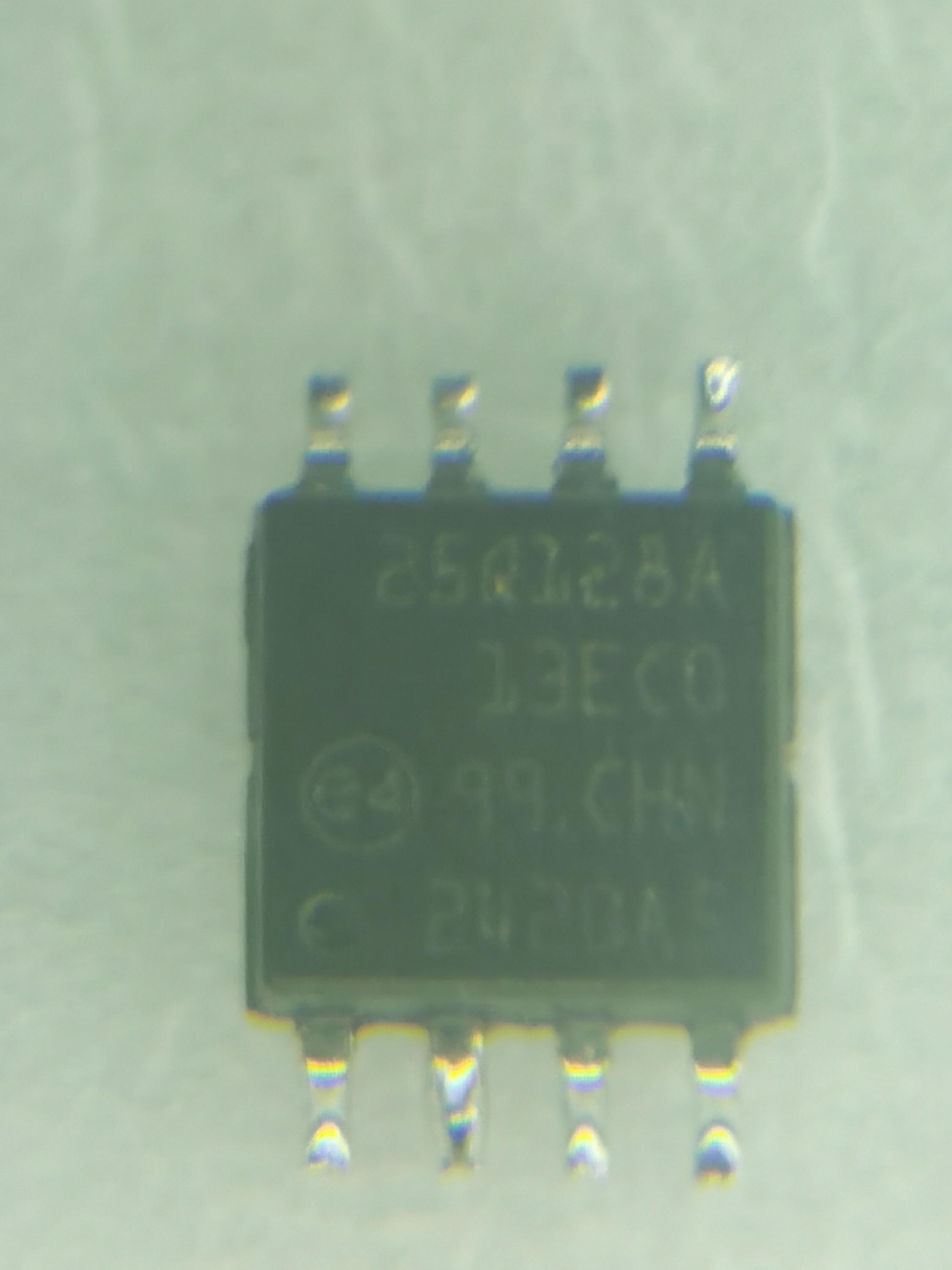

    Hello All,
    I have problem with this type
    toshiba Z30-A
    Code Board : FAUXSY4 A3805A
    the problem is, need twice power on. First laptop can turn on, but no display. then second times turn on with display. Bios Problem ?
    can someone help me to clear me this bios ? here's my backup
    Thanks before

        Try this one .
        • Bonzas
          • 472
          • Indonesia
          Re: Toshiba Portege Z30-A
          Originally posted by SMDFlea
          Try this one .
          Thank Sir, your file working perfectly
          Edit :
          File from peste working only with power adapter, but when i attached battery can't boot on first. i don't know why. I've try couple time to make sure before i use this file

              Hello, i have the same issue, with a Portege Z30-A-1GD, i want to try this bios dump, but my programer (TL866CS) dont have the micron 25q128A, they have others 25q128, any one now any comptible bios to use in my programer?

                hi, in other post SMDFlea, say that this bios is compatible with winbound W25q128Fw1,8v, so i have try read this bios (attached) and i think is blank can any one verify, i have soldered again to the notebook and a 3th try they boot, can any one verify?

                      I have measured the voltage in pin 8 when the notebook is power on, and i have found 3,3v,maybe this why the readers dont work?

                        remove the bios chip from the motherboard before writing or reading, do not use the clip because you may have errors, make a copy of the original bios after reading the chip and check it with the HxD program ...

                          I dont use the clip, i have remove the chip before read, the only think i use is the 1,8v adapter, the programer read without erros but empty, i want to try other bios to test but before i need to backup this.
                          maybe the bios is realy empty, could be possible?
                          I power on the pc, and the lights power on but no image, after a few seconds they automaticaly power off and i power on again and they work normaly, other think is that, they dont detect the wireles lan and the official bios utility dont work.

                            if it works normally after a while the bios chip cannot be empty.
                            write other new chips ..

                              Your bios chip is not 1.8V so don`t use W25q128Fw ,use W25Q128FV to read/write ,untick check ID with TL866
                              THe 25q128A is 2.7V - 3.6V , the N version of the chip N25q128A is 1.8V

                                Ok, thanks,i have try again with the new configurations but in the tl866 only read "0" in the ezp2013 (i select the chip Winbond "w25q128"), read some data, can verify if is correct?
