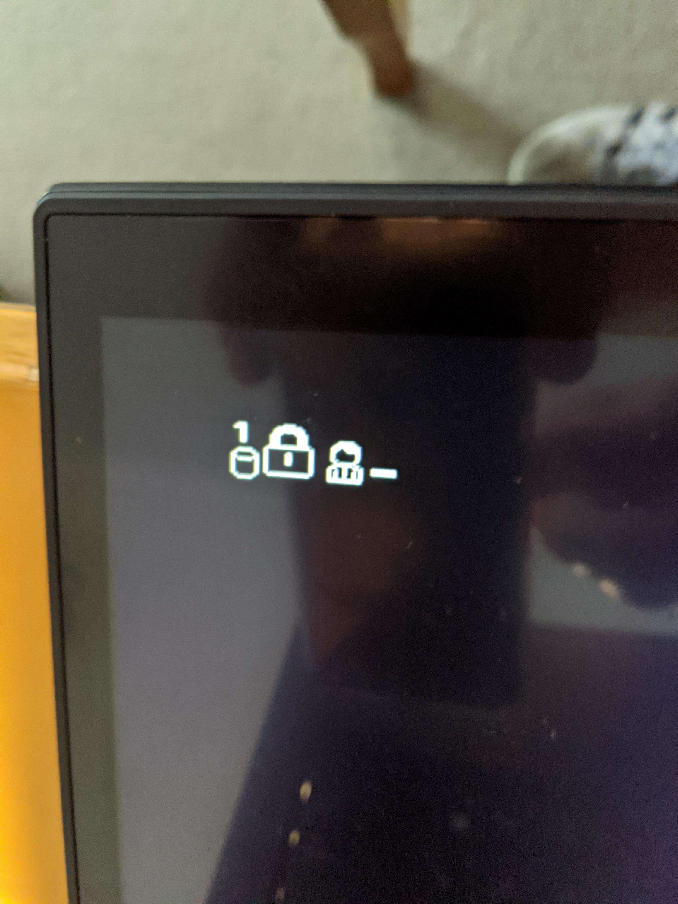

            • Tiberius
              • Jun 2018
              • 10
              • australia
              Re: Lenovo ThinkPad X1 Yoga 1st Gen password
              hi Gayyum
              when i press f1 to go to setup i just get the password login
              see pic
                Originally posted by tiberius
                hi gayyum
                see pic
                type 1234 and enter
                than continue from step 5

                  Hi again
                  yes i do continue and it says tpm reset and shutdown
                  Then i load my original bios file and get the picture above when i press f1

                    did you reached up to step 7 successfully ?

                      yes

                        Remove your hdd and try to enter into bios

                            Hi Gayyum
                            looks like i have a password lock on the hdd
                            it is ok when i remove the hdd - i can go to setup
                            but when hdd is in i cant
                              Originally posted by Tiberius
                              Hi Gayyum
                              its very common for user they have lock in bios and hdd too
                              so your bios is successfully unlocked but hdd still locked
                              after all steps successful done and you still have lock thats why i have asked you to remove hdd
                              replace hdd and you are good to go
                              stil i dont have any solution for unlocking hdd
