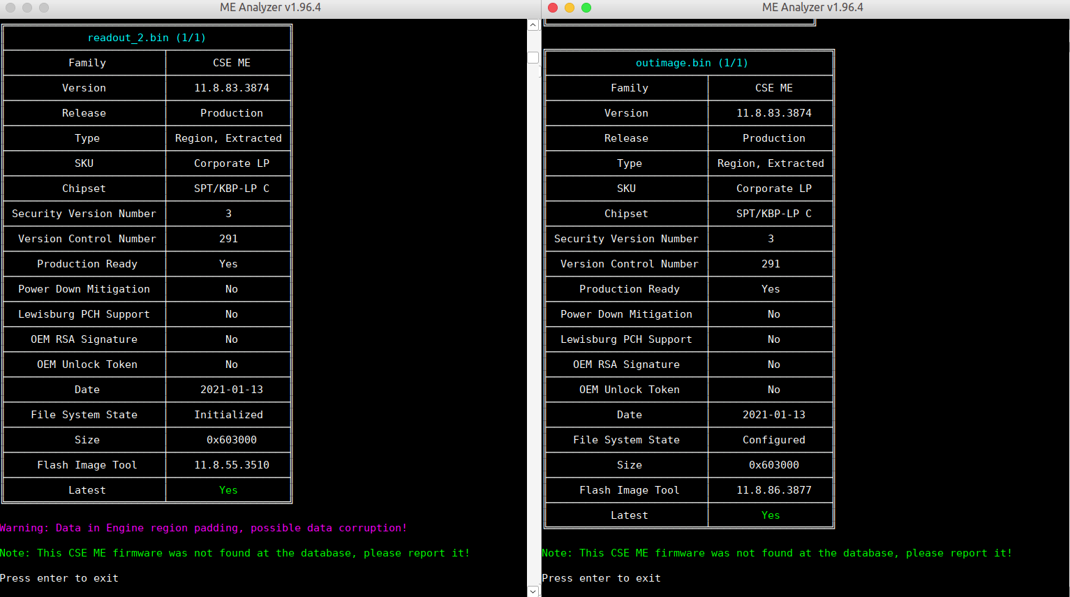

                            I have a x360 1030 G3 and tried to remove the admin password with unlocker.
                            First I made a backup of the MX25L25673G and then flashed unlocked.bin.
                            Then the Laptop didn't boot up.
                            I restored the backup but the laptop won't boot up anymore.
                            No screen, caps lock is lit and after a few seconds a very short flickering of the led.
                            Attached the backup which I restored.
                            Would be great if you could help me. Thanks.

                              #34
                              Re: HP Elitebook X360 1030 G3 BIOS and EC unlock request
                              Hello try this ME Clean file from your orig Backup.
                              Good luck ...

                                #35
                                Thank you so much.
                                Just tried it. Unfortunately it is not working. The power LED on the side is just blinking every second. No other signals.
                                Perhaps you have another idea ?
                                Thanks.
