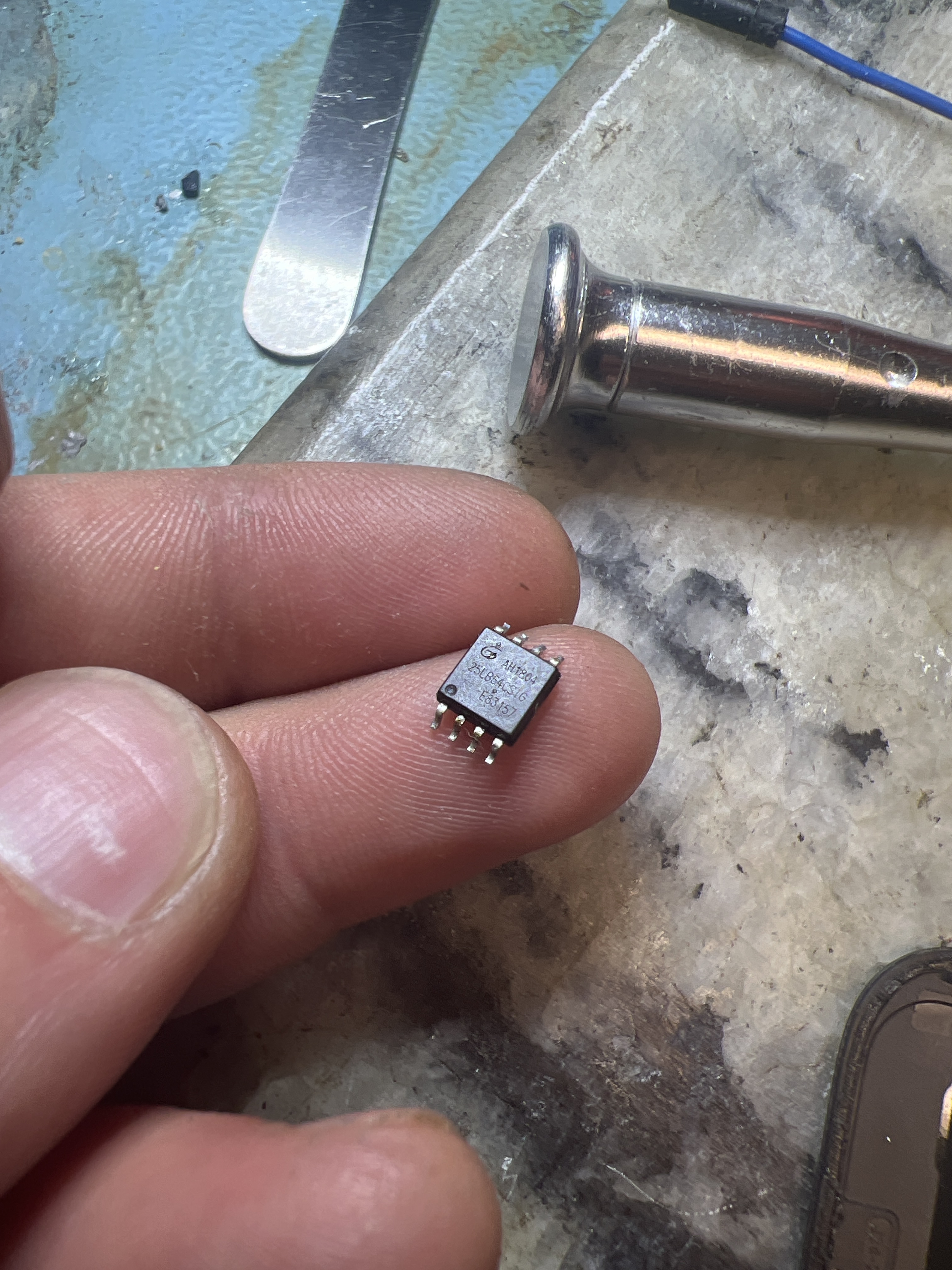

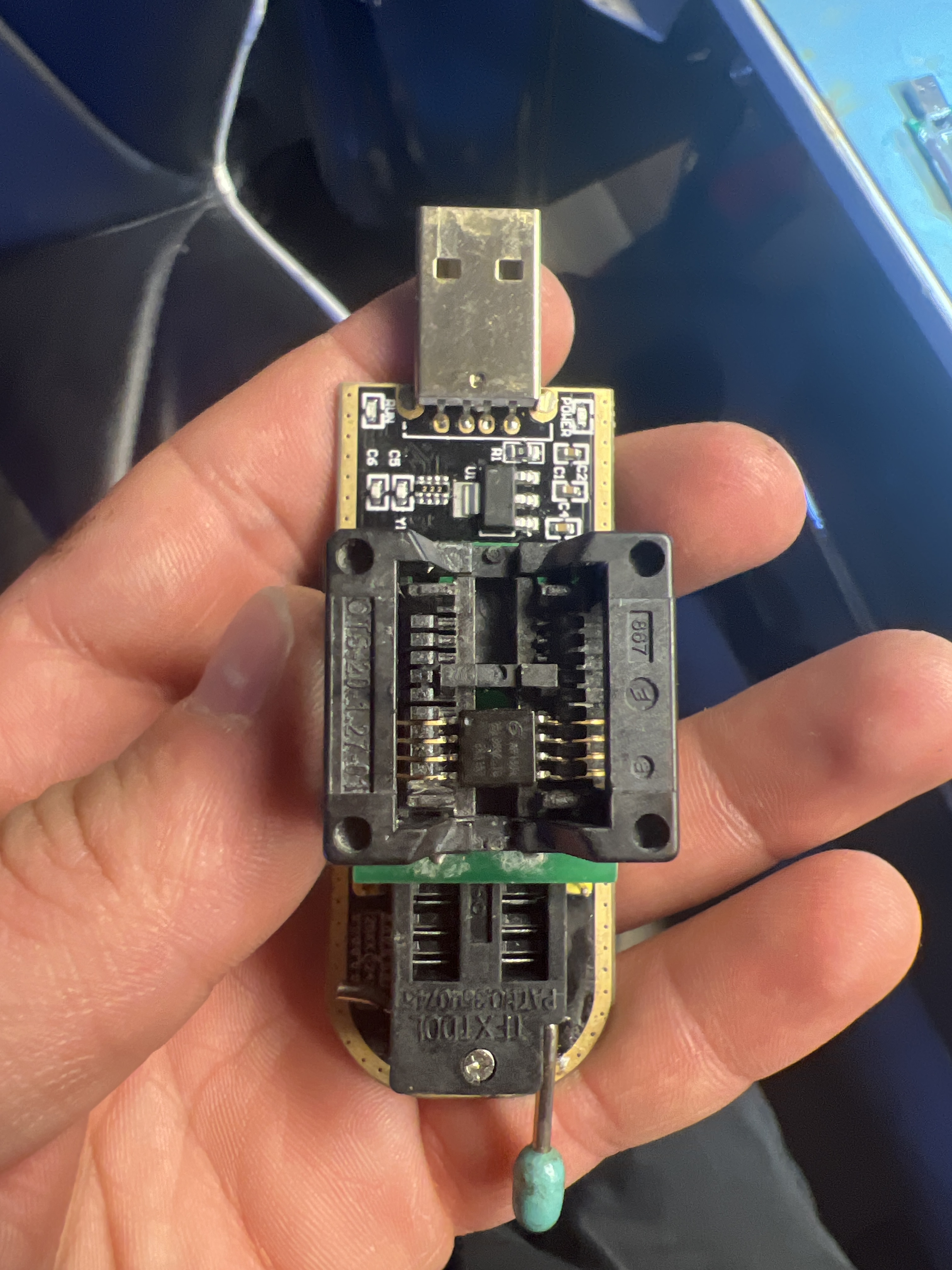

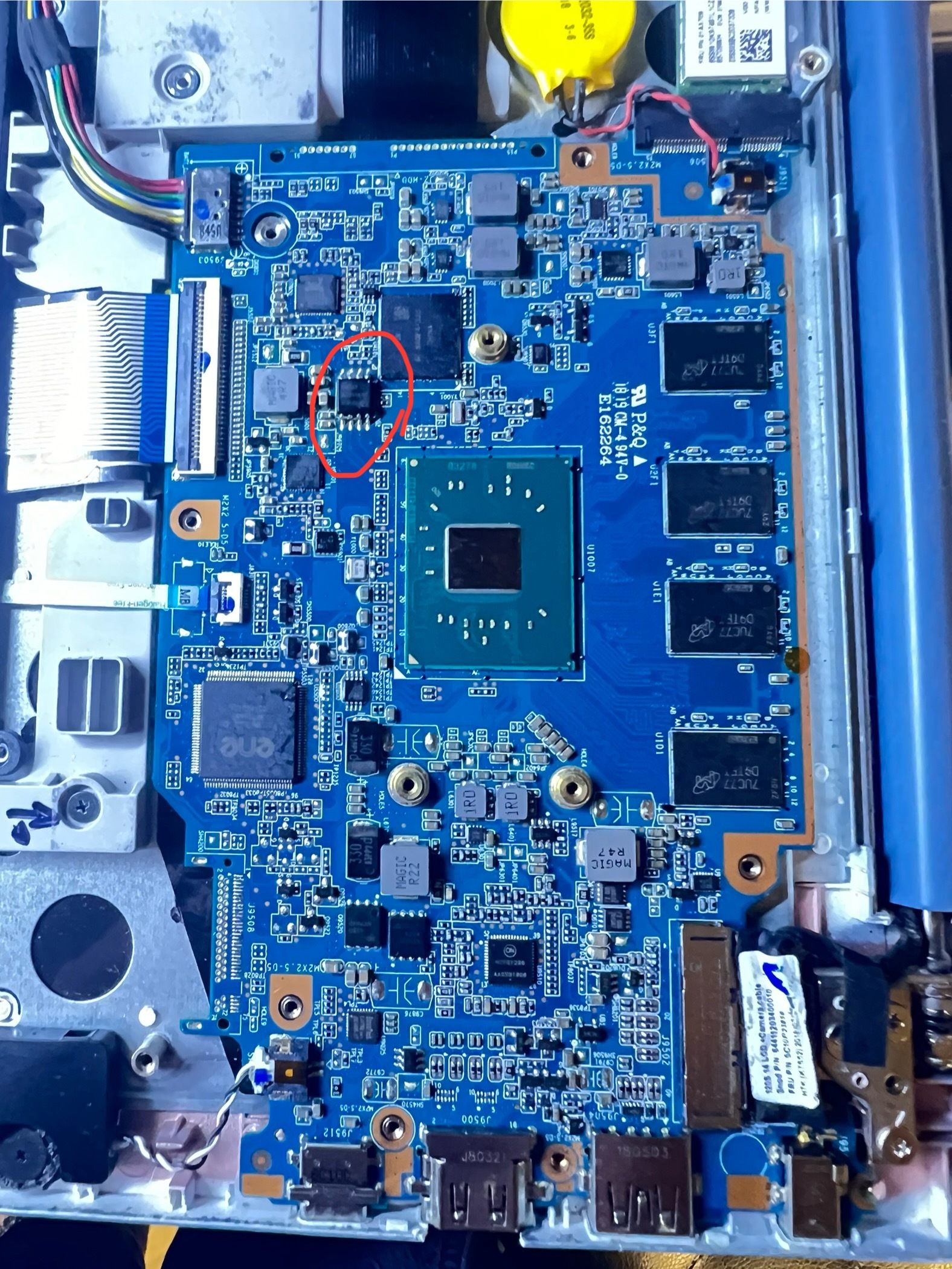

                        Here is the translation:"So the laptop is charging, but the screen is still black :-/ I'm attaching a photo of the motherboard; I hope I'm using the correct chip? Or am I doing something wrong? I'm attaching a photo:
                        It just occurred to me, am I inserting the chip incorrectly into the programmer?"
                        Here is the translation:"So the laptop is charging, but the screen is still black :-/ I'm attaching a photo of the motherboard; I hope I'm using the correct chip? Or am I doing something wrong? I'm attaching a photo.It just occurred to me, am I inserting the chip incorrectly into the programmer?"
                          • 21679
                          Yes.
                          Read these guides
                          https://www.badcaps.net/forum/troubl...=2#post1622421
                          https://winraid.level1techs.com/t/gu...mer/32948/3​
