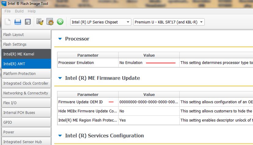

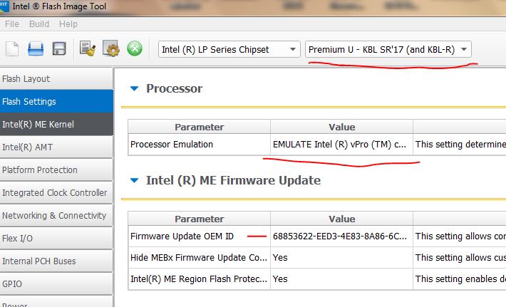

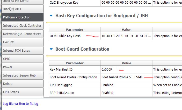

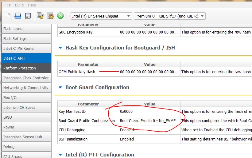

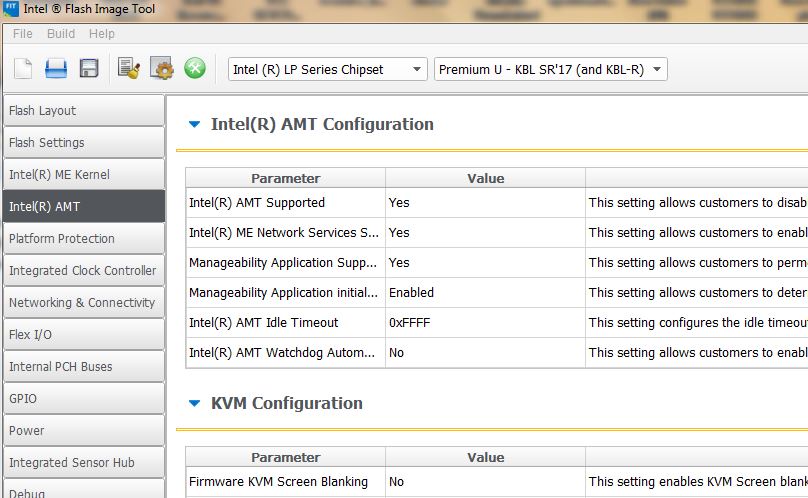

                    @munir100`s system configuration is the same as Post #17 BIOS v1.1.9 Clean ME.zip
                    1. Post #29 ,Emulate vPro enabled, (shipped with ) AMT disabled ,Boot guard 5
                    2. Post #17 BIOS v1.1.9 Clean ME.zip ,Emulate vPro enabled, (shipped with ) AMT enabled ,Boot guard 5 .
                    3. Post #20 No Emulation,No bootguard,No public key hash.
                    Over 350 downloads with no feedback on it.
