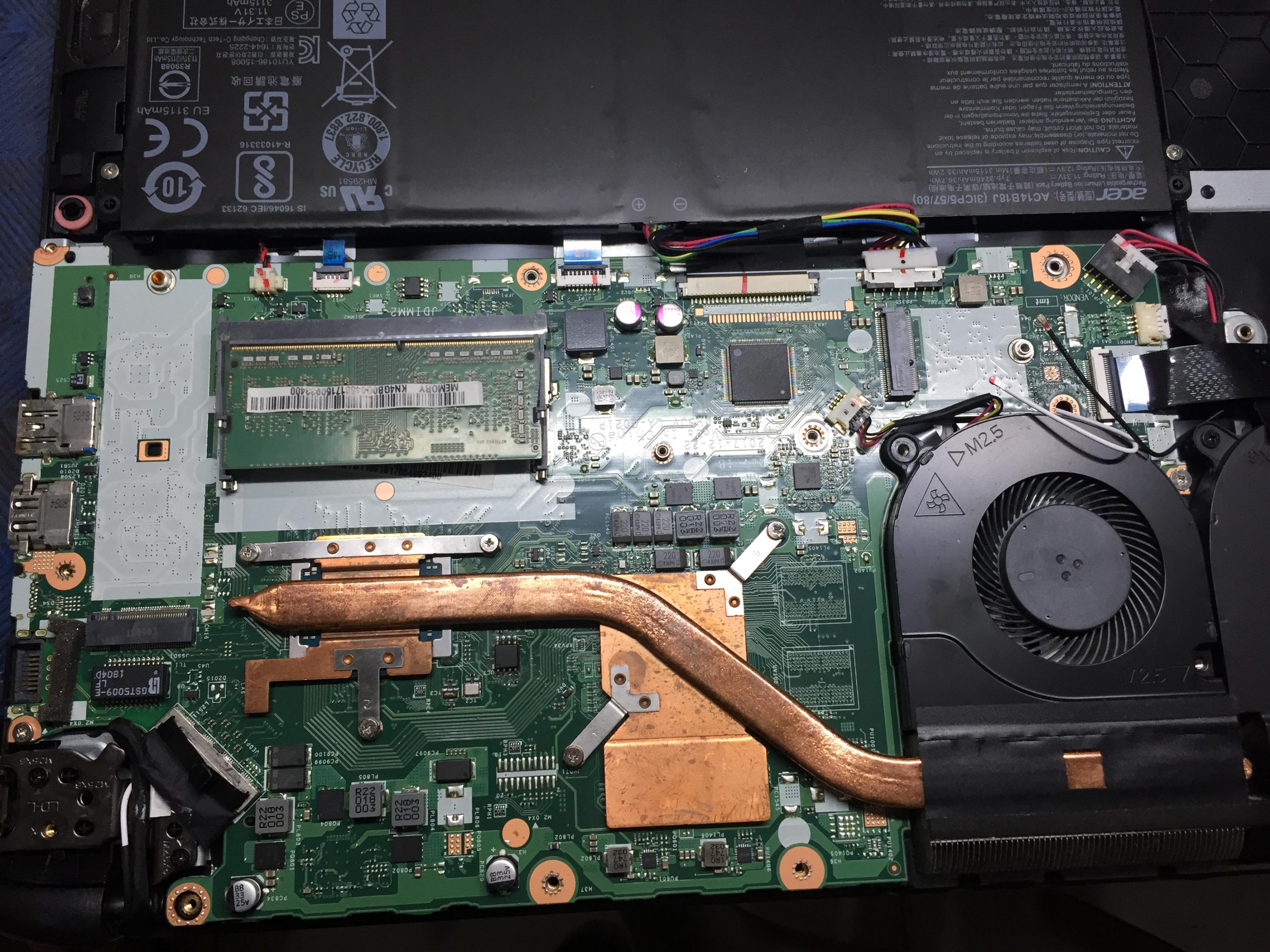

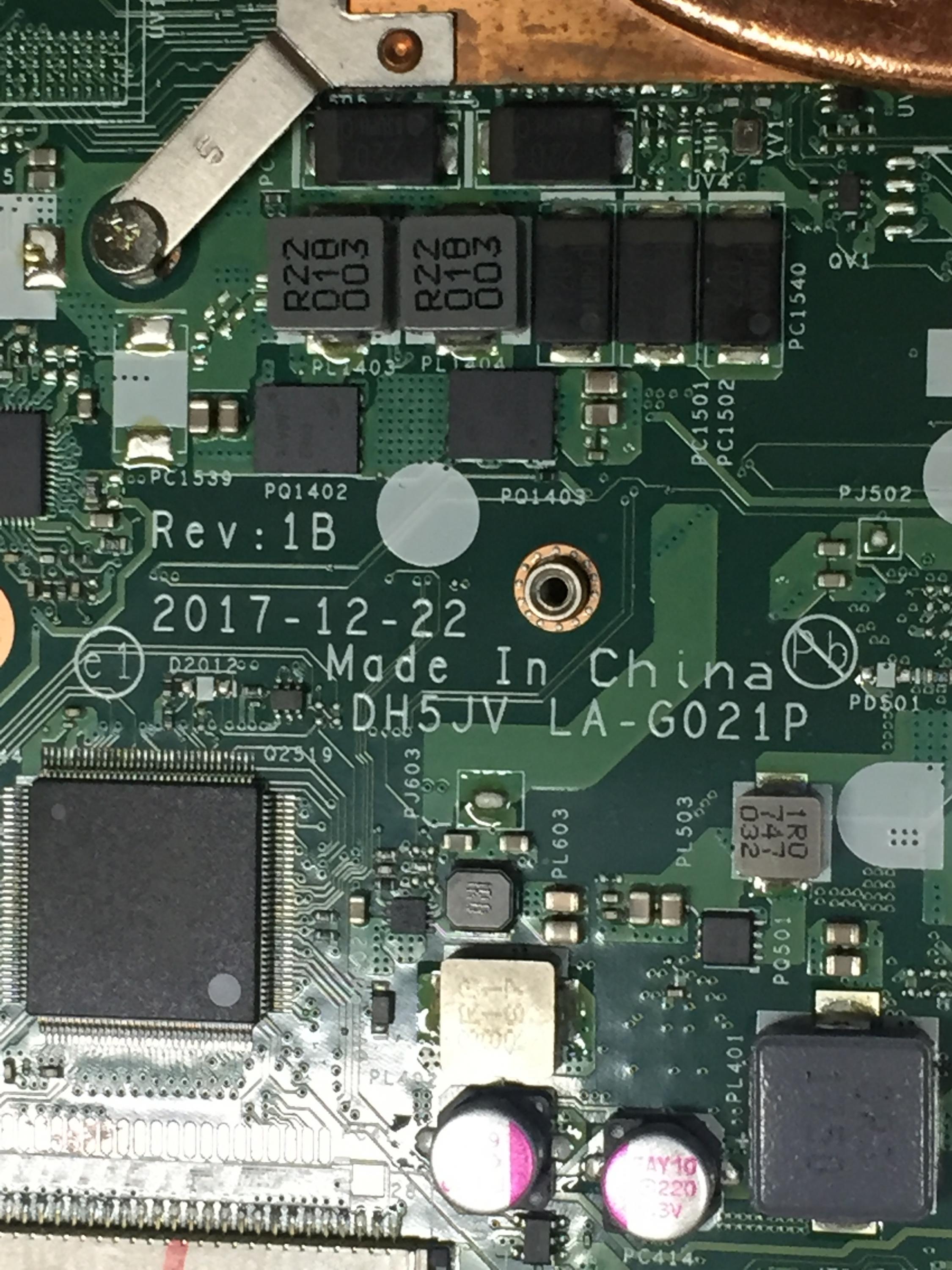

          need bios for acer a315-41g DH5JV LA-G021P Rev 1B
          need working bios dump for dh5jv La-g021p rev:1B
          problem is keeps on restaring every 2-3 seconds no display

              Re: acer aspire 3 A315-41g
              my stock bin file.thanks,,ive already try other bin file here but no success,still restarting/on and off 2 to 3 secs no dispalay..
              im looking for rev:1B thanks
                bios extracted from the Acer site update, the laptop has two bios variants, yours is DH5JV
                DMI 206000 - 207FFF
                KEYWIN 6DA000 - 6DA03F
                • p7comuter
                  • Mar 2015
                  • 68
                  • Philippines
                  thank u peste i tried your bios bin and its working now..only your bin file work for my board...thank you so much..
