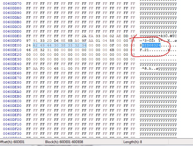

              some one can help me
              i need Da00p2mb6d1 rev-d amd BIOS
                • 20898
                Re: Da00p2mb6d0 rev-d amd
                Check your bios BID with a hex editor, if its the same as the one at post #1 you can use that.
                If you want to keep your serial number and win key you can copy it from your backup and copy it into the new bios
                with these off-sets
                DMI 0 - 1FFF
                W/K 8000 - 803F
