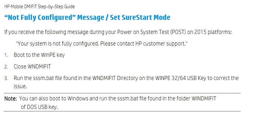

    Originally posted by SMDFlea
    "The last step is to lock the MPM back up. If you reboot now, you will lose everything that you accomplished.Run lockmpm.bat, which is also located in the WNDMIFIT folder."
    Fill everything in if its not already there in the boxes, then run lockmpm.bat
    Attached are photos with bios, all series are entered correctly. But I still have that warning message. What can it be?

      It could be this..
        It could be this..
        It finally resolved by running the sssm.bat file !! The message has disappeared. Thank you for your patience and help. Once again, thank you!
          It could be this..
          How can i run it in dos mode? wich commands must i use?
