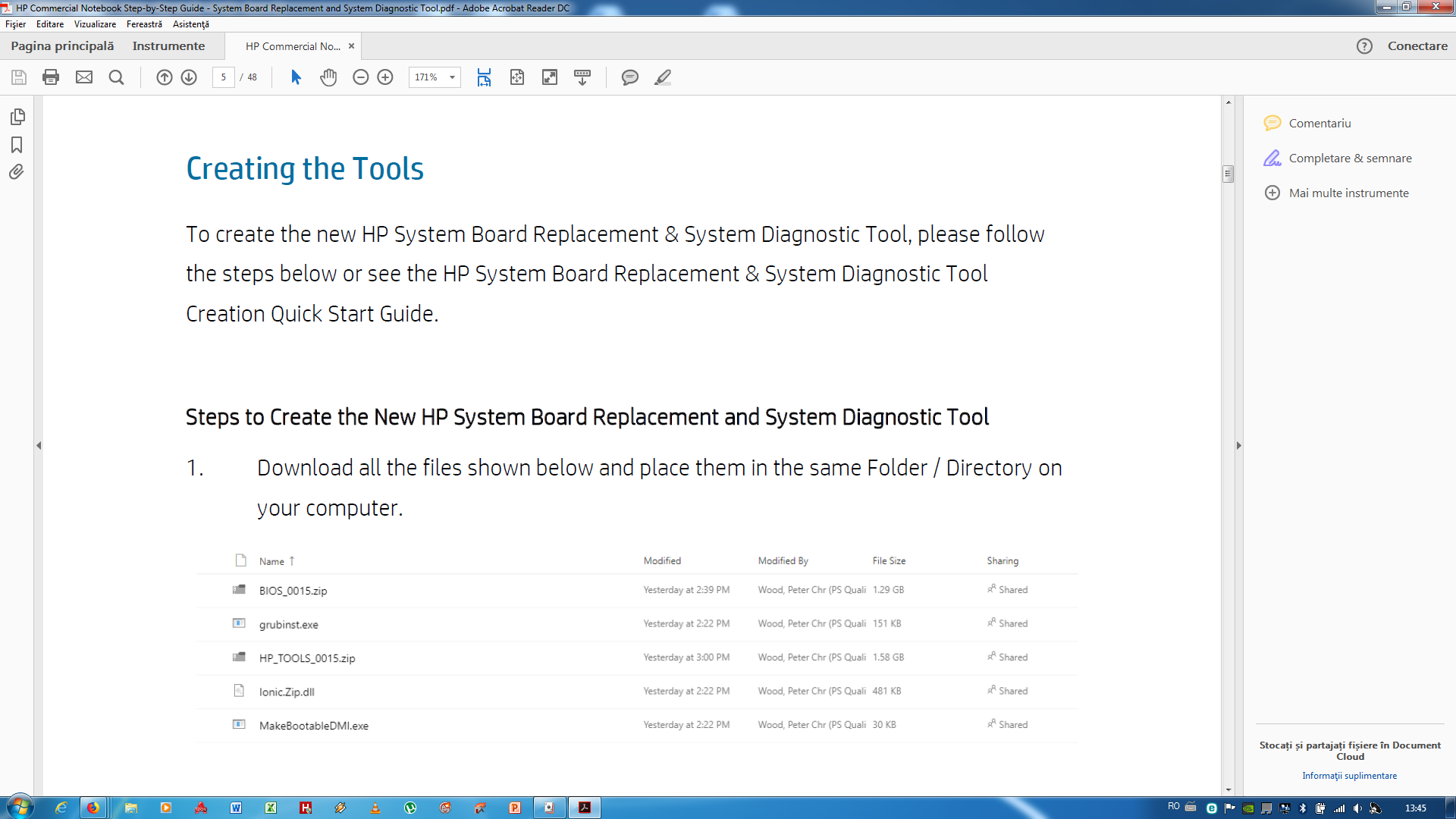

              I repeat, I can not unlock the flash descriptor with any combination of buttons. How can I otherwise do bios backup?
              Please read page 43 and 45 from this attach. What do you think? I only have NbDmiFit-2.13, I do not have the rest of the utilities (see attach 2.png) !!

                    I read it, yes you can run WNDMIFIT.Read page 45 “Not Fully Configured” Message / Set SureStart Mode

                      To do this I need all the utilities from attach 2.png. I only have the NbDmiFit-2.13 utility

                                    To unlock the MPM, copy the FSMC.bin file from the WNDMIFIT folder to a Fat32-formatted USB drive. Rename the file to SMC.bin. Plug the USB drive into the laptop with the power off. Hold Windows Key + Arrow UP Key + Arrow Down Key at the same time and power the system on. Release all keys when you see the blue HP logo. You should see a brief message on a white screen saying that the SMC command was handled successfully. This means that the MPM is unlocked, and will remain so for the next 10 power-cycles.
                                    Now you need to reset the missing information in the BIOS. To do this, boot back into Windows and run Wndmifit64.exe which is located in the WNDMIFIT folder. You should see the Notebook DMI Firmware Interface Tool appear on the screen.Fill everything in (take pictures of all the labels,in the battery compartment on the base, and under the base cover,Your error message is due to the feature byte not being set.Find that number)
                                    The last step is to lock the MPM back up. If you reboot now, you will lose everything that you accomplished.Run lockmpm.bat, which is also located in the WNDMIFIT folder.
                                    These instructions with a few slight edits (it save me typing it all) are taken from post #6 at https://www.tonymacx86.com/threads/h...art-up.129803/
